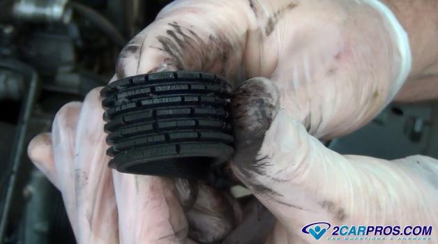

Cracked and Glazed Serpentine Belt
cracked glazed serpentine belt
A serpentine belt is used to supply engine power to the water pump, alternator, power steering pump and air conditioner compressor. When this belt starts to wear it becomes glazed and will loose its ability to grip the pulleys which can produce a chirping sound while the engine is running. This is a normal occurrence as the belt is a normal maintenance item. This chipping sound will follow the engine RPM (engine speed). Inspect the belt for glazing which is a shinny condition inside the belt grooves. To check if this the problem spray a little WD40 on the belt while the engine is running if the noise goes away the serpentine belt needs to be replaced.

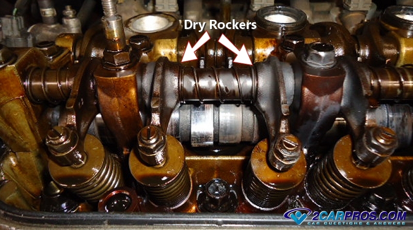

Dry Rocker Arms
dry rocker arm
The valve train of your engine is located in the top of the cylinder head. If the oil supply galleys become plugged with gunk due to poor maintenance the rocker arms can make a chirping sound as there are forced move by the camshaft. To check for this condition the valve cover must be removed and the rocker arms inspected for discolor indicating a problem. The rocker arms must be removed and the oil passages cleaned to fix the chirping noise problem.

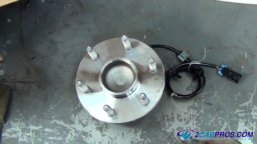

Bad Bearing Hub
new bearing hub
An axle bearing hub is designed to support the weight of the vehicle by allowing the wheels to rotate. These bearings are manufactured with high grade steel that resists wear under extreme conditions. When an axle bearing hub fails it allows metal to contact metal under high pressure with a linear motion creating a chirping noise. You can sometimes change the pitch of the noise by turning the steering wheel a little one way and than the other while driving the car to confirm the bearing hub is bad and needs replacement.

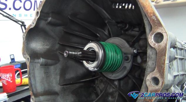

Clutch Throw Out Bearing
chirping throw out bearing
Vehicles equipped with a standard transmission utilize a clutch to act as a controllable coupler to the drive wheels. A clutch uses a throw out bearing to press against the pressure plate to disengage the clutch disc. When this bearing fails it can make a chirping noise when pressing down on the clutch pedal indicating the throw bearing needs replacement.
