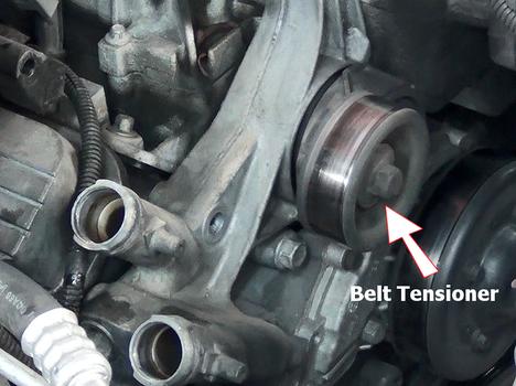

Step 1 - You may need to disconnect the battery before you start the job if electrical wiring is involved, and in some cases you will need to drain the cooling system as in the example below. Also, the serpentine belt, heater hoses and alternator have already been removed. Most cars will not have heater hoses running through the tensioner.
serpentine belt tensioner replacement

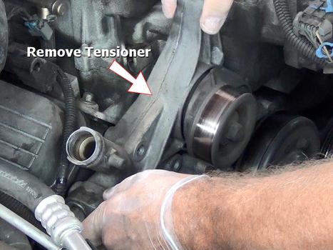

Step 2 - Locate and remove the belt tensioner mounting bolts, in this case there are two bolts which are 13mm and 15mm, most tensioners will have one to three mounting bolts.
remove bolt from tensioner
Step 3 - Here, our mechanic is removing the tensioner so it can be matched up to the new unit.
remove serpentine belt tensioner

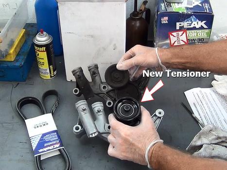

Step 4 - The old unit and new tensioner need to match identically to ensure a proper installation. You can also see we are installing a new serpentine belt which is highly recommended when doing the job.
new serpentine belt tensioner
