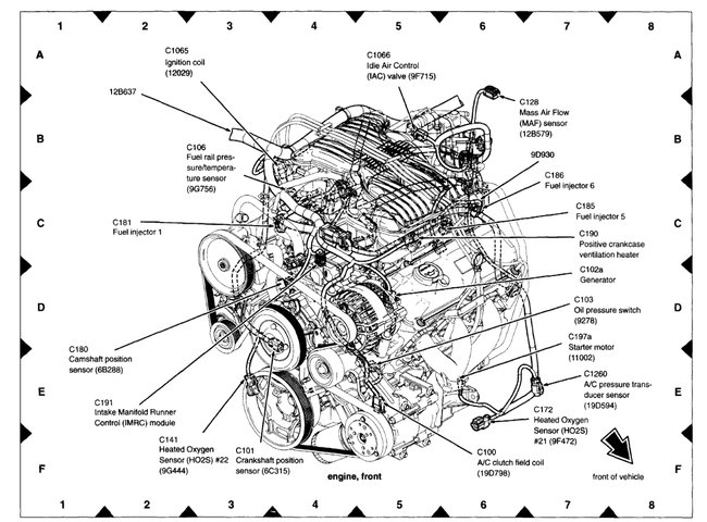

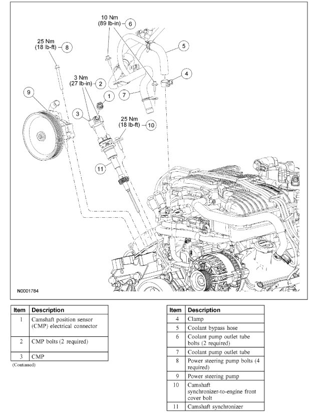

Let's replace the camshaft sensor (CMP synchronisation) which if is shorts out can cause the engine to stall. This guide will walk you through the steps with the location of the sensor featured in the diagrams below.
https://www.2carpros.com/articles/camshaft-angle-sensor-replacement
Was the alternator ever replaced? Seems there were many cases of faulty alternators causing the problem.
Check out the diagrams (Below). Please let us know what you find. We are interested to see what it is.

MEL931975
  • 7 POSTS
I got van back they replaced the starter( starter was replaced 3 months ago)... they also replaced the cam sensor and synchronizer. So far van has been starting with no noise at all..
