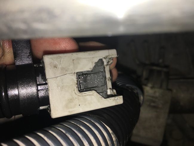

Help! What is this part called? I discovered it is cracked (and possibly the reason) my Xterra won’t crank.
Camshaft bank 1 (passenger side).
Friday, May 24th, 2019 AT 5:46 PM
Can you take a couple more pictures front and rear next?

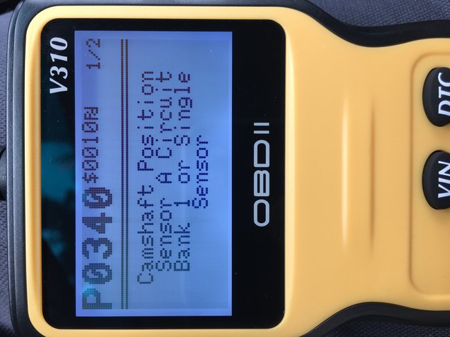

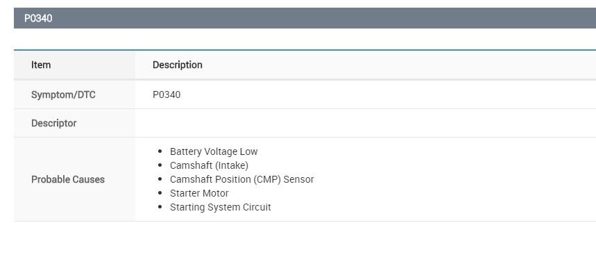

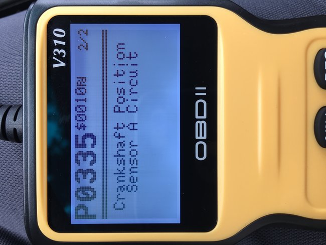

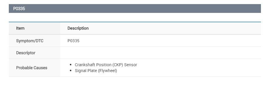

Here are the codes:
Monday, June 3rd, 2019 AT 11:54 AM
That picture looks like the cam sensor and it came apart.
The fact you have both cam and crank sensor codes tells me to have you check the timing chain. These usually set when they are not aligned when cranking.
I would do a compression test to be sure.
