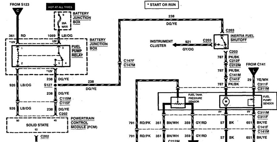

My SUV would not start because fuel pump was not coming on. Replaced fuel pump and now it will not come on. Firing but will not start. Are there reset buttons and if so where are they? I am puzzled as to why it will not pump fuel.

When you turn the key to the on position without cranking the engine over can you hear the fuel pump run in the tank for 5 seconds?

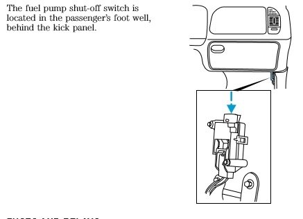

Please run down this guide and report back. Most Fords have an inertia switch, not sure if that is your problem? engine cranking, you have spark at the plugs? Any applicable trouble codes? At the top of page, vehicle repair guides, link, a lot good information.

TAMMIE HORNER
It's not showing any codes. But I checked the inertia switch. Still won't start.

Did you look at the diagram I posted? At the inertia switch, voltage on both legs, engine cranking, use a test light to check for voltage. When you first turn on the key, no crank, can you hear the fuel pump run for a couple seconds? Did you check the fuse for load side of relay? I did ask about spark at the plugs, engine cranking. I'm trying to find out if there is more than one issue?

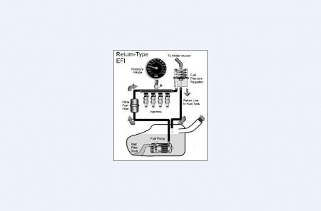

Check your fuel pressure make sure its producing the correct fuel pressure and comeback with the readings.

How do I check the fuel pressure?

  • 75,992 POSTS
See below example.
https://www.2carpros.com/forum/automotive_pictures/12900_fuel_pressure_system_circuit_7.jpg

I would agree that this sounds like a fuel issue so let's check the fuel pressure using this guide:
Then we need to check the three basic items to get the vehicle started. That is spark, fuel, and compression. Start with using some starter fluid in the intake and crank the engine. Then pull a plug and hold it against the block and crank the engine and make sure it is sparking.
