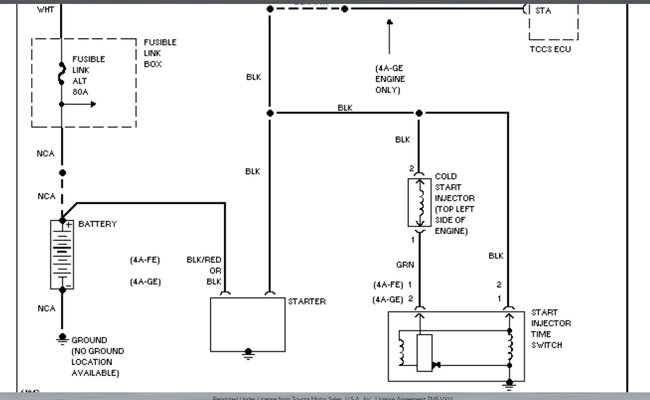

Turn the ignition and it doesn't start doesn't make any noise.

This could be a problem with your battery being dead. Could you please take a reading with a multi-meter across the battery terminals and get back to us with what it is. If you are unfamiliar with how to use a multi-meter, please, go to this link below:

The battery is not dead and the starter has been replaced.

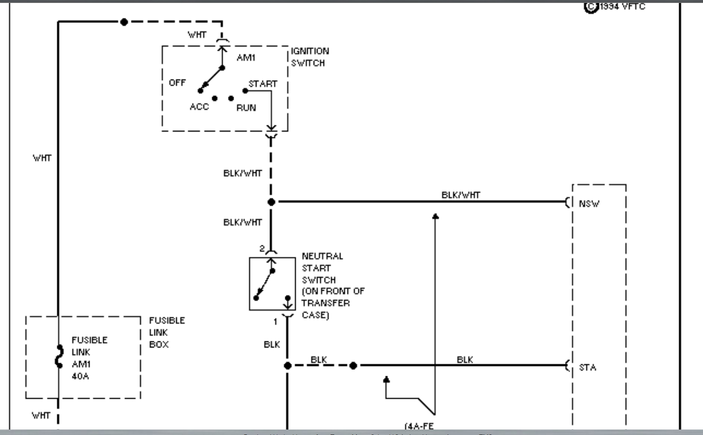

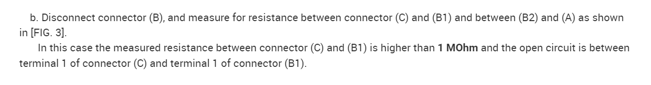

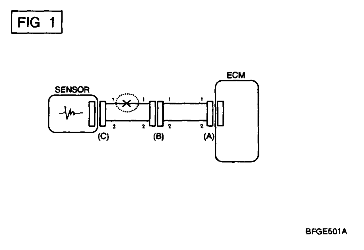

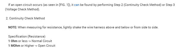

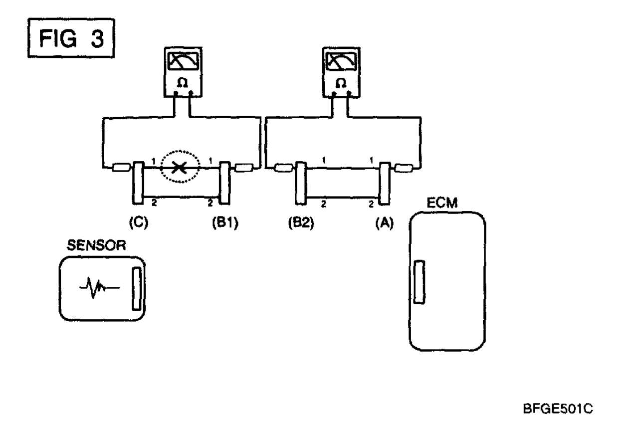

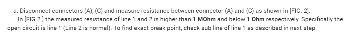

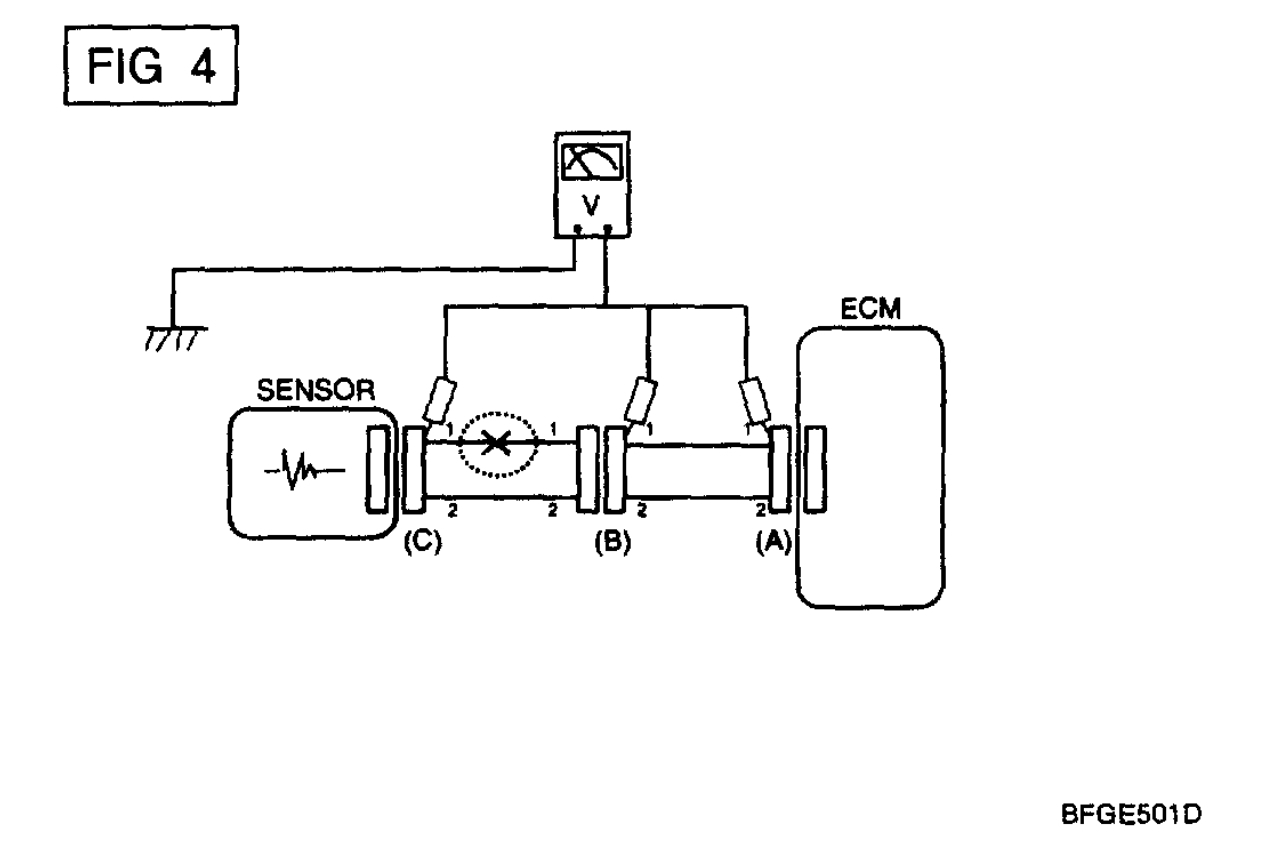

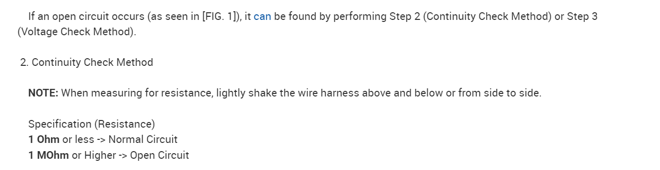

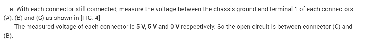

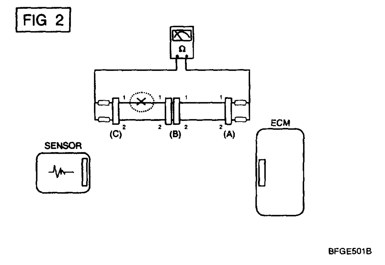

Okay, then it sounds like you have an open in your vehicle's starting circuit. In the diagrams down below I have included a wiring diagram for your vehicle's starting circuit for reference. I have also included a guide for how to find an open in a circuit for you for reference as well. Please check the two fusible links in the circuit. They should be located on your positive battery terminal and get back to us with what you are able to find out.
