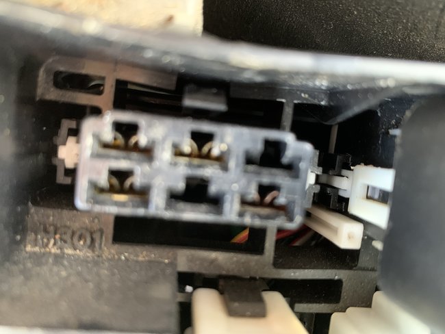

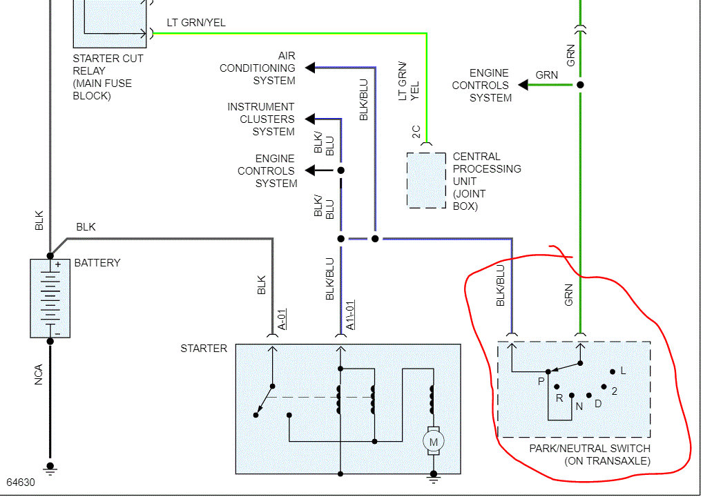

It could be a few things. First, see if it starts if you place it in neutral. The park/neutral switch may have failed. See attached picture.
Try that and let me know what you find.

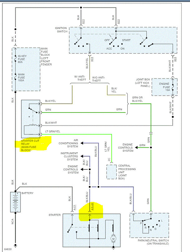

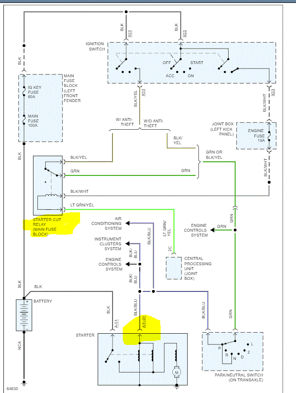

Okay, have you checked the starter cut relay? I attached a picture of the entire starting system wiring schematic. Check the relay and fuses (which should be good). If the relay is good, power goes from it, through the neutral safety switch and then to the smaller blue wire on the starter.
What I would suggest is to remove and inspect the starter cut relay. If it's good, get a helper to turn the key to the start position while you check for 12v at the smaller blue wire on the starter. If there is no power, move back to the neutral switch where the blue wire comes from and check there. I suspect we may have to work backwards to see if we can locate the loss of power.
If there is a relay with the same part number, switch them. If there isn't, here is a link that explains how to test a relay:

The starter cut relay is gone completely. They have a straight wire inserted into two of the 4 connections. When I touch one of the wires to the pin beside it, it bumps the starter but just a little bit. I have order a new relay switch. Should this fix it? My son has already installed a new starter but I don’t know if he might have done something wrong.

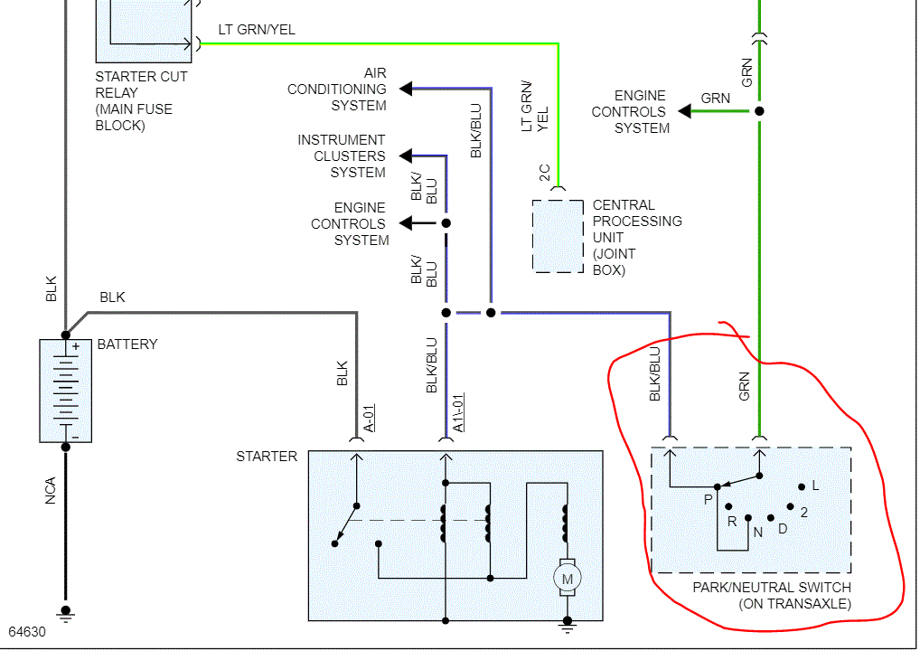

When checking power at the starter, is it the smaller wire you checked? Also, I read back through everything and noted you mentioned starting it in neutral. Are you sure the neutral safety switch isn't bad? Are you able to get it into park now?
See if this link helps in any way:
Next, can you turn the engine by hand (with a breaker bar on the crank pulley bolt)? I ask because if you have power, a new starter, and only get a click, could the engine be locked?
If you can turn it, check to make sure the ground between the battery and engine block is clean, tight, and not corroded.

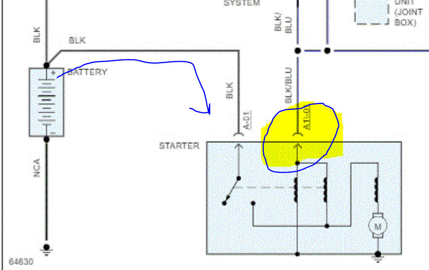

Yes, the smaller wire will only have power when the key is actually in the start position, so you will need a helper.
If you look at the attached pic, the heavier gauge wire comes straight from the battery, so it will always have power. The smaller one only gets power with the key in the start position.
