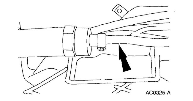

With the engine off the truck will shift into each gear. When started with the clutch depressed and already in gear, the truck lurches as if the clutch pedal is not working. When viewed from underneath through the small view-port in the bell housing I can see the throw out bearing being moved forward but not how far.

This sounds like either the throwout bearing is not being pushed far enough or the clutch itself is no good.
I would suggest replacing the master and slave cylinder. They are external and could be the entire issue.
Raise the vehicle on a hoist.
ImageOpen In New TabZoom/Print
2. Remove the hydraulic line from the slave cylinder.
3. Remove the slave cylinder.

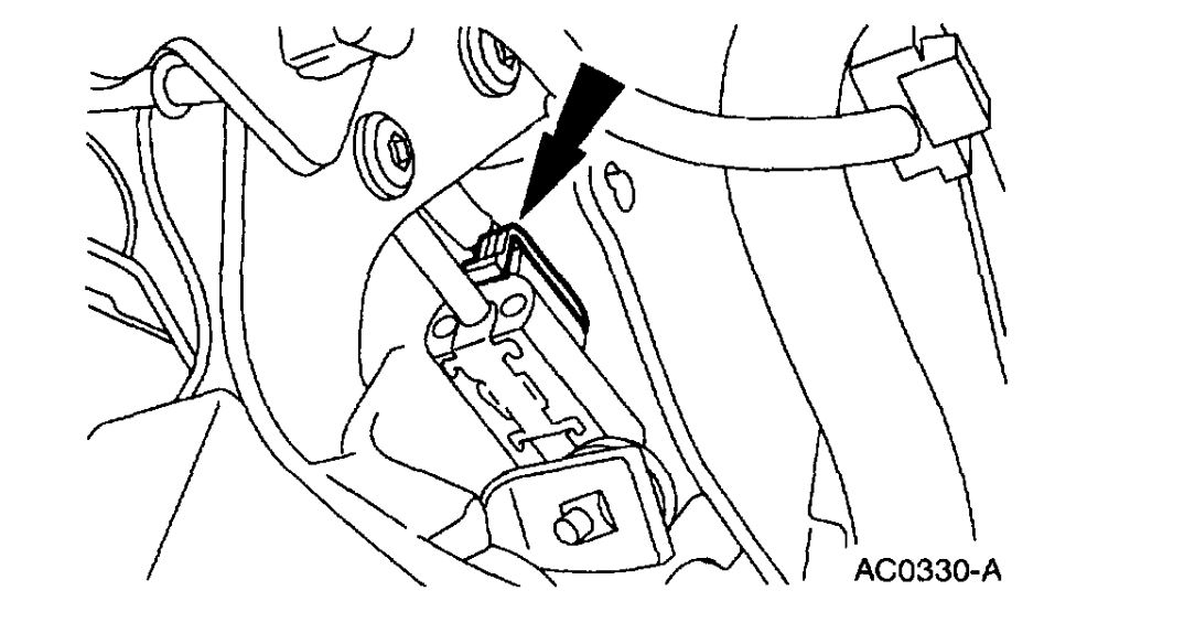

1. Disconnect the clutch master cylinder push rod from the clutch and brake pedal pivot shaft lever.

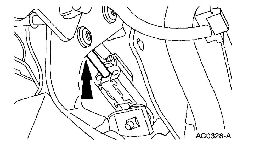

2. Disconnect the Clutch Pedal Position Switch (CPP).

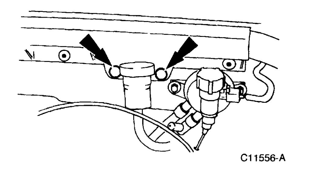

3. Remove the pushpins.
4. WARNING: The electrical power to the air suspension system must be shut off prior to hoisting, jacking, or towing an air suspension vehicle. This can be accomplished by turning off the R.H. Kick panel area. Failure to inflation of deflation of the air springs which may result in shifting of the vehicle during these operations.
Raise and support the vehicle.

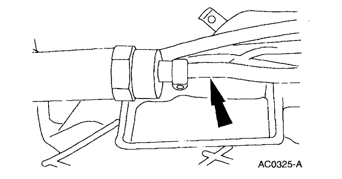

5. Disconnect the clutch hydraulic line from the slave cylinder.

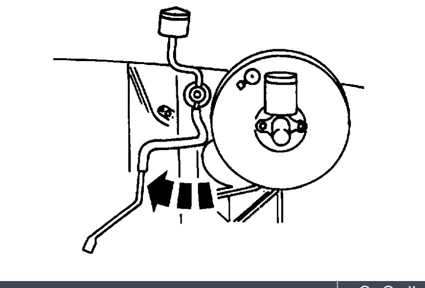

6. Lower the vehicle.
7. Remove the clutch master cylinder reservoir and clutch master cylinder.
- Rotate the clutch master cylinder 45 degrees clockwise.
