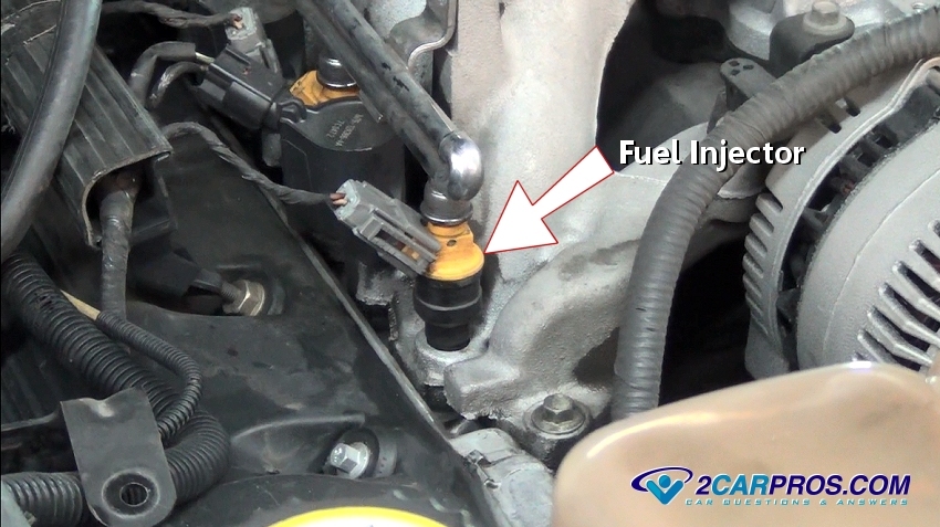

Step 3 - If a fuel injector short circuits it can cause the engine to stall. If the engine is not running code gathering will be incomplete, which presents a P1000 code. Learn More

Step 4 - Once the faulty sensor or injector has been found, clear the codes to recheck the system. Learn more
