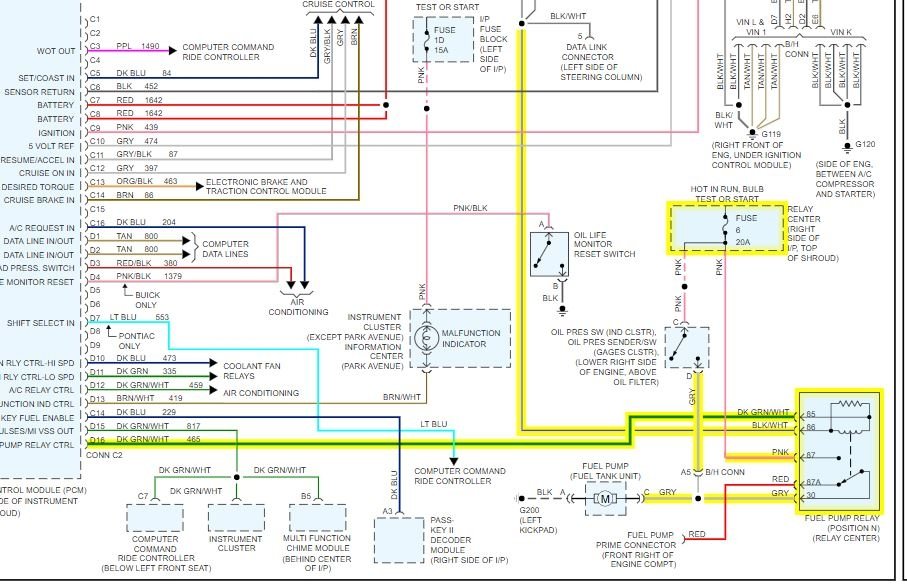

CHARLES STEELE
  • 37 POSTS
  • 1995 BUICK LESABRE
  • 3.8L
  • V6
  • 2WD
  • 78,000 MILES
Pump does not run. Had an over the dirt bank and bounced a couple of time now no fuel. Does this have a impact shut off sensor and if so where? I cannot see one by the center of dash on floor like usual.
Tuesday, August 4th, 2020 AT 4:21 PM (Merged)
  • 52,797 POSTS
Good afternoon,
No, the only car with an inertia switch is Ford products.
Did you look under the car at the tank and check for damage? You may have damaged the tank where the fuel pump sits.
Can you check the connector for power to the fuel pump?
Check the grey wire in the connector at the tank.
+1
CHARLES STEELE
  • 37 POSTS
No damage to tank wires and hoses all good. Can't check connector right now need to get car up in air at my age I can no longer crawl under it.
