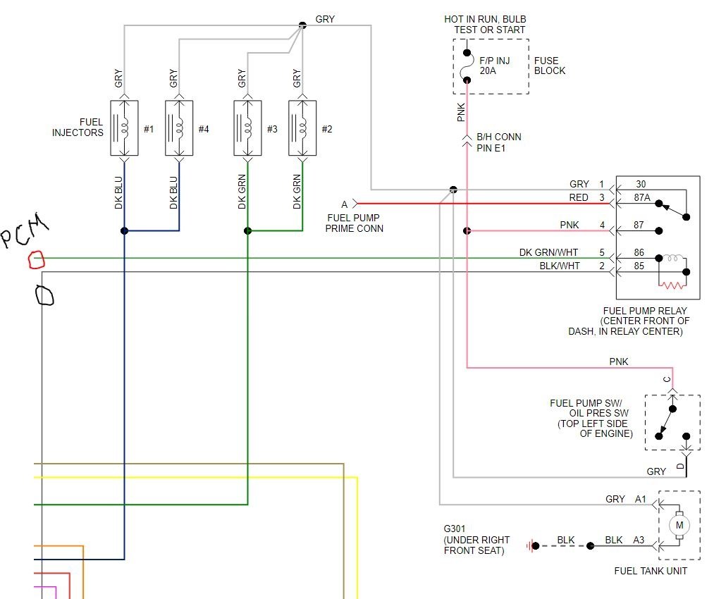

I conducted a continuity test to check my PCM connections, The gray wire leading to both (Fuel Pump Relay) and (Fuel Pump Control Switch/Engine Oil Pressure Switch) and which is coded as number 120 in the attached schematic diagram proved positive with two pin in the pink connector shown in the second attachment, none of them is gray as you can see. Is this normal?

Looking at the diagram there won't be a gray the power feed between the injectors, the pump and the oil pressure switch. It is in the harness between those parts. The two wires that will be in the PCM harness related to the fuel system are going to be the ground wire (black wire white stripe) and the relay control wire (dark green with white stripe) The ground is a shared ground with multiple items on it. The control wire is switched on by the PCM and it turns on the power to the fuel pump and injectors. That power then comes from the fuel pump injector fuse on the pink wire through the relay during pump prime and through the oil pressure switch once the engine is running.

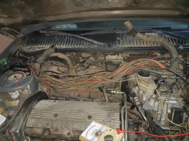

I went far somehow in trying to diagnose the problem:
1. Just this afternoon I took the passenger seat off and tried to see if the black -ve wire for the FP is loose there, all I saw was some sleeve housing 3 wires( thick gray, black and green. They were going towards the cradle that includes the PRNDL lever spacing the 2 front seats apart. I took the trouble to do that because every time my wife be escorted by me, the car would be giving us a hell of stubborn cranking with no start and even as it stars after several cranking it just stalls soon. Once I drop my wife to her gym it is as if a Genie was there and got out of the bottle! Finding nothing suspicious, I secured the seat two hours ago.
2. The engine would stall when the car is stationary, moving slowly, moving at some 120 km/hr, there is no specific pattern but I mentioned the u-turn thing because that is the worst moment of all, it happened some 8-10 times so far versus some 100+ times while driving straight. 3 technicians tried a hell of tricks and jumpering this wire to that of a neighboring relay (those 4 relays), it would succeed for an hour or two but then all of a sudden it gets back to the irksome stalling.

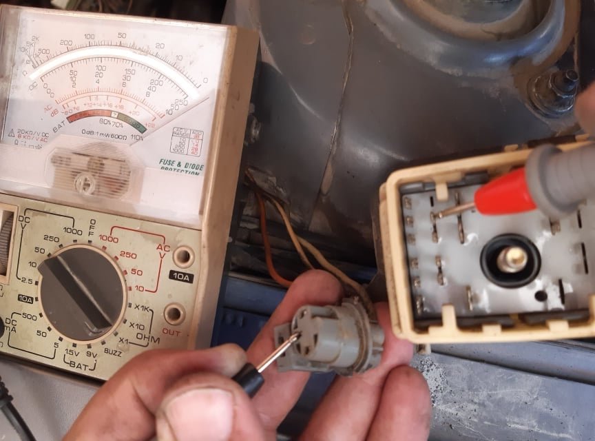

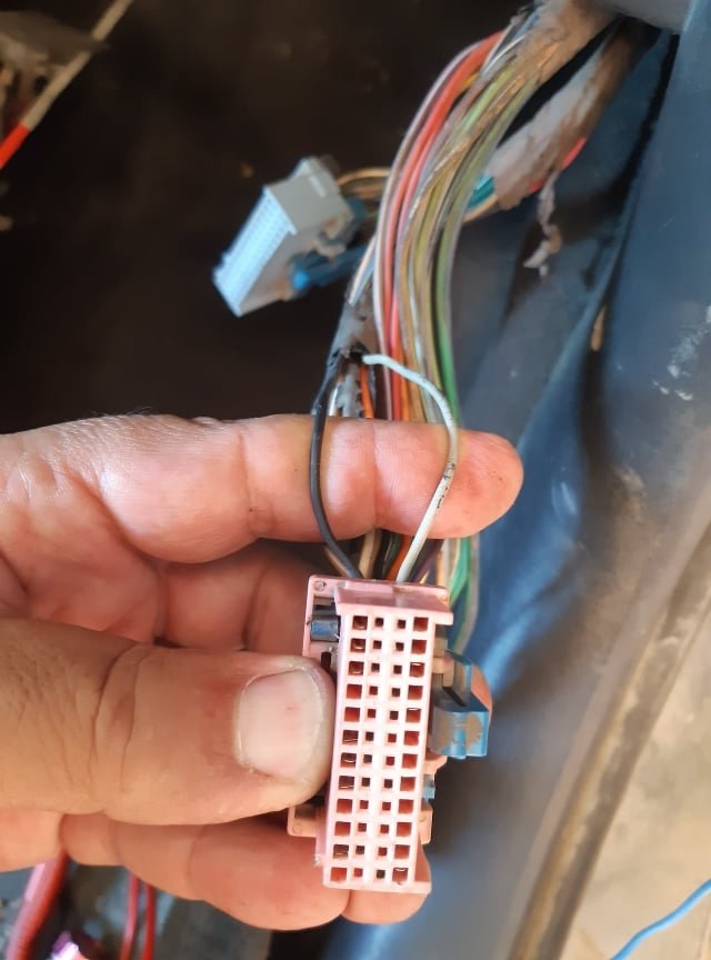

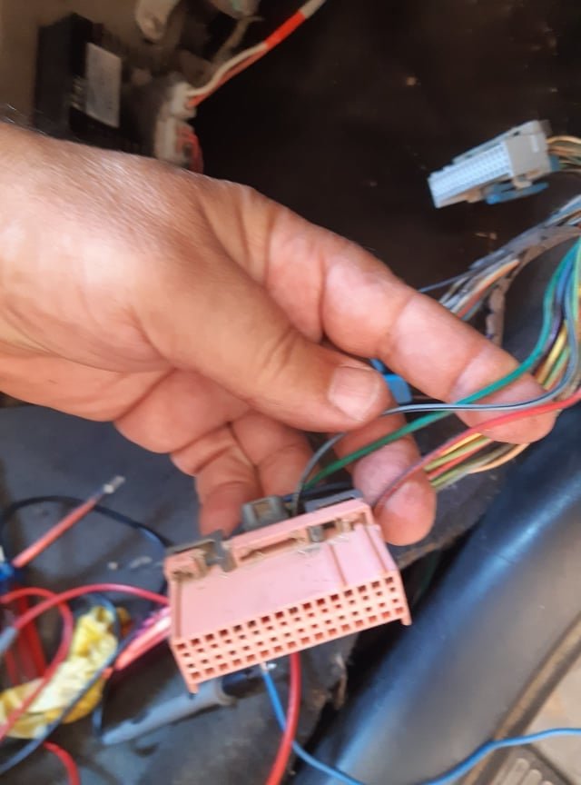

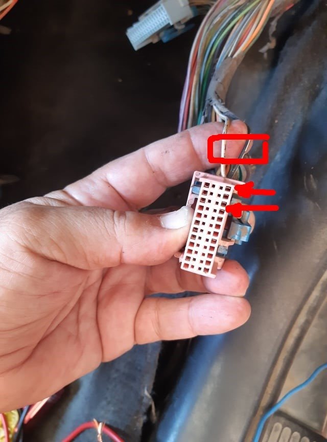

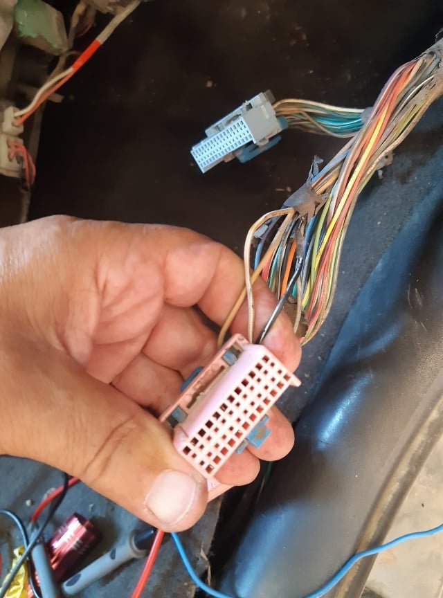

Another try: Continuity test proved positive for the Grey wire ( No. 120) with all these pins in the 12-pin pink connector of the PCM: Black/white - Tan/white and tan. At the same time of the test, continuity was positive for the following pins in the neighboring 16-pin pink connector of PCM: Blue- black stripes - green and red striped with either black or dark blue.

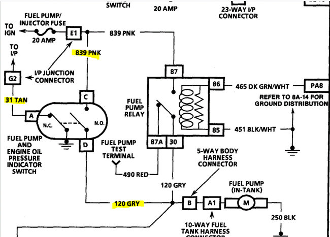

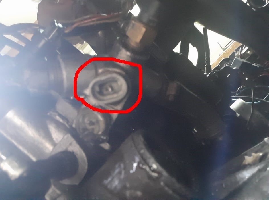

The schematic you marked for the PCM two wires (attached here once again) shows a 2-pin connector for the Oil Pressure switch/Fuel Pump switch but my engine has a 3-pin connector (1st image attached here).

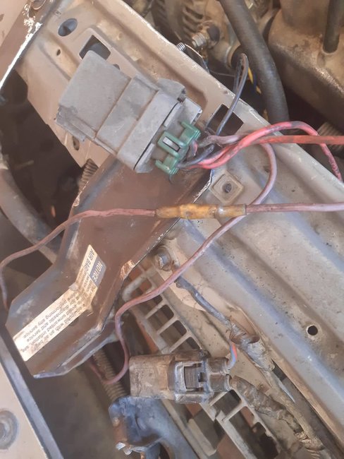

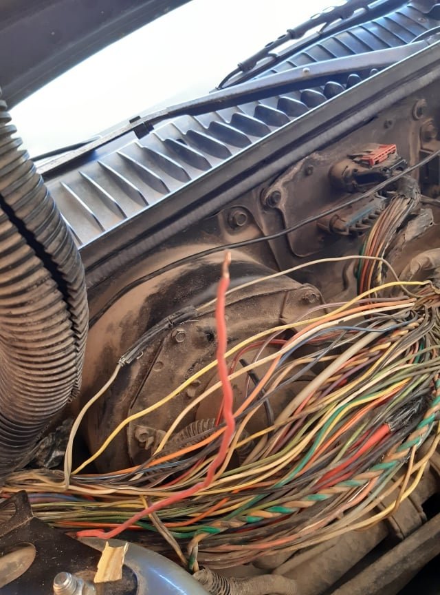

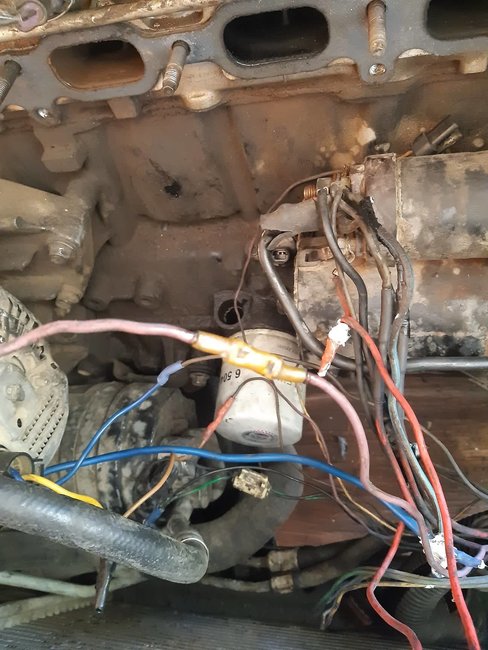

A yet other check: Continuity proved positive between a dark purple wire ( within the main harness in engine compartment) and both two pins in the 12-pins pink connector of the PCM: Black and gray (2nd image attached here).
Is it normal that one wire in the engine compartment corresponds to 2 or 3 wires that all have no color like that in the compartment?

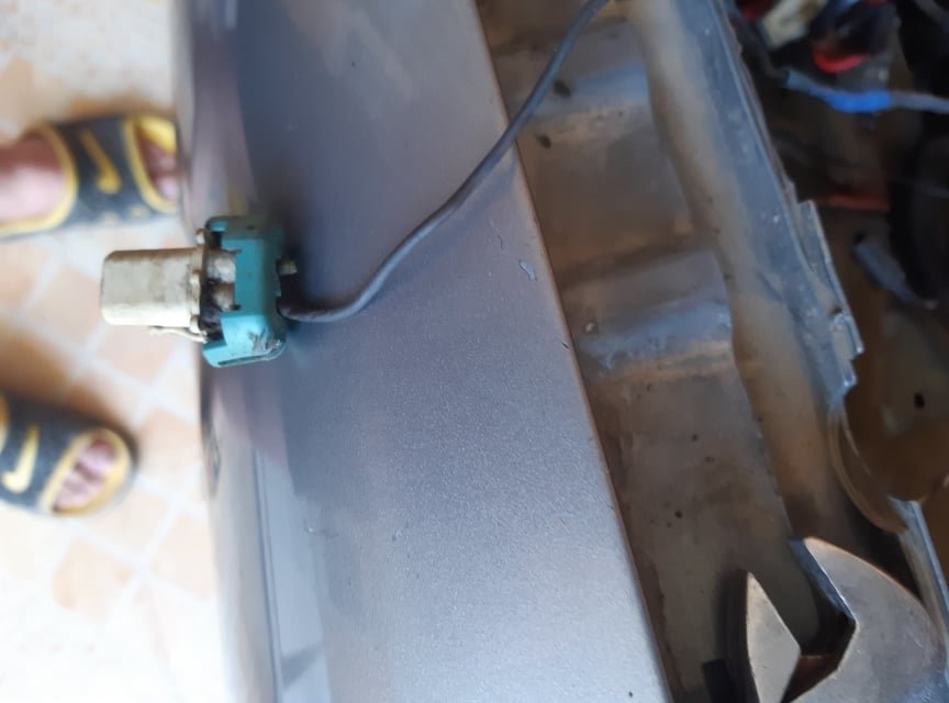

The 4th attachment is for the 3-pin/wire connector of the Oil Pressure switch/Feed Pump switch (tan - gray and pink). This connector used to cause problems to my engine, I replaced it and it was one of the steps that made the engine recover before diving once again into malfunctioning and stalling.

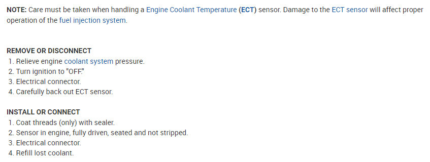

Additionally dear Steve, I have this important notice here regarding the interaction of (Injection and Coolant Temp Sensor - 1st attachment). My problem might be due to this.
I also believe that there is something wrong with my Coolant Temp Sensor, most probably its wires might need checking same as we did with the Oxygen Sensor wires to PCM. I lately checked another QUAD 4 engine left on the floor in one spare parts garage, there I found that the sensor (that I could never view in my car since it faces the windshield and there is no space to have a look) has a single wire, a green one, the pin is central to the sender unit body, the early connector ( shown here- 2nd attachment). So I have to attach the loose green wire to the pin using a piece of wire attached to the sender unit pin, screwing the sender unit in its place and then attaching the piece of wire to the mother green wire. This is a pale pic of the single centralized pin of the sender unit, I used the mobile but it came blurry.

Having an issue with someone in the seat sounds like a bad ground issue or harness problem. However it may not be under the seat but up under the dash, have her sit in the car and see where her feet touch just to rule out that being an issue. It's also possible that her weight in the vehicle moves the suspension enough that a loose connection in the harness shows up. Long crank times usually indicate a loss of the fuel pump relay signal. The system is somewhat simple in operation. You turn the key and the PCM activates the FP relay for about 2 seconds. This primes the fuel system to bring the pressure up so the injectors will operate. Now you crank the engine and as soon as it starts cranking the oil pressure rises and turns the FP circuit in the switch on, this turns the pump on and the engine runs. The idea behind this is that you don't want the engine to run if it has no oil pressure so it acts as a safety system. However a loss of power or ground to the pump can act the same way. It's even possible that it's a stranger issue where the fuel in the tank is moving around and causing the wiring in the tank itself to move. Not sure of a way to test for that which doesn't involve removing the tank to get at the wiring. You could jumper power directly to the pump and see if anything changed.
The problem with testing continuity is that unless the problem is actually happening at the time it likely won't show up as you test. With no real pattern that is going to be the hard part to deal with. If you had access to a multichannel oscilloscope you could connect it to the various circuits and watch to see which dropped out but that isn't something most DIY (or even many shops) have access to. That was why I suggest using small lights that you can connect to the ignition and fuel power and watch to see if they go off when the problem happens.
The schematic doesn't show the third wire for the oil pressure sender because it only covers the wiring that is used to control the powertrain. The third wire from the oil pressure sensor goes to either a light or a gauge in the dash. As an indicator only it doesn't control anything so it isn't shown. If I posted the instrument wiring it would show the two wires for that system but lack the third one. Just the way the schematics are written.

I conducted those continuity tests just for the intention of knowing where to attach the 4 loose wires that I have, they became anonymous and loose after my transmission was repaired, we have a hell of stupid and careless mechanics here in Mosul! Also, I would have used an oscilloscope but I am a mechanical engineer who happens to dislike electricity ever since I was in college (31 -35 years ago!), So those pilot lamps serve me right, I viewed some arrangement that I forgot its name, a clip with a light and it is to be attached to each nozzle clip, we don't have them here in Iraq, quite typical! The attached images (first 2 ) shows how that harness became after me taking off the sleeve to check for a shorted wire or cut off may be, I managed to locate 3 cut-off wires, the final 2 shots are for the dashboard taken off for the same reason. Needless to say, your site's help with schematic diagrams helped me a lot and I would have restricted my search for the coded colors only rather than having an exploded view layout like this. As for the fuel pump, I started my attempts with taking the tank down and checking the whole system from start to end including that check valve on top of the engine, nozzles too. My mechanic made additional openings (10 mm dia approximately) in the lower part of the plastic assembly that houses the fuel pump, said it helps the fuel pump to work freely in case the filter there is clogged (which happens a lot).

The relay isn't on all the time, the relay only turns on during prime, the oil pressure switch then takes over. If you jump the oil pressure terminals you will have the pump on full time. If you leave them open the engine will act like the immobilizer is on and only start and run a couple seconds then shut off because of no fuel. Grounding the black wire to the chassis is fine as that is where it normally grounds, you might want to add an additional ground from the battery negative to the body as well. I have seen times that the body ground failed and caused the pump to be intermittent. That could even be the issue you have where it drops out then reconnects.

The oil pumps are pretty solid. The main reason they use them for the fuel switch is because of accidents. The idea is that if you get in an accident and the key is on, if the relay was the only thing controlling the fuel it could pump out the entire tank through a broken line because who inside the car is going to think of turning off the key. However the failed pressure switch also acts to preserve the engine, if the switch fails and dumps the oil out, the pump shuts off and all flow stops and the engine doesn't come apart from oil starvation.
