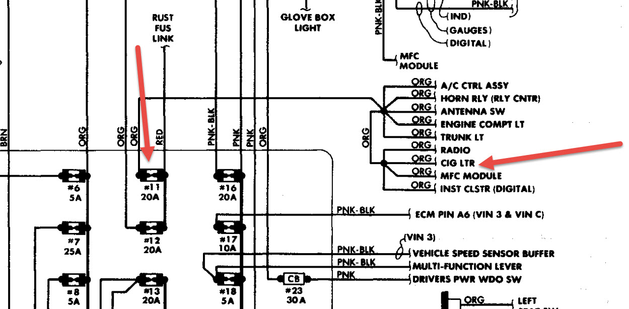

Wires were riped out by girl. Does not work. Trying to rewire to work. Thank you.

It will be an orange wire under dash which leads to several things. Arrow shows where as well as to what fuse it goes to.
Image (Click to make bigger)
