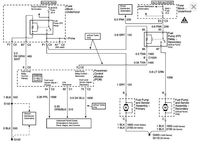

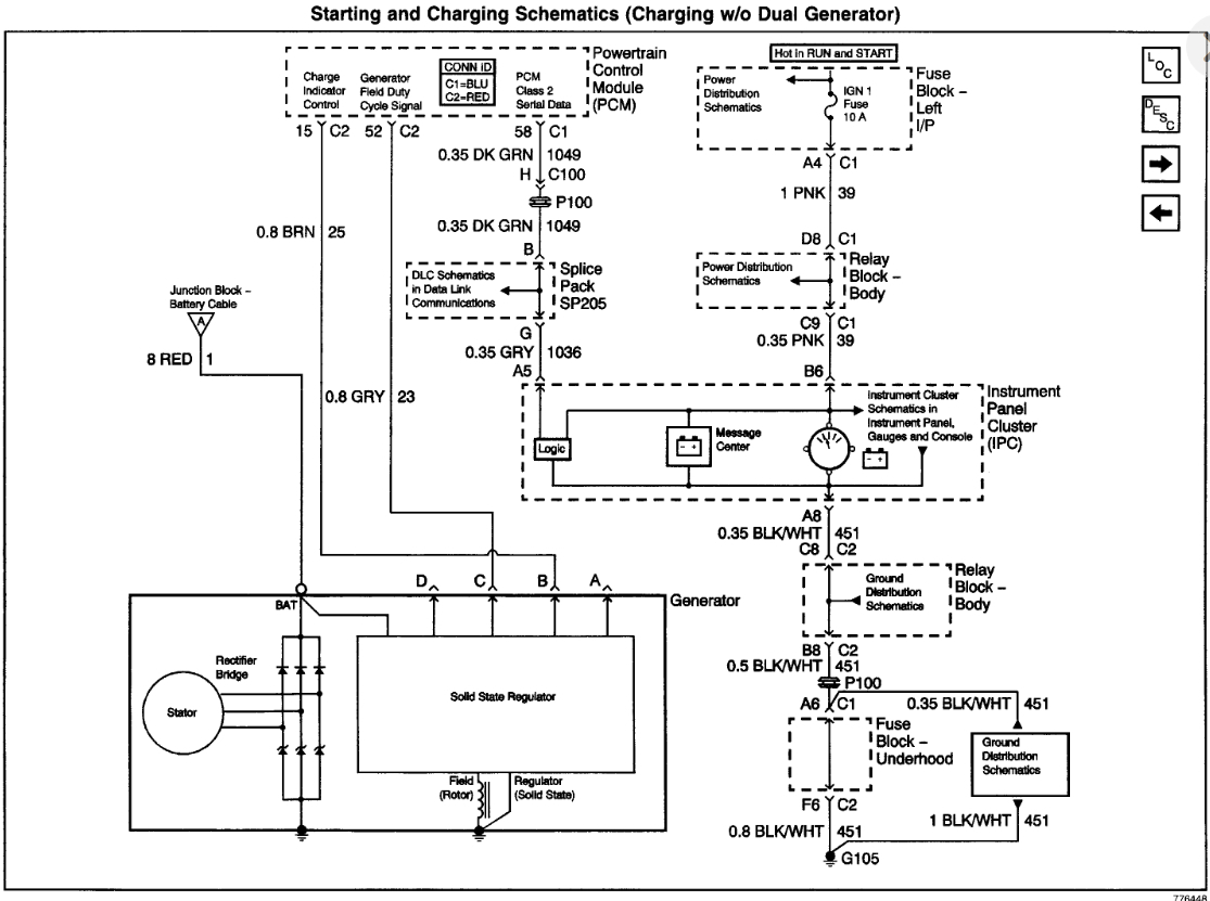

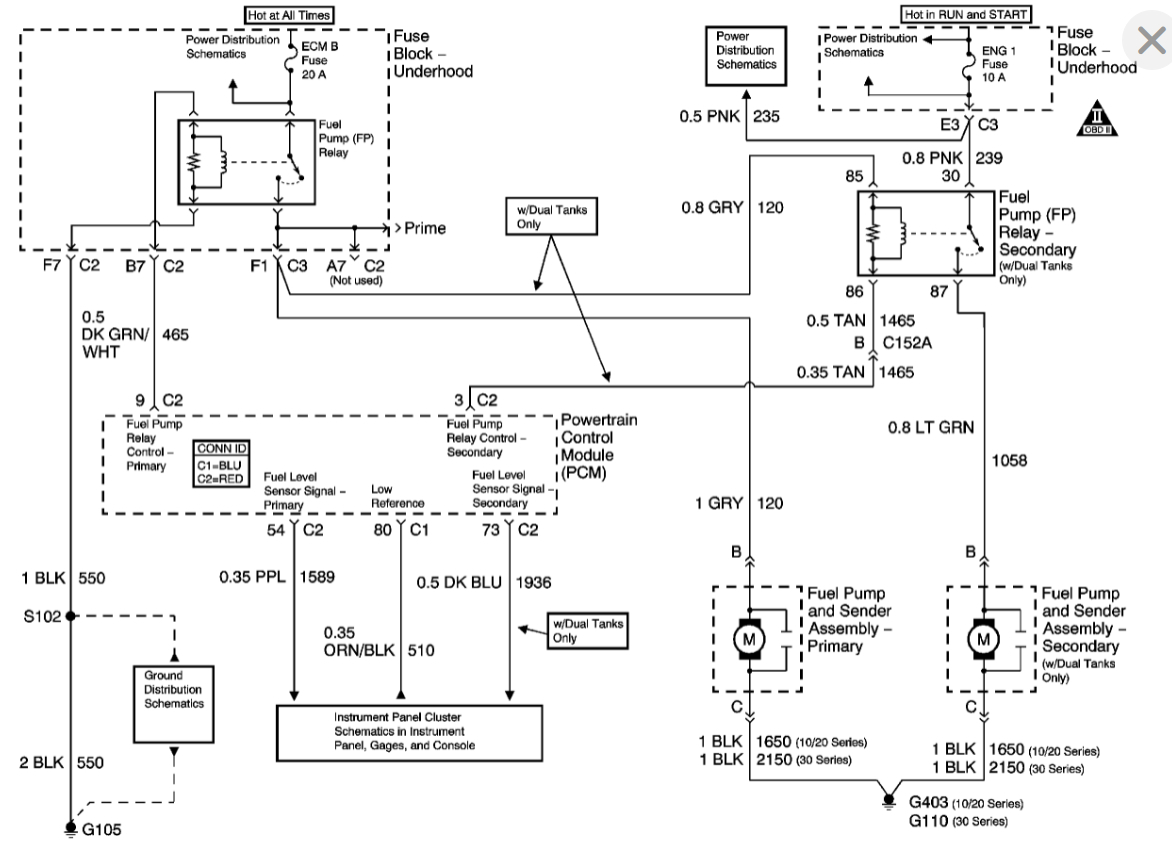

I would like to have the load circuit diagram that includes the fuel pump switch and wiring diagram for the truck listed above.

See attached for the wiring schematics for charging system and fuel pump.
