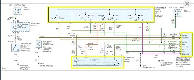

This is an old beat-up D250 farm truck, so I don't want to do anything other than mount a 3 way switch to run the wipers on low & high. Wiper motor works when power is put to it, and I have checked for bad fuses/relays, etc. There is a plastic relay of some kind I removed from the wiper motor.

I have attached a wiring diagram for your understanding of the circuit.
https://www.2carpros.com/forum/automotive_pictures/192750_WiperMotor86DodgeCabD250_1.jpg
https://www.2carpros.com/forum/automotive_pictures/192750_WiperMotorDia86DodgeCabD250_1.jpg
The relay that you have removed should be the intermittent relay.
What is the problem with the wiper functions?
Did you test if there is power supply from the switch when wiper is operated?

It is possible to rewire as you suggested without the intermittent mode but it will not stop in the parked position automatically. This is controlled by the intermittent mode. I need to know more to understand what the problem might be and then only would I be able to tell if rewiring is going to work.
Were you able to inpect the relay components?
When you applied direct voltage, was the wiper speed fast or slow? Whch terminal did you apply the voltage? Refer to identification in diagram.

We couldn't run the hot wire while the motor was installed because of lack of access. We jumped a hot wire from the pin labeled P1 to the one labeled H in the diagram you put up. It operated, but we couldn't tell whether it was "high" or "low". We stopped at that point, and didn't try any other combinations. Should we have?

The relay is an "A" relay meaning if powered it would contact and have continuity between 2 terminals and when not powered, it would have continuity between another 2 points. You should check for continuity.

The problem described and test results provided rules out power supply fault. However the diagram shows that the high and low speed should be working even if the relay is faulty. Only fault would be the intermittent speed and return to park.
It looks more likely to be a fault with the motor or the circuit plate for power supply to the armature. It could be working and after sometime when the contact heats up, the motor won't work when continuity fails. The melted plastic is proof of the overheating. Another problerm could be the wiper linkages that are stilff and it is causing the motor to heat up and stop after some time.
If power is available, then a 3 way switch is not going to be any help. You need to modify the wires to bypass the relay. However if the motor is at fault, this modification would not work as well. You might have to look for a replacement motor assy. If the part is not available, modification with another make or model might be the only option. With direct power supply, run the motor for a longer period to rule out the motor faiult before doing any rewiring.
