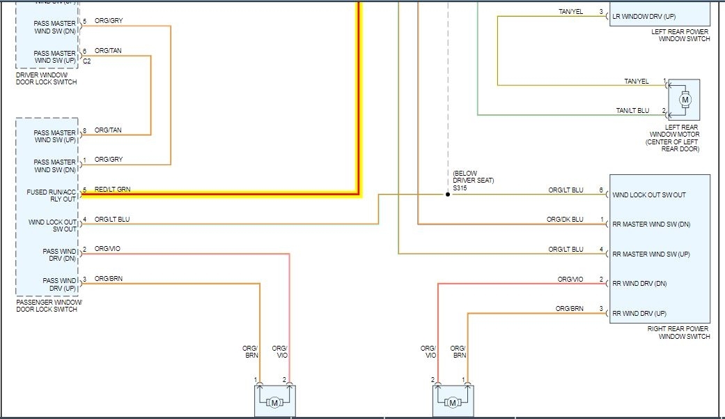

All of my electric windows have stopped working.
Friday, January 22nd, 2021 AT 4:14 AM
MECHANIC
52,796 POSTS
Good morning,

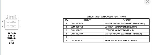

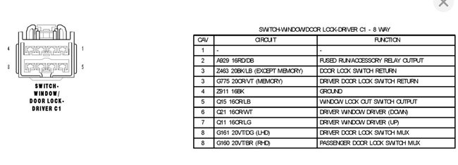

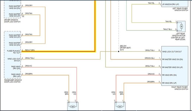

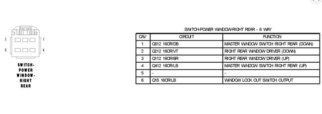

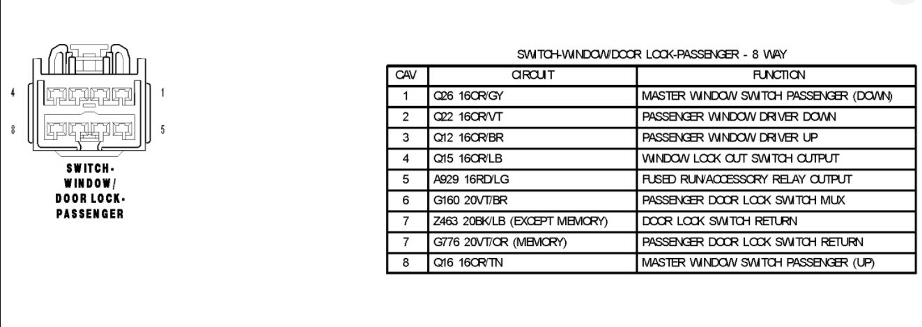

I attached a wiring diagram of the window circuit for you. We will need to do some testing to be sure you have power to the switches and the motor.
https://www.2carpros.com/articles/electric-window-repair
