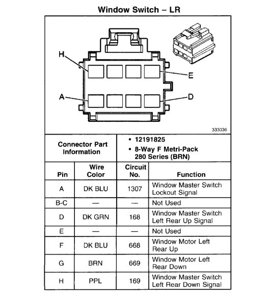

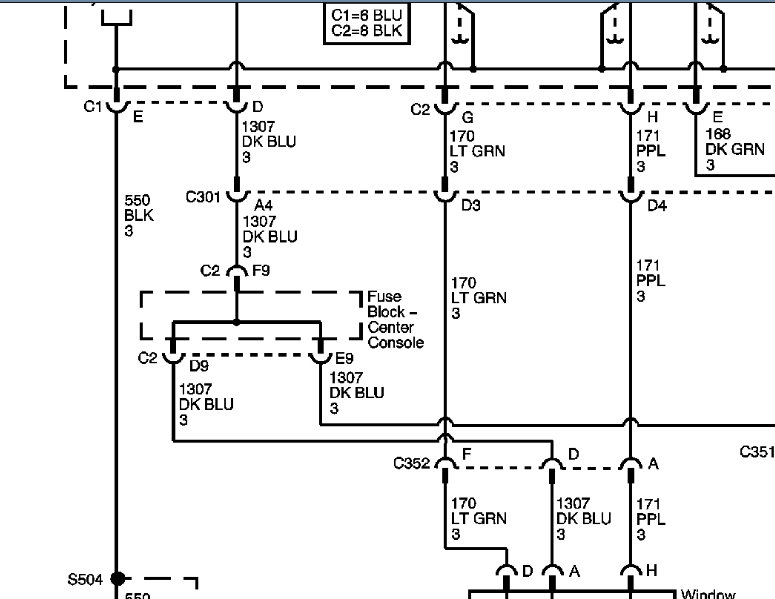

The brown wire goes all the way back to the master switch. Do a continuity test on the brown wire from the switch to the master switch.
Thursday, March 15th, 2018 AT 1:09 PM
DREV0012
  • 36 POSTS
Does the brown wire not just go between the rear door switch and the motor?
Thursday, March 15th, 2018 AT 1:32 PM
  • 52,797 POSTS
Nope, look on the diagram I sent you way back. When it is activated follow the path. It goes back to the master switch.
Thursday, March 15th, 2018 AT 1:43 PM
DREV0012
  • 36 POSTS
Maybe I am missing something. It looks like the brown wire from the passenger rear window motor connects to the switch on that door, which then switches between dark blue and purple. I only see three wires entering the passenger rear switch (light green, dark blue, purple).
Thursday, March 15th, 2018 AT 1:55 PM
  • 52,797 POSTS
I am sorry, the brown wire changes to the purple wire which goes back to the master switch.
Thursday, March 15th, 2018 AT 2:01 PM
DREV0012
  • 36 POSTS
Here is what I found regarding continuity from the master switch:
Dark green
--Connects to dark blue (to motor).
--Connects to light green.
Purple 1
Light green
Purple 2
Neither purple wire connected to the purple wire at the local switch.
Thursday, March 15th, 2018 AT 2:14 PM

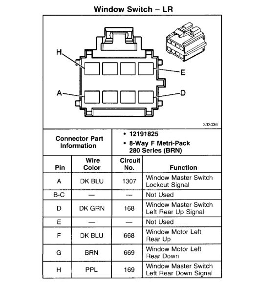

  • 52,797 POSTS
Pin 11 is the location at the master. Check for continuity from there to the switch at the door.
+1
Thursday, March 15th, 2018 AT 2:26 PM
DREV0012
  • 36 POSTS
Can you tell me which is pin 11? I do not see any labeling other than letters on the master switch?
Thursday, March 15th, 2018 AT 2:31 PM
  • 52,797 POSTS
Pin H in the master.
+1
Thursday, March 15th, 2018 AT 2:41 PM
DREV0012
  • 36 POSTS
With both of the switches connected to the harnesses, Pin H tests positive for continuity with the dark blue and the light green. When the switches are removed, it does not have any continuity.
Thursday, March 15th, 2018 AT 2:53 PM
  • 52,797 POSTS
Do the tests with the connector not connected. Then test continuity.
+1
Thursday, March 15th, 2018 AT 3:23 PM
DREV0012
  • 36 POSTS
I tested without switches connected on either end and Pin H does not yield any continuity with any wire at the rear door.
+1
Thursday, March 15th, 2018 AT 3:51 PM
  • 52,797 POSTS
Okay, then at least you know the failure. Now you have to find the break in the wire.
+1
Thursday, March 15th, 2018 AT 4:03 PM
DREV0012
  • 36 POSTS
I will start pulling the sheathing off and check the boots on the doors and see if I can locate it. Any tips on that before I dig in?
Thank you so much for the help.
+1
Thursday, March 15th, 2018 AT 4:08 PM
  • 52,797 POSTS
Look close to the switches. Look where the wires go through the door to the body.
+1
Thursday, March 15th, 2018 AT 4:16 PM
DREV0012
  • 36 POSTS
In the meanwhile, is there a place where I could jumper that connection so I can get my window shut?
Thursday, March 15th, 2018 AT 4:43 PM
  • 52,797 POSTS
When you command the window up, the brown wire needs to be grounded. Then the window will go up.
