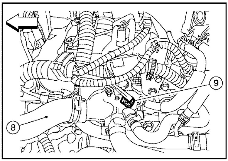

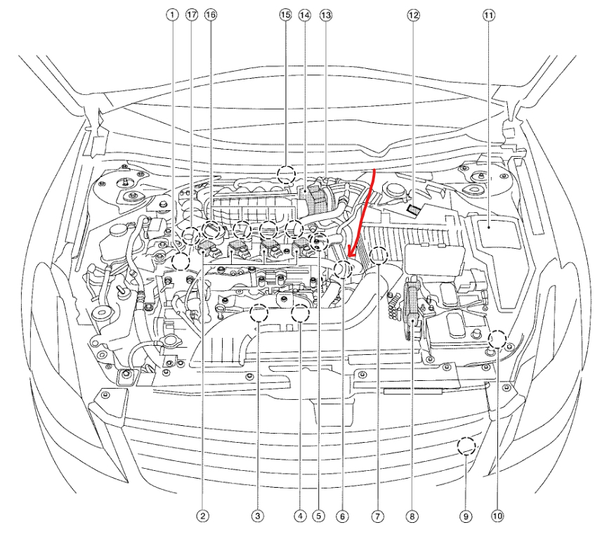

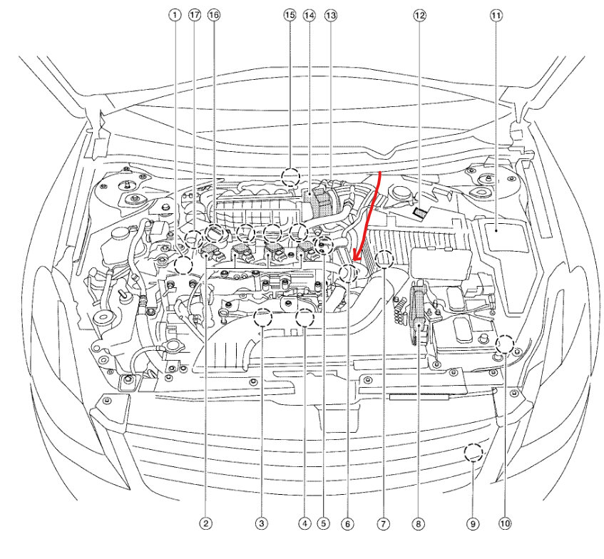

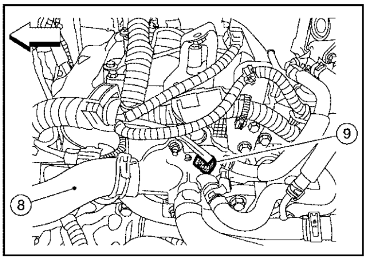

I have seen engine coolant sensors heat soak and short out to cause this issue, to be sure let's disconnect the sensor when it won't start to see if anything changes. Here is the location. Check out the images (below). Please let us know what happens.
Friday, March 29th, 2024 AT 9:15 AM
