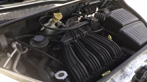

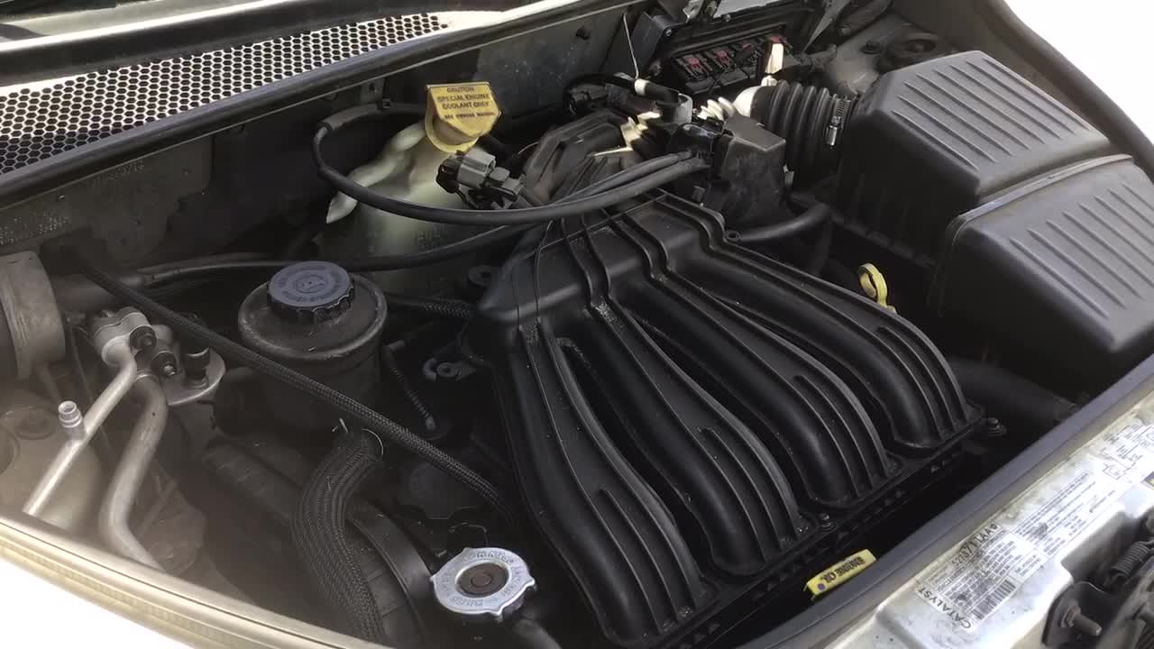

When the engine is cranking over does it sound normal? Can you please shoot a quick video with your phone so we can hear the engine crank over? I can tell what's wrong from the video, that would be great. You can upload it here with your response. Also we need to check the engine compression to make sure the engine is still in time. This is a good place to start so we don't replace parts that don't need it. These guides should help:

Thanks for your speedy reply! Here is a video of the car cranking over, I did pop the cap off of the timing belt cover and the shaft(gears) are turning but I couldn’t get camera down in there to show you! But they are turning for sure. I also replaced the oil sending sensor, and it was the fuel pump I had replaced not the oil pump! Thank you for any help you can offer!

It sounds like it has compression so that's a good sign. Can you try to spray some starting fluid into the intake to see if it will try to run?

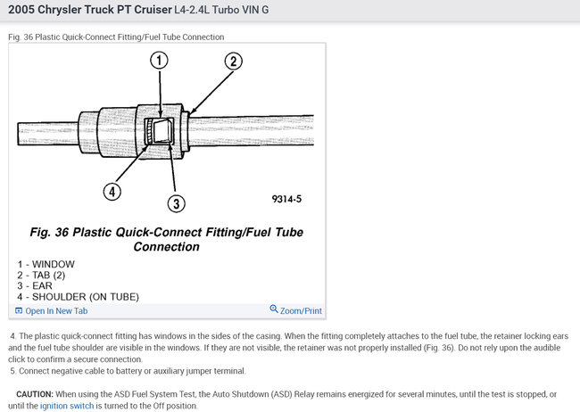

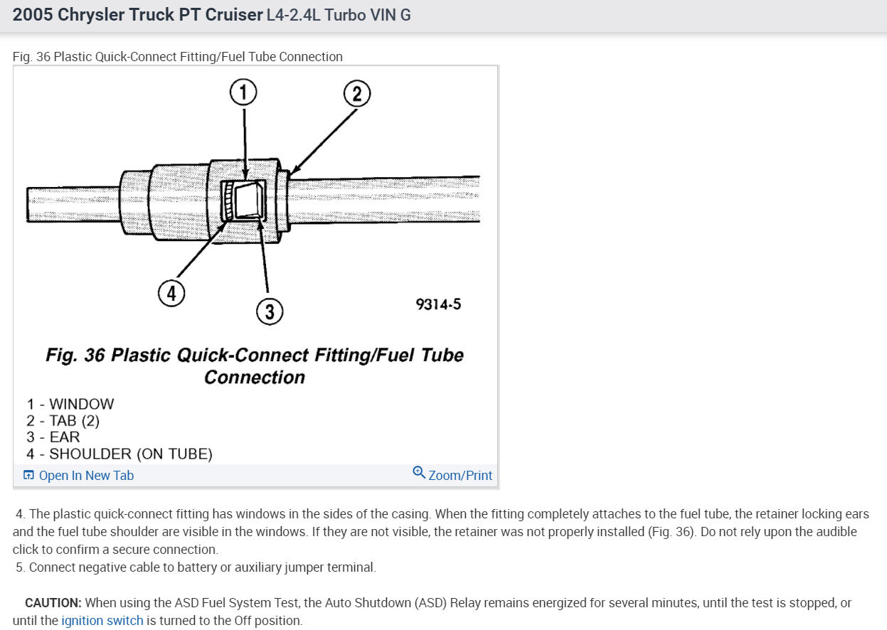

You can rent a fuel pressure gauge from a parts store and interrupt the fuel line at the engine. here is a guide to help with directions below to show you how on your car:
Fuel System Pressure .................... 400 ± 34 kPa (58 ± 5 psi)
SYMPTOM
CHECKING FUEL DELIVERY
POSSIBLE CAUSES
- Fuel pump relay
- Fuel pressure out of specs
- Restricted fuel supply line
- Fuel pump inlet strainer plugged
- Fuel pump module
- Fuel delivery system operation
- Fuel pump relay fused B+ circuit
- (A141) fuel pump relay output circuit open
- (Z1) fuel pump ground circuit open/high resistance
- Fuel pump module
