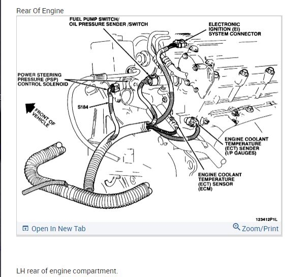

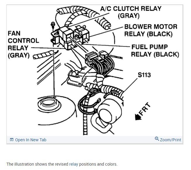

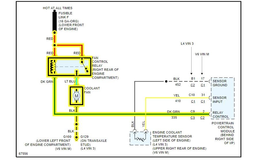

The fan doesn’t kick on. So I jump it straight to the battery to check it and the fan works.
Thursday, April 15th, 2021 AT 7:39 AM
MECHANIC
52,796 POSTS
Good afternoon,
I attached the wiring diagram for you of the system and the location of the relay.
Try disconnect the coolant sensor and see if the fan kicks on.
