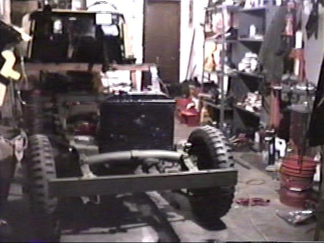

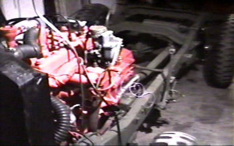

THIS IS MY VIEW ON STUFF----I HAD 5 JEEP CJ 5s PRIOR TO 1991 (ONE AT A TIME)---THEN I GOT MY "PRESENT TWO"!.......BOTH ARE DAILY DRIVERS AND WILL CONTINUE TO BE....... FOREVER
SEE MY ANSWER IN THIS LINK
https://www.2carpros.com/questions/2000-ford-taurus-wondering-car-shakes-about-10-15-minutes-start-morning
ONE IS A 1977 CJ 5 W/ 6 CYL 258.......NOW 36 YEARS OLD
THE OTHER IS A 1946 WILLYS W/134 FLATHEAD.......NOW 67 YEARS OLD
I'VE LEARNED HOW TO "DO IT ALL" OVER THE YEARS......I RESURRECTED BOTH OF MY PRESENT JEEPS FROM NOTHINGNESS.....ALL BY MYSELF (I ALSO HELP OUT OTHER LOCAL JEEP GUYS, ALONG WITH OTHER "IN THE FAMILY" VEHICLES)
