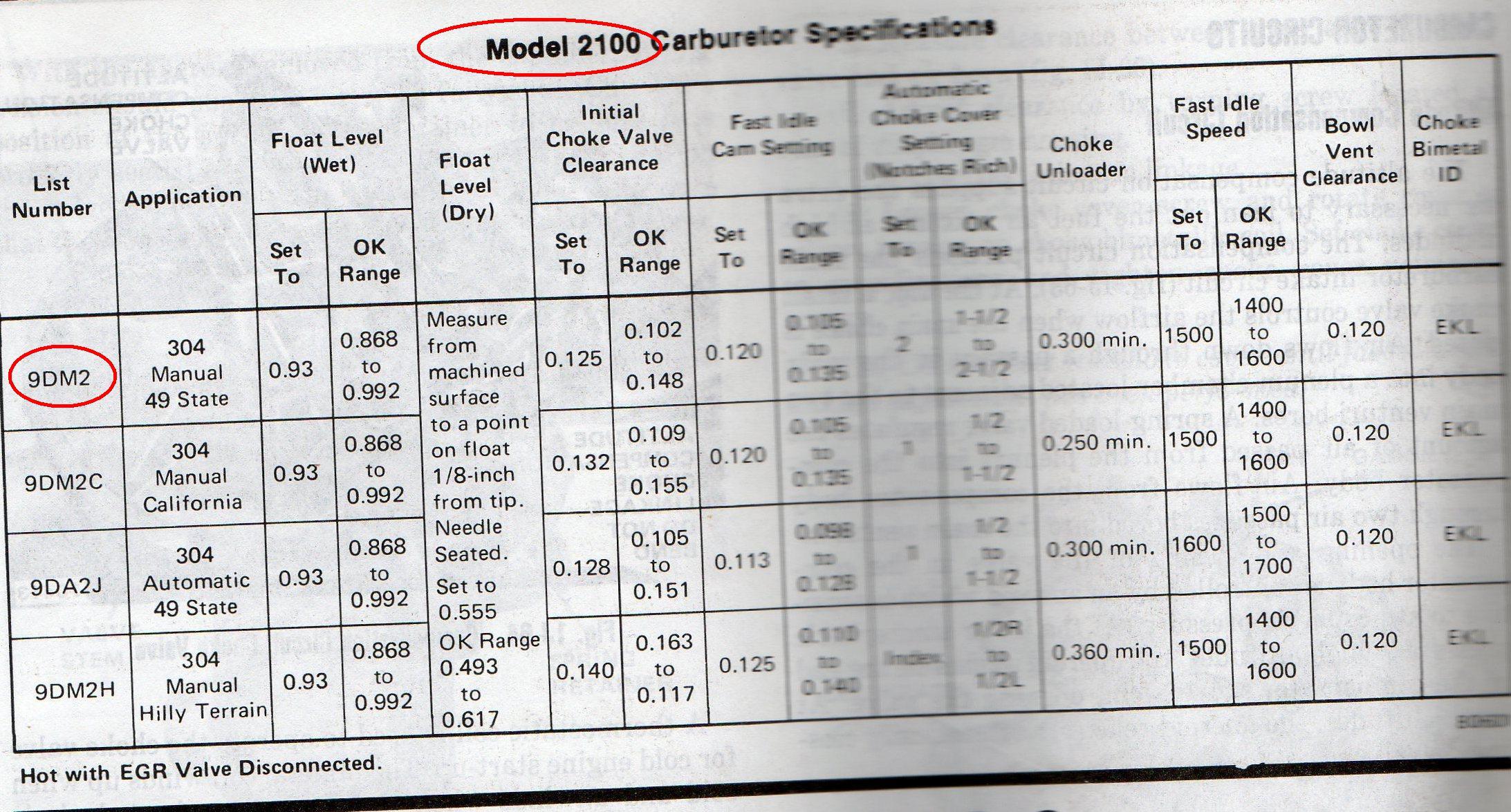

The carburetor I am rebuilding looks to be a model 2150 and was factory installed in 1979. The tag also has the following; C 9A 16, and the venturi size is 1.08. The Jeep CJ7 has the Renegade package, and the optional 4 speed manual transmission. Do you have the dry float setting, and also would the factory main jets still be a good size at 6,600 feet in elevation? The jet size numbers are unreadable, so would you also know the factory jet size? Thank You for any information you can offer!

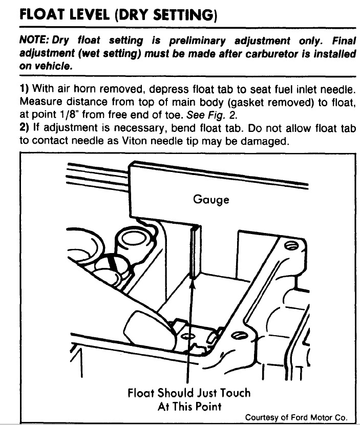

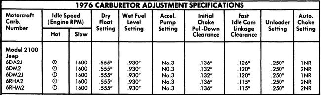

You'll have to go to a carb shop for jet size but should be ok. See pics for settings.

Thank you very much for this information Hmac300! The rebuild kit should arrive in a few days, and I can put the carburetor back together then. The information you provided is for a model 2100, so this 9DM2 carburetor must be a Motorcraft 2100, instead of a 2500? The back edge if the base is straight across.

Yes it's a 2100 the other model for jeeps is a 2150 which has a 9 h

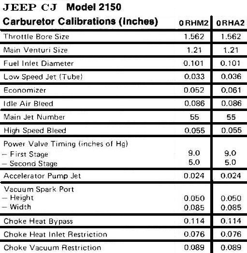

I THINK I FOUND THE DIAGRAM YOU WANTED SHOWING ORIGINAL JET SIZES

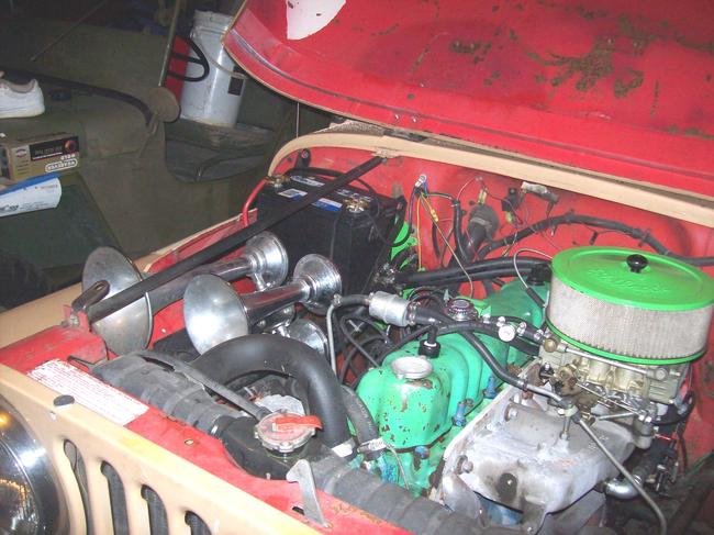

OTHER PICS OF "MR. JEEP", MY '77 CJ 5 258 W/ 4BBL 390 HOLLEY (AT LEAST IF YOU WENT HOLLEY, YOU WOULDN'T HAVE TO GET ANOTHER INTAKE AS I DID)......AND A PIC OF "WILLY", MY '46

I am working on my brother's 79 CJ7 that has been sitting for a few years, and won't start-up anymore. The carburetor bowl had so much sediment in the bottom that the main jets and power valve were mostly covered and blocked. So I am rebuilding it on the cheap, but want it to run right at 6,600 feet in elevation. I had contemplated a Holley 350 cfm model #7884 2bbl swap, but when I removed the original 2bbl Motorcraft carb, it had more vacuum lines protruding from it than I wanted to deal with, so I decided to rebuild the Motorcraft carb. I understand that everyone wants a four barrel carb for performance, but I can rebuild this one for the price of a carb kit (new old stock carb kit from ebay $21.00), and a few hours of my labor. Don't tell my bro, but I am learning to rebuild carburetors on his vehicles. Lol He also has an MB, and a 1949 CJ2A that has a Holley #1904 carb that was my first carb rebuild. I used to have a 1955 CJ5, 1965 Cj5, and a 1979 Jeep J10 pickup, but don't own any at present. We have always had a soft spot for the older Jeeps. I was not aware of the air-fuel gauge you have, but will keep that in mind. The carb specification chart you have is for a different venturi size than the one I am working on which has a 1.08 venturi, so I'm not sure if it applies. Thank You very much for all the helpful information!

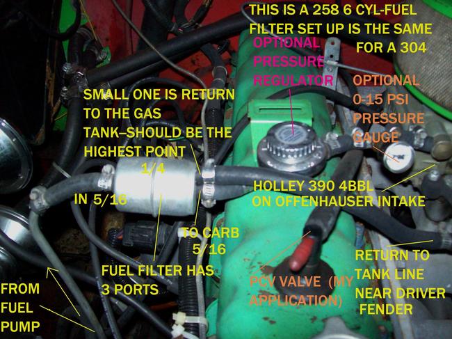

I'M GUESSING YOU ARE STILL SET UP WITH THE STOCK 1 INLET...2 OUTLET FUEL FILTER? SEE 1ST PIC

Pic 1)look at these tag numberslook at the carb model. Need more info on that carb. The book shows it all! Adjusting and all!

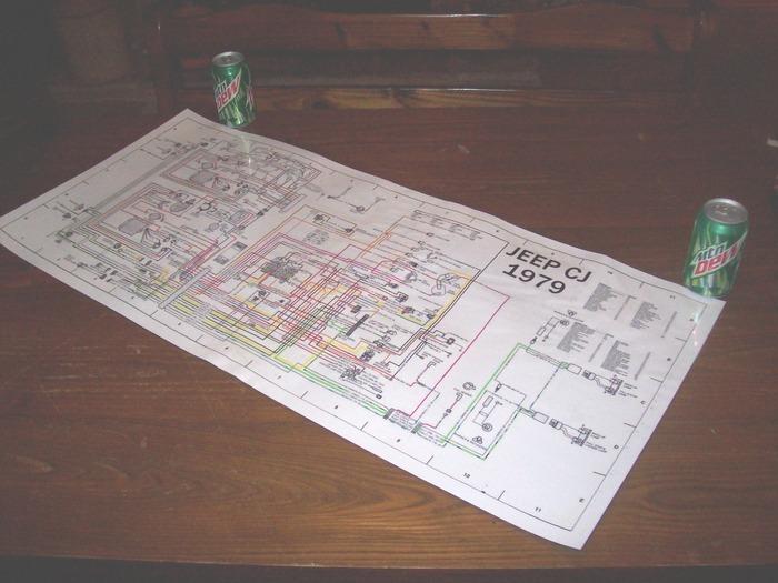

Pic 2) like my scanned/ enlarged/ painstakingly colored/ and laminated '79 wire diagram?
