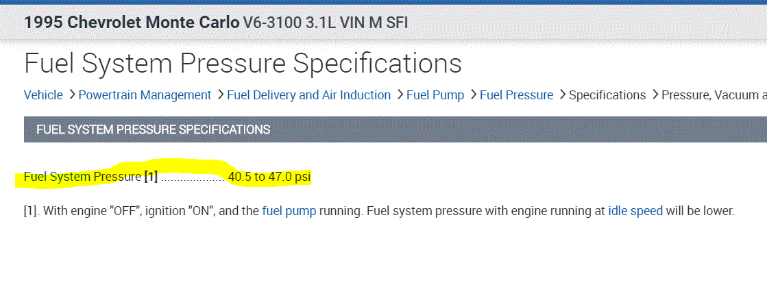

Two things. First, if it has OBD1, you don't need a scan tool. 1995 was the cross over year from OBD1 to OBD2, so I assumed this had OBD2. All you need is a short jumper wire or even a paper clip to get codes. Follow this link:
https://www.2carpros.com/articles/buick-cadillac-chevy-gmc-oldsmobile-pontiac-gm-1983-1995-obd1-code-definitions-and-retrieval-method
Next, what you described sounds like low fuel pressure. Has that been checked yet?
If you haven't, check pressure. The attached pic shows the manufacturer's specs for pressure on this vehicle.
Let me know what you find.

It’s only getting 10% gas. Took the car in, still waiting to see what they can find out.

No problem. Let me know what they tell you. It could be a plugged fuel filter, but chances are it is the pump.

They did a back pressure test on it. They got it running the catalytic converter, they think it’s was plugged. It had a hole in it and they pushed it through.

Glad to hear it's fixed. That was one of the thoughts I had in my first post to you. Regardless, I'm glad to hear it is running good for you again. Please feel free to come back anytime in the future if you have questions. Also, thanks for letting me know what was found.
