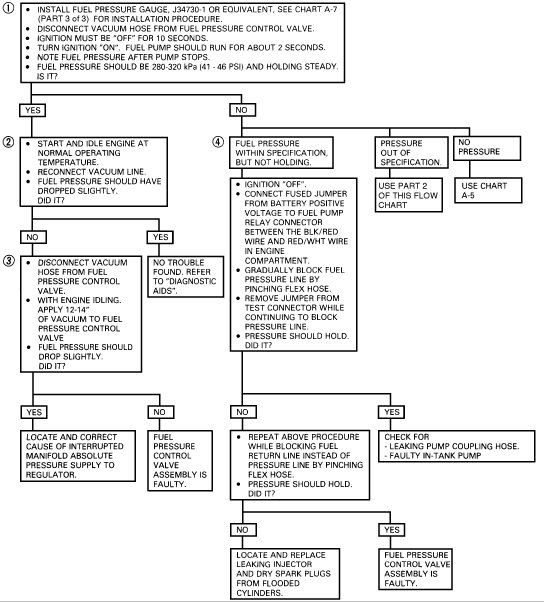

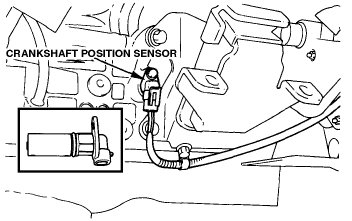

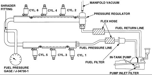

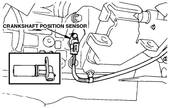

First this is the wife's car so she is sure I broke it, haha. It has always ran pretty good since we have had it. The water pump went out with the previous owner and when he replaced it he also put a new timing belt in. So the power steering belt was worn bad and squealing so I replaced it. Literally it has never ran right since. It would start and run but hesitate here and there, then slowly got worse until it would randomly shut off. You could feather the throttle and keep it going but eventually it got to the point where it did not want to start at all. In about a months time it has progressed to this. I have replaced plugs but last ones went horrible, also the TPS, and AIC valve. I have pulled the throttle body and cleaned and the EGR as well. Cannot find any vacuum leaks. It used to throw o2 and EGR code so replaced the o2 and EGR code only came on once in a blue moon after a long drive. Now if I go out after it sits all night it will start and idle, but at around 1,100 rpm. Does not want to drive without shutting off. After I shut it off that is it, it will not start again until it sits overnight. I am at a loss. Thanks for any help. Dan

One of these elements will be missing. Once you determine which one it is, then we can focus on a specific component. Something tells me that when you replaced the belt, you may have damaged one of the wires going to the crankshaft position sensor. NOTE: If you have a real time scanner, check to see if there is a signal from the aforementioned sensor. If there is no signal, check wiring. If wiring is good, replace sensor.
I have attached directions for removing and replacing the sensor. Additionally, I have attached pictures to help guide you.
1995 Honda Truck Passport 4WD V6-3.2L SOHC (6VD1)
Vehicle  Powertrain Management  Computers and Control Systems  Crankshaft Position Sensor  Service and Repair
SERVICE AND REPAIR
REMOVAL
Preparation: Disconnect Battery Ground Cable. Remove Exhaust & Transfer Protector. Disconnect Front Propeller Shaft Joint.
Disconnect Wiring Connector.
Remove Mounting Nut from the exhaust and transfer protector.
Remove Crankshaft Position (CKP) Sensor
INSTALLATION
To install, follow the removal steps in the reverse order.
Install Crankshaft Position Sensor into the Cylinder Block.
NOTE: Before installation, apply small amount of Engine oil to the O-Ring.
Torque: 9 N.m (78 lb.in)
Tighten the Mounting Bolt of the exhaust and transfer protector to the specified torque.
Torque: 63 N.m (46 lb.ft)
Reconnect the Wiring Connector.
Connect Front Propeller Shaft Joint and tighten to the specified torque.
Torque: 37 N.m (27 lb.ft)
Connect Battery Ground Cable.
Tighten the Exhaust & Transfer Protector Fixing Bolt to the specified torque
If you find that spark is missing, the first concern is the crank sensor in this situation.
Here are specific directions for checking fuel pump pressure for your vehicle.
Vehicle  Engine, Cooling and Exhaust  Engine  Fuel Pressure  Testing and Inspection  Test 1 of 3
TEST 1 OF 3
Circuit Description
The Fuel Pump delivers Fuel to the Fuel Rail and Injectors, where the system pressure is controlled from 280 to 320 kPa (41 to 46 psi) by the Fuel Pressure Control Valve. Excess fuel is returned to the Fuel Tank. When the Engine is stopped, the Pump can be energized by jumping the Fuel Pump Relay Connector with a fused jumper.
Test Description
Number(s) below refer to circled number(s) on the diagnostic chart.
Use Pressure Gauge J-34730-1. Wrap a shop towel around the Fuel Pressure Tap to absorb any small amount of fuel leakage that may occur when installing the Gauge. (The pressure will not leak down after the Fuel Pump is stopped on a correctly functioning system.)
While the Engine is idling, Manifold Absolute Pressure is low (high vacuum). When this is applied to the Fuel Regulator Diaphragm the vacuum will result in a lower fuel pressure at about 190 - 200 kPa (25 - 30 psi).
The application of high vacuum to the Fuel Pressure Control Valve should result in a Fuel pressure drop.
Fuel pressure leak-down may be caused by one of the following:
Fuel Pump Check Valve not holding.
Pump Coupling Hose leaking.
Fuel Pressure Control Valve leaking.
Injector sticking open/leaking.
NOTE: Fuel System is under pressure. To avoid Fuel spillage, refer to field service procedures for testing or repairs requiring disassembly of Fuel Lines or Fittings. Refer to part 3 of 3 of this chart.
Diagnostic Aids
Improper Fuel System pressure may contribute to one or all of the following symptoms:
Cranks but will not run.
Diagnostic Trouble Code 44 or 45.
Cutting out (May feel like Ignition problem).
Hesitation, loss of power or poor Fuel economy.
Picture 4 is a flow chart to help diagnose fuel related issues.
