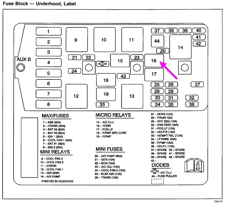

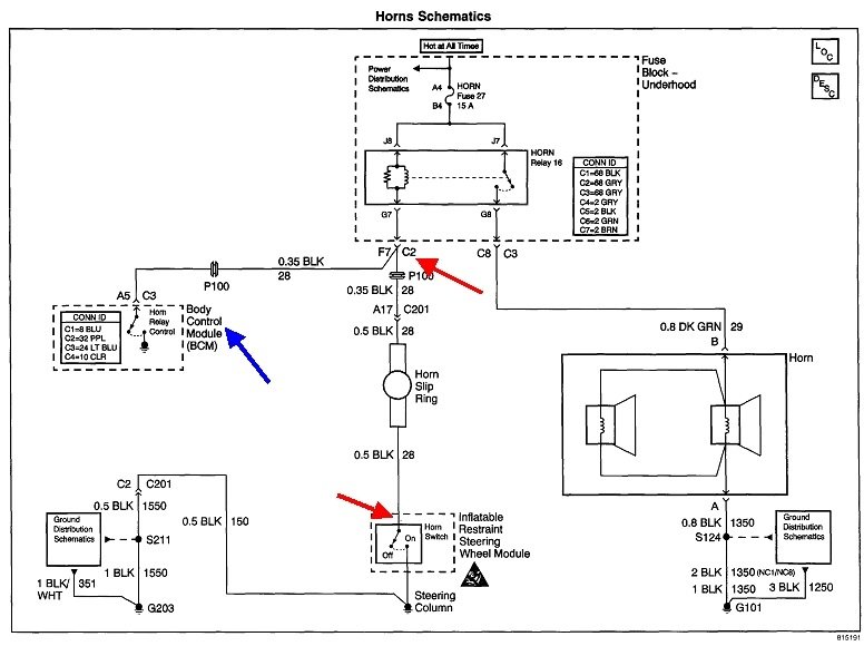

For your horn, the best suspect is a shorted clock spring. Pull the horn relay out, then pop the fuse back in. If the horns are easy to reach, unplug them. Now, when you start to reinsert the relay, chances are you'll feel it click. In the unlikely event it doesn't click, and the horns turn on when you plug one back in, that relay is shorted, as in the contacts are welded together. That doesn't happen very often, and on older cars it never happened because they used a special sliding contact design to prevent that.
We really should start a new question for the horn. The site is set up to organize topics and car models in a way others researching the same problem can find these posts. Someone working on a similar car with a horn problem won't find this in any index when it's added on to the idle speed topic.
Regardless, here's the horn diagram to get you started. If the car has a factory anti-theft system, the Body Computer, (blue arrow), can ground the coil for the horn relay to chirp the horn. That driver circuit could be shorted. The fastest test would be to unplug that computer and see if the horn relay clicks off.
They show the horn switch circuit between the two red arrows as having a slip ring. That was what all cars used before air bags came along. Any small spots of dirt or dried grease could cause an intermittent connection for the horn switch, but only until the steering wheel was turned slightly. Even normal vibration with the engine running is enough to make a sufficient contact for the relay to turn on.
They can't rely on that sliding contact for an air bag. Those are timed to the millisecond to deploy at the proper time. To insure there's a solid connection, they use a wound-up ribbon cable inside a plastic housing, under the steering wheel. Since that cable is already there, it's a simple matter to add a few additional circuits for cruise control switches and the horn. It's not that uncommon for some of those circuits to unravel and touch each other. Those would be on the diagram where they show the slip ring. Anything shorted to ground between the two red arrows will turn the horn relay on.
Normally air bags are very safe to work on, but the one thing that worries me is when the clock spring is coming apart. For demonstration purposes, an air bag can be fired with a little 9-volt transistor battery, so it doesn't take much. Static electricity can do it too, but that threat is eliminated when any bright yellow connector is unplugged. The air bag side of the connector will have a shorting bar inside it to prevent accidental deployment when the bag is being handled. Those shorting bars are pushed out of the way when the plugs are connected. That leaves it vulnerable to static discharge when the clock spring comes apart. A quick test to put your mind at ease is to observe the red "Air Bag" light turns on for six seconds when you turn on the ignition switch, then it turns off and stays off. That is the self-test period where a defect in that part of the clock spring would be detected. If there's no defect in that part, the air bag system is safe to work on.
Normally when clock springs fail, the ribbon cable snaps off on one end. The most common list of symptoms is the cruise control and horn don't work, and the "Air Bag" warning light stays on. Often these three systems fail a few days apart.
I'll go into more detail later if necessary, but for now, just be aware when you replace a clock spring, it can only rotate just slightly more than the steering system from full-left to full-right. It has to be centered, otherwise it will wind up too tight when turning one way and the cable will snap instantly, or it will unwind too far the other way and fold over on itself. That will also cause it to break on one end, but it will take some time.

The second drawing shows the horn relay in the under-hood fuse box.

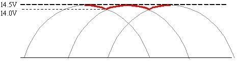

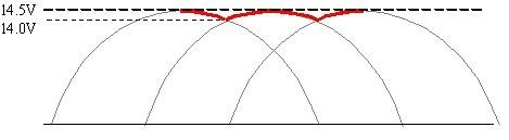

In many applications you can do a simple test for ripple voltage yourself with a digital voltmeter. Switch it to "AC Volts" on a low range, typically 20 volts, then measure the battery's voltage while the engine is running. I use a professional load tester that shows relative ripple voltage, so I don't have a good feel of what's a normal or high AC voltage. One problem with this test is it basically just shows if there's "some" or "none" ripple voltage. Digital voltmeters are designed and calibrated to read a 60-cycle sine wave on "AC Volts", as would be found in your house. Automotive generators put out three phase output which triples its frequency beyond what is already a lot higher than 60 cycles per second, even at idle, plus, it's not a nice clean sine wave.
Here's some drawings I put together a while ago. The first one shows the output of each of the three phases, for half of a cycle. When one phase has gone past its highest output and is on the way down, a different phase is coming up on its maximum output. Think of a three-cylinder engine with three equally-spaced power pulses. It would feel fairly smooth.

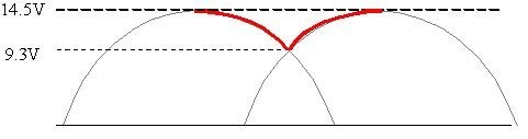

The second drawing shows a missing phase due to a failed diode. This would be like feeling one misfiring cylinder on a three-cylinder engine. You'd definitely know it.
In both drawings, the red lines show the actual voltage being developed by the generator. It has to be higher than battery voltage to force electrons to go into the battery to be stored there. This is the ripple voltage. In the first drawing, it's only half a volt. That is real easy for the battery to smooth out. As I drew it in the second drawing, with one missing phase, ripple voltage is 5.2 volts. That is almost impossible for the battery to clean up. On older cars that would be heard as a loud whining noise on AM radio. The only other symptom is under a full-load output test, the generator would only be able to develop exactly one third of its rated current. 20 - 25 amps from the common 65-amp generator could have been enough to meet the demands of the electrical system and keep the battery charged, but not on newer cars with all their computers and electrical systems.
This ripple voltage with the red lines is what the professional load testers measure, and is more accurate than what you'd see with a digital voltmeter.
