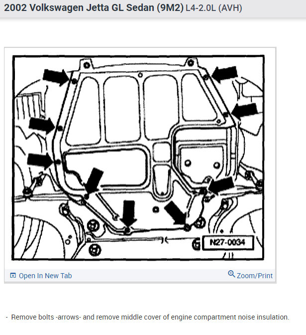

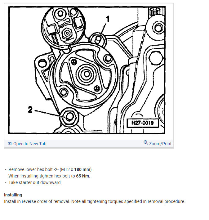

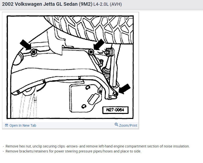

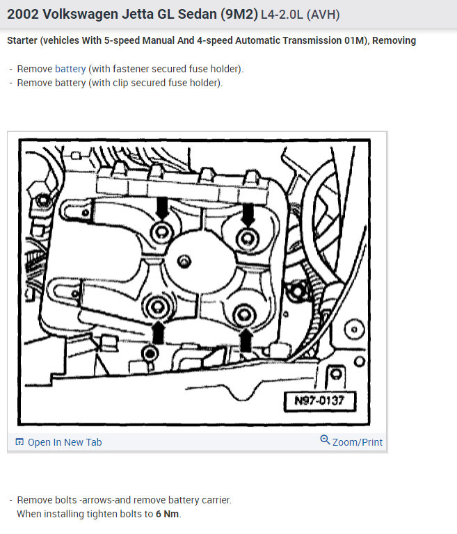

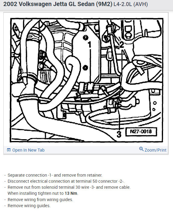

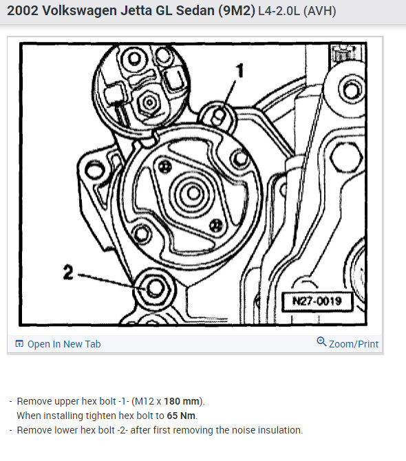

It sounds like you might have an issue with the starter.
The clicking noise is made the starter solenoid.
It probably has corrosion inside and that's why it works intermittently.
It could also be a connection issue to the solenoid. If the wire is lose or corroded it can have similar issues.

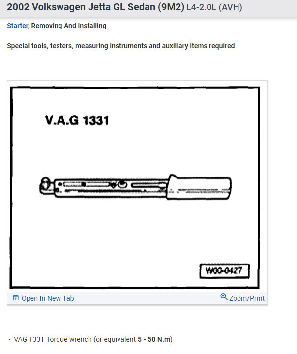

First check the starter and verify everything is connected securely. You can also test the starter by attaching 12V power source to see if it spins. You want to do that when it is off the vehicle.
You might find these articles helpful:
