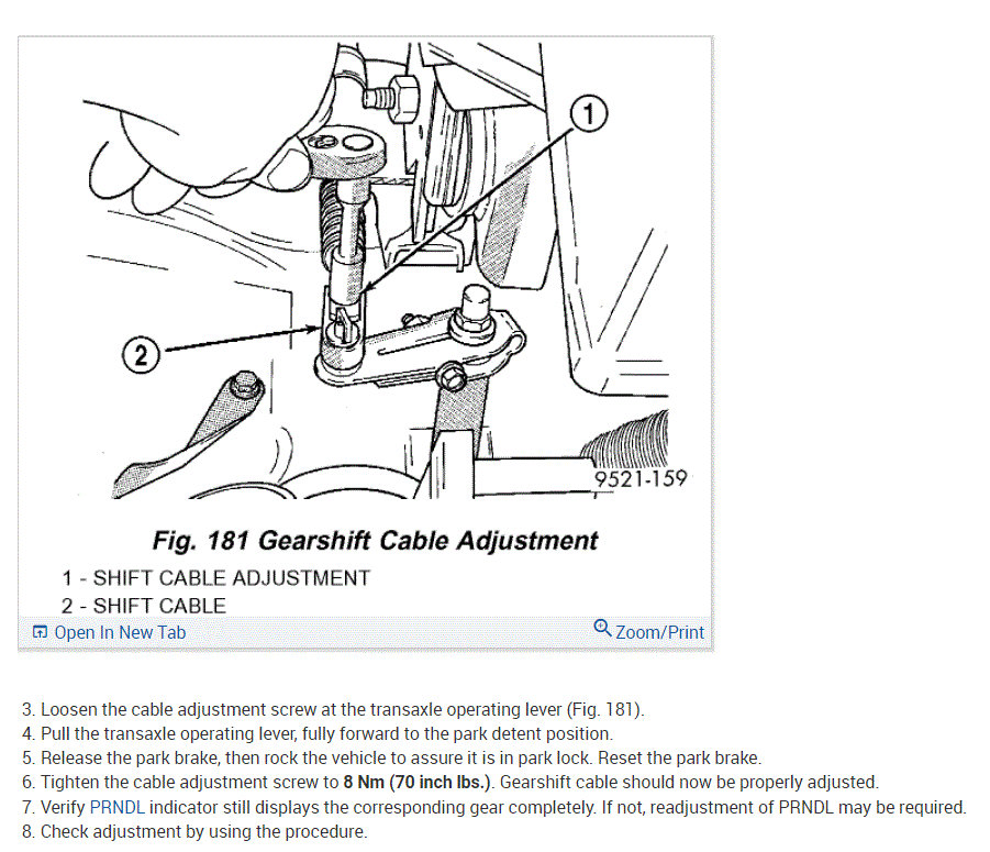

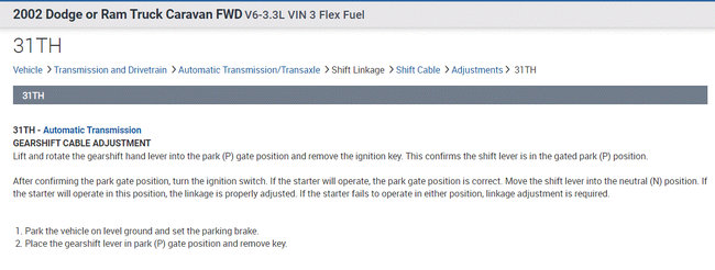

Can you tell approx where the click is coming from? Also, the idea that it shows reverse when it is in park may indicate the shift linkage needs to be adjusted. That is where I would recommend starting.
If you look at the two pics below, they include the directions and pic for adjusting the shift cable. Try this first.

Try the adjustment first and let me know what you find.

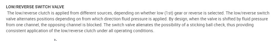

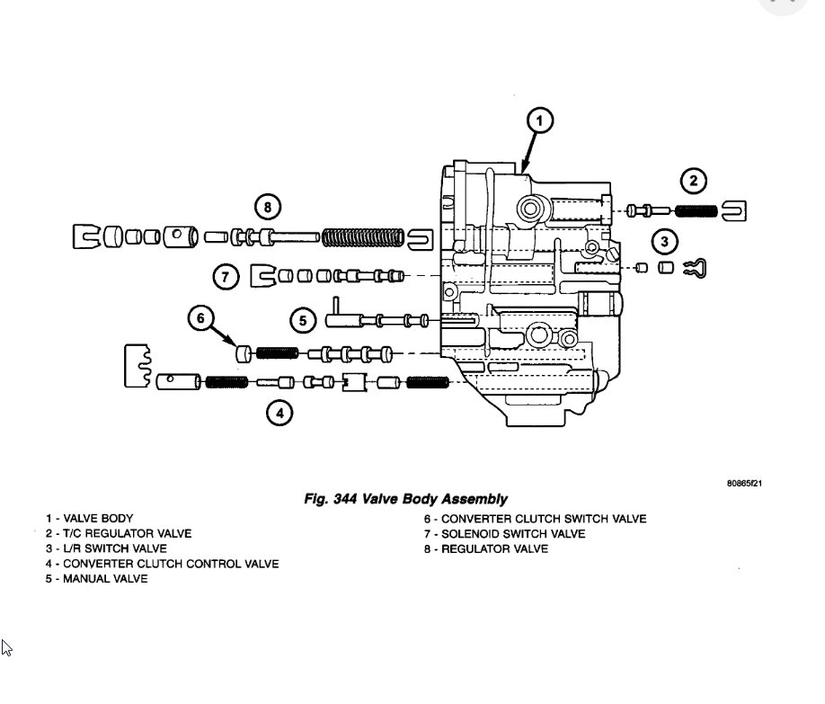

We need to start with checking fluid. If it is low it could cause issues but it is unlikely that this would only effect reverse.
The most likely cause is the valve body has a leak in the L/R solenoid which is allowing fluid to leak past a point that is supposed to be blocked off which would create the needed pressure. Unfortunately the only way to repair this is to replace it or rebuild it.
Let me know if you have questions and we can go from there. Thanks

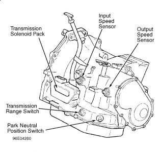

When I drive the car takes a while to shift into gear and I doulbe check, the water, motor oil, and transmission oil every mornining before leaving so I know its not missing oil. I have notice that every time that I stop and then go it like forces it's self it turn on the (servie engine soon) light. How do I go about trying to fix it or to repair to find out what it is.
Friday, May 21st, 2021 AT 12:12 PM (Merged)
BMRFIXIT
  • 19,053 POSTS
https://www.2carpros.com/forum/automotive_pictures/99387_Graphic9_11.jpg
Suspect speed sensor and or coil solenoid pack need to have the codes you can have it scanned or cycle the ignition key on off on off on read P0000 codes in the odometer area
