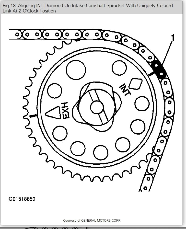

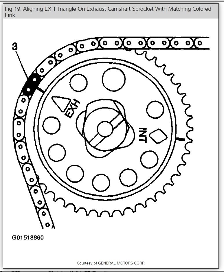

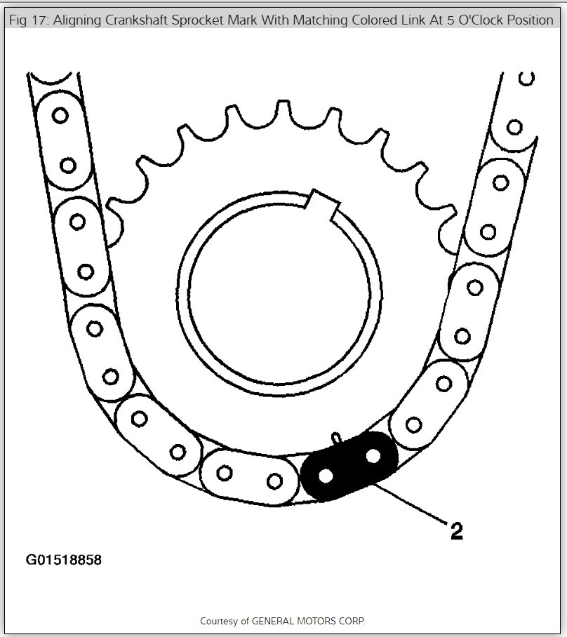

Car is showing these codes:
P0112 p1171 p0340
+1
Thursday, August 18th, 2016 AT 6:56 AM
JCTEXWEB1
  • 12 POSTS
P0112 p1171 p0340
P1171 - Fuel system lean during acceleration
P0340 - Camshaft Position Sensor A Circuit (Bank 1 or single sensor)
P0112 - Intake Air Temperature [IAT] Sensor Circuit Low Voltage
Thursday, August 18th, 2016 AT 8:20 AM
KEN L
  • MASTER CERTIFIED MECHANIC
  • 55,065 POSTS
The cam code makes me think the engine has jumped time. Do a compression test and if low check the timing chain. here is a guide and diagram so you can check it out.
Please let me know what you find
Best, Ken
