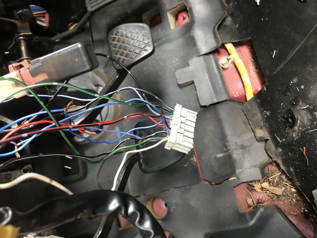

Took out aftermarket security system now car will not start. Everything is working, I can hear fuel pump come on, all lights work. Push in clutch and try to start it will not do anything. They spliced a bunch of wires for the aftermarket security system and I have replaced it all, but still nothing. I have one plug that does not go to anything, do not know where it goes.

Quick question first. Can you use your phone to take a picture of the plug/harness and upload it here? It would help us identify and we can attach the appropriate wiring diagrams for you. Thanks for using 2CarPros.

The wiring needs to be connected properly not just twisted together next. Can you take shots of under the dash so we can see where the connector plugs into?

Okay, looked at the wiring and pulled up the install sheet for that unit. It is a basic alarm with a plug in starter cutout. So there is a plug in the starting circuit under the dash and this unit would have had a short jumper wire plug that installed in there to keep the starter from operating. If that is still in place then it is very likely the item that is causing the no start. The plug you have should be for the optional alarm Honda had. Not used without the OEM so that is why there is nothing to plug it into.
