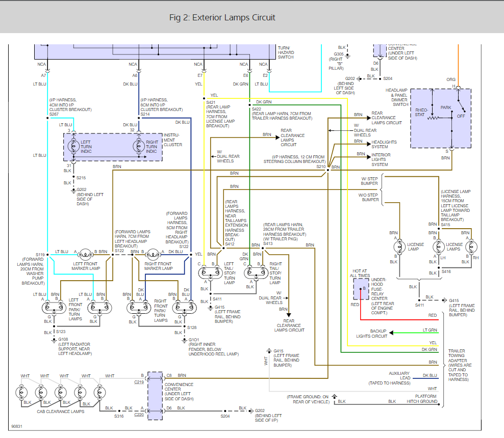

IMEASY24
When I pulled the right bulb the left signal light kept blinking. I noticed that when you have the blinker going and hit the brake it quits blinking. Any ideas?
Monday, February 8th, 2021 AT 5:14 PM (Merged)
KEN L
  • MASTER CERTIFIED MECHANIC
  • 55,322 POSTS

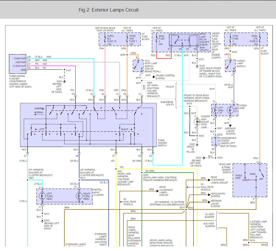

It sounds like you have a hazard or turn signal switch that is having a problem but to confirm here is a guide and a blinker wiring diagram (below) so you can do some testing. Remove the blinker and brake lights before you begin testing.
Please let us know what happens so it will help others.

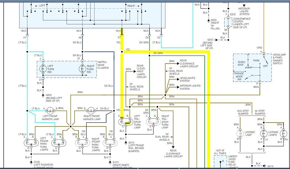

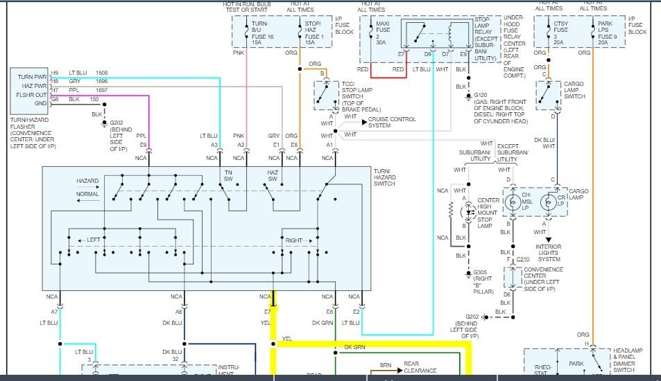

Bought the truck listed above about a month ago. Owned many had same issue on a few but this one is different. Left side break and turn signal light is not working. Already changed fuses brake light switch and relay. Still can't get it to work right. Also all new bulbs and boards. Can't seem to find a break in the wire anywhere.
Good morning,
I attached a wiring diagram for you to view. Test the yellow wire I highlighted for power with the brake applied or the left turn signal activated.

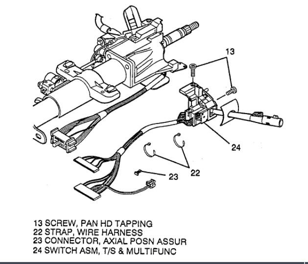

https://www.2carpros.com/articles/turn-signal-switch-replacement
Tools Required:
J 41352 Modular Column Holding Fixture
Or Equivalent
REMOVAL
Remove or disconnect the following:
1. Do steps 1 through 7, Refer to Shroud and Lock Cylinder Set Replacement.
2. Two wire harness straps (22) from steering column wire harness.
3. Steering column bulkhead connector from vehicle wire harness.
4. Axial position assurance connector (23) from electrical BTSI actuator (61). (Column shift only)
Electrical connector from BTSI actuator (61).
5. Grey and black connectors of turn signal & multifunction switch (24) from column bulkhead connector.
6. Two pan head tapping screws (13).
7. Turn signal & multifunction switch assembly (24) from column.
INSTALLATION
Install or connect the following:
1. Turn signal & multifunction switch assembly (24) to column.
With small blade screwdriver compress electrical contact and move multifunction switch (24) into position.
Electrical contact must rest on cancelling cam assembly (6).
2. Two pan head tapping screws (13). Tighten (13) to 6.0 Nm (53 lb in).
3. Grey and black connectors of multifunction switch (24) to column bulkhead connector.
4. Electrical connector to electrical BTSI actuator (61). (Column shift only)
Axial position assurance connector (23).
5. Steering column bulkhead connector to vehicle wire harness.
6. Two wire harness straps (22) to steering column wire harness.
7. Do steps 4 through 10, Refer to Shroud and Lock Cylinder Set Replacement.
