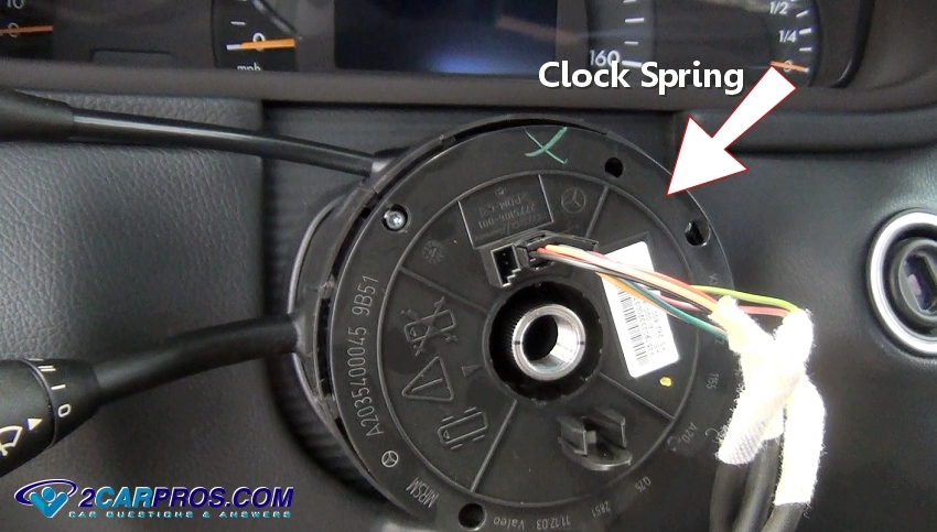

Beneath the steering wheel the electrical system clock spring or spiral wire is next, this part is designed to facilitate the steering wheel controls and horn operation while the wheel is in motion, it can be held in place by using mounting screws which will allow you to remove the clock spring.
steering wheel clock spring

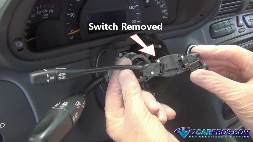

The directional switch is now exposed and ready for replacement, loosen and remove the turn signal switch mounting bolts or screws, in this case the switch is held in place by a squeeze clamp.
remove turn signal switch mounting bolt
Gently grasp the switch and column bowl assembly and pull it outward to remove it from the column.
Once the switch has been removed, inspect wiring connections and terminals for corrosion, some turn signal switches are designed with a wiring harness attached which will need to be disconnected near the bottom of the column before removal.
turn signal switch removed
