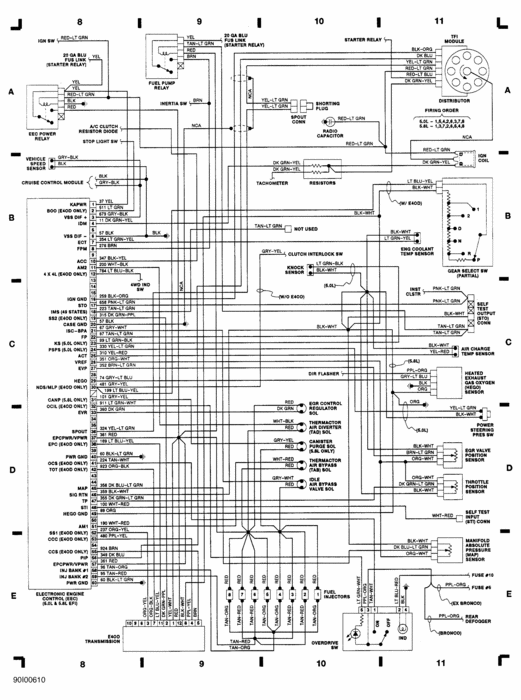

Engine Mechanical problem
1993 Ford Bronco V8 Four Wheel Drive Automatic 289000 miles
I am the original owner of a 1993 Ford Bronco with 289,000 miles. Within the past year and a half, I have experienced some engine problems in that the engine bucks intermittently at freeway speeds. Checking the tachometer while this is happening, it appears that the electrical systems are experiencing some interruptions.
Mechanics seem to be baffled. They state that my truck has the type of computer which does not record problems so therefore they can't find a fault. Short of throwing parts at it, they advise to drive it until it fails to run. For the past 8 months, I've been doing exactly that.
When cold, the engine has occassionally stalled.
Their have been no regular patterns to the problem.
However, the problems seem to have started when the in tank fuel pump was replaced after it failed and stranded me once.
More recently, the A/C has suddenly failed, and the heater works intermittently. It seems that they just quit working one day. No fuses were blown.
The symptoms seem to indicate some sort of electric failure????

We had one in the shop several years back that would eat up the ignition control module every 3 years. It could not be confirmed unless the truck was in the state of not starting.
To help the diagnosis along the owner left the truck with us, while the shop owner drove it for a month. We had no problems the whole time. It had left her stranded several times prior. She picked it up and didn't more than 10 blocks and it quit. Boy , was she upset. But we were able to go down and confirm it at that point.
I don't know that this is the case on yours, but may be tough to uncover.
The a/c and blower problem may be able to be uncovered by having the blower in the on position and wiggling wires on that circuit to uncover a bad spot.
