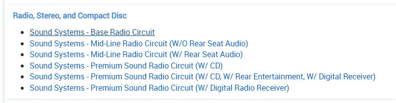

Is the anti-theft light stay on at all times? As far as the radio, I tried looking through schematics. There are several to pick from. If you look below, I included the list. Can you identify which one your vehicle originally came with? That way I can look at the specific wiring schematics to determine if the connector was put back together correctly.
I know there are a few serial data lines that reach splice packs on different options. In these cases, they are controlled via the body control module, so I really need to be specific. I hope you understand.

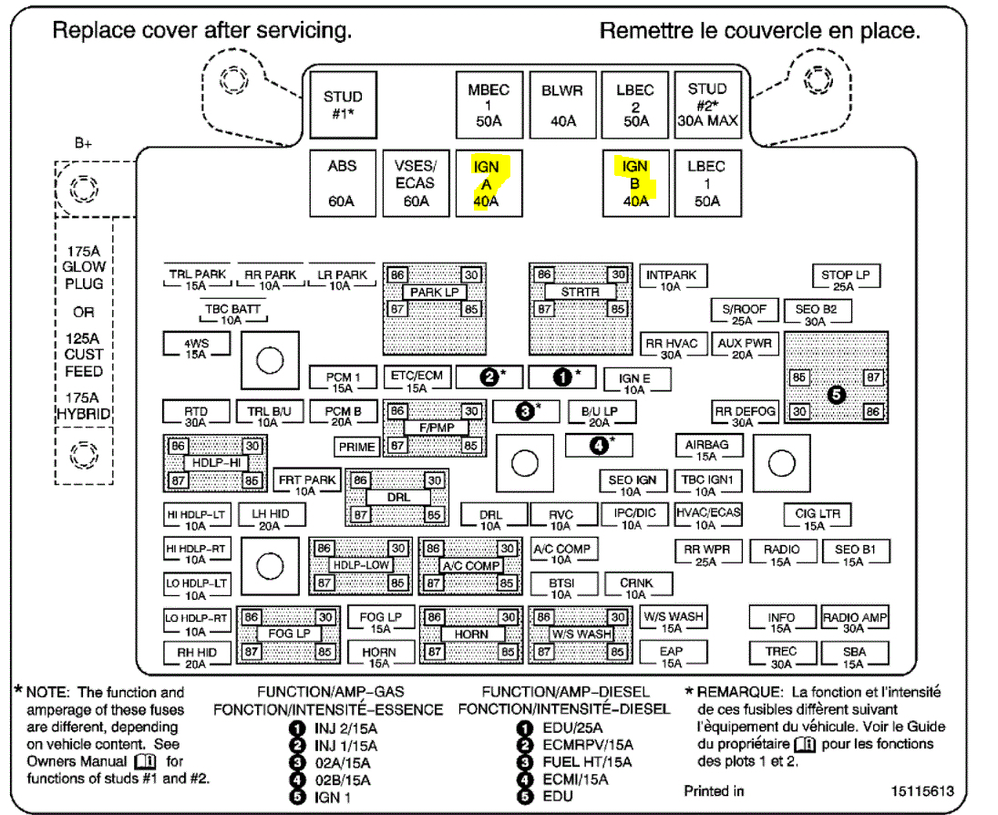

If you turn the ignition and nothing happens, let's see if a fuse failed when you removed the switch. There are two 40-amp fuses under the hood I need you to check, Ignition A and ignition B. See pic below.
Check the fuse and confirm there is power to them.
Let me know if the starter is now engaging or not.

Fuses aren't blown.
