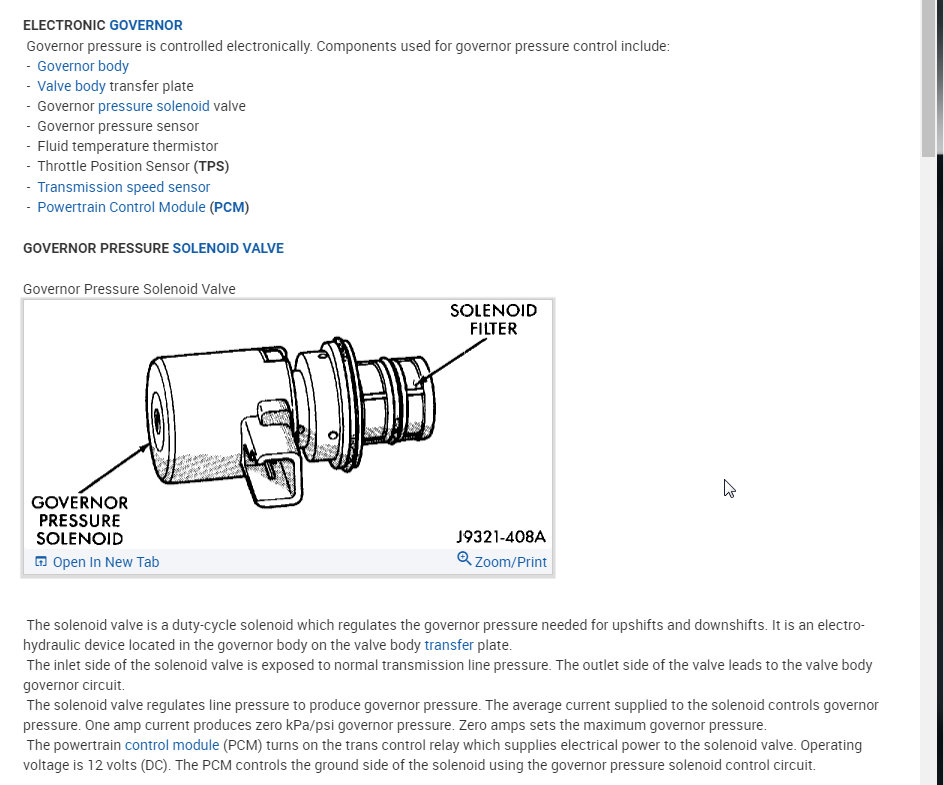

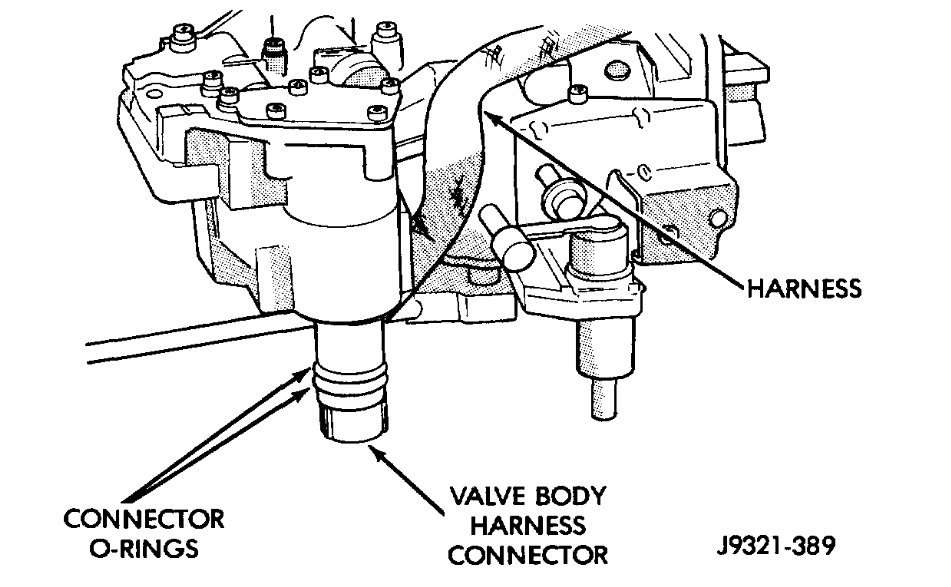

My first and stock transmission kept kicking out of overdrive on its own, then didn't have overdrive. Changed fluid and filter out 3 times and it would work okay for a day or two then quit working. After a while it wouldn't go into gear or anything. I had two codes on light, TCC solenoid, and shift solenoid. Changed both of them worked fine for 4 days then transmission went completely out. Bought a used transmission, has a warranty and after changing transmission those same two codes popped up. After changing the transmission it only had third and second gear. I would have to manually shift from second to drive for me to have second and third. After changing both solenoids in drive i have first but wont shift out. I have first and second if manually shifted. Now i hear a whining noise sometimes coming from transmission and it wont shift into gear right away. I have to rev the truck up then it will violently shift into reverse. Don't know if the ECM is causing this because my truck will stall and has doing it for a while now. I have to wiggle the middle plug in order to start it back. Can my ECM be the culprit?

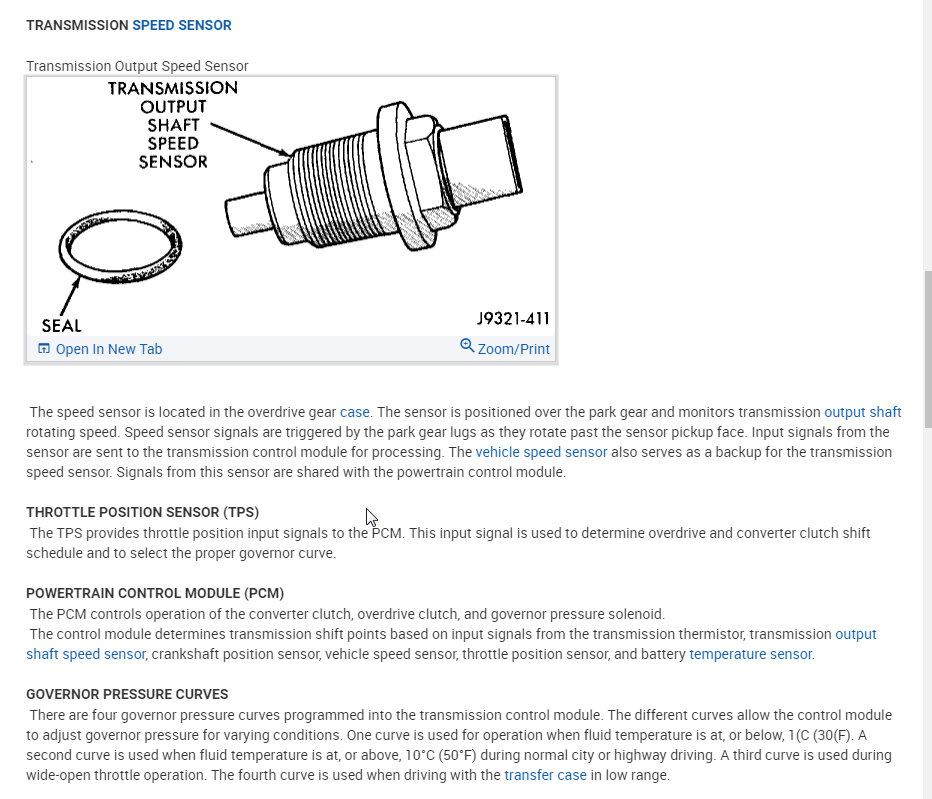

Let's start with what the actual codes are. Let me know the P codes and we can go from there.
I can make some guesses but the ECM may not be the cause because the ECM makes decisions on a few inputs. I am thinking it could be the transmission speed sensor but lets get the codes first and go from there.
Also, which transmission do you have? I assume it is the 44RE but let me know if it is the 46RE. Thanks

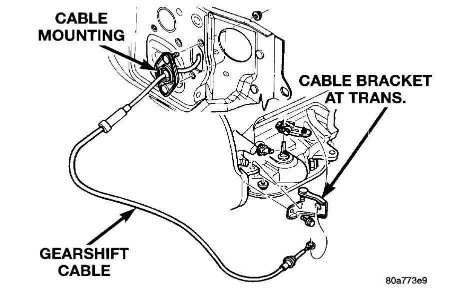

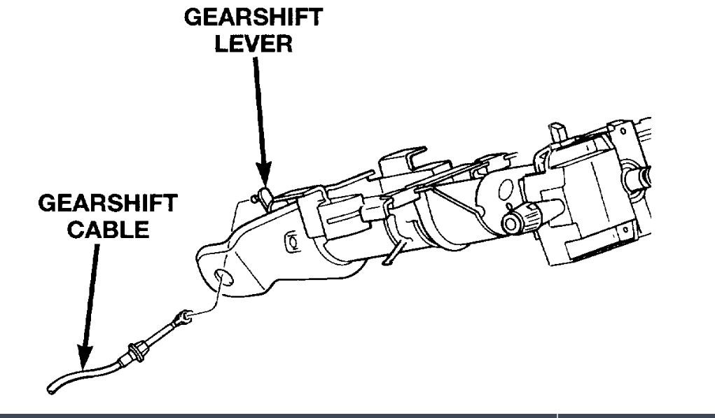

I can move my shifter all over but it does not change from park.
Dec 18, 2020 at 10:35 AM (Merged)

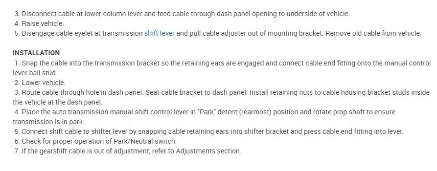

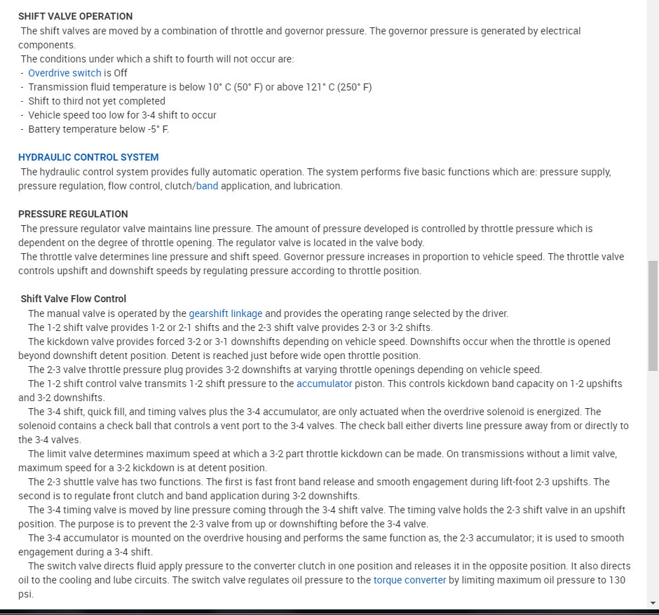

Good morning,
The first thing I would do is check to see if the cable is still attached at both the shifter at the bottom of the steering column and at the transmission.
If it is connected, then most likely the cable is broken and needs to be replaced.
I attached pictures and the procedure below for you to view.
CHRIS BROWN4
I tried that last night and it is good.

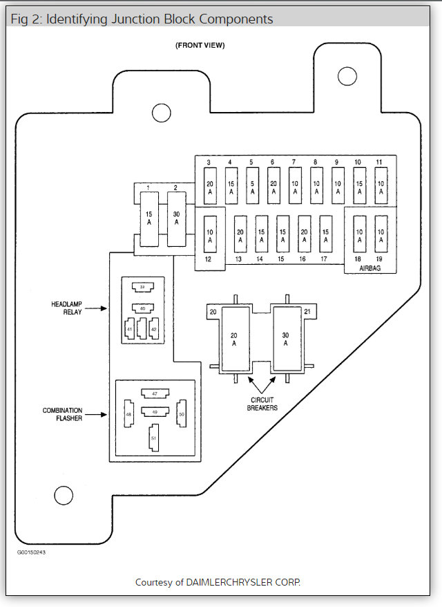

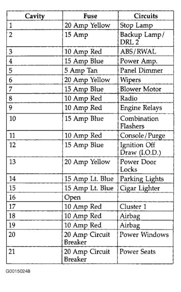

  • 54,520 POSTS

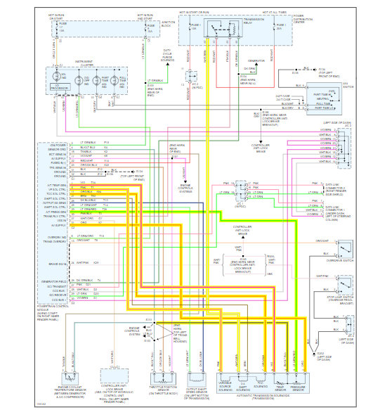

Let's check the fuse #5 in the interior fuse panel. here is a guide make sure it has power:
Here is the fuse locations. Check out the diagrams (below). Please let us know what you find. We are interested to see what it is.

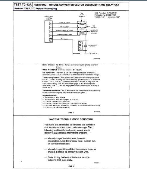

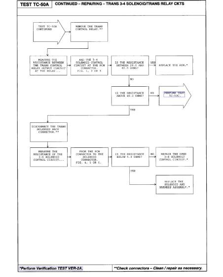

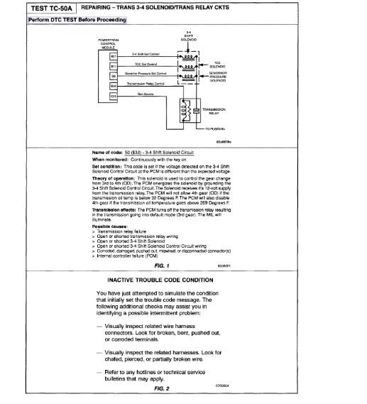

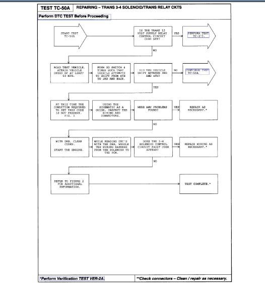

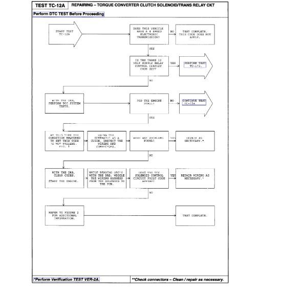

P0743, p0753.

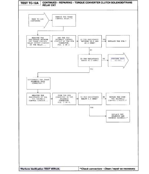

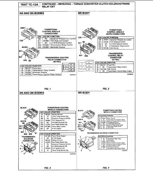

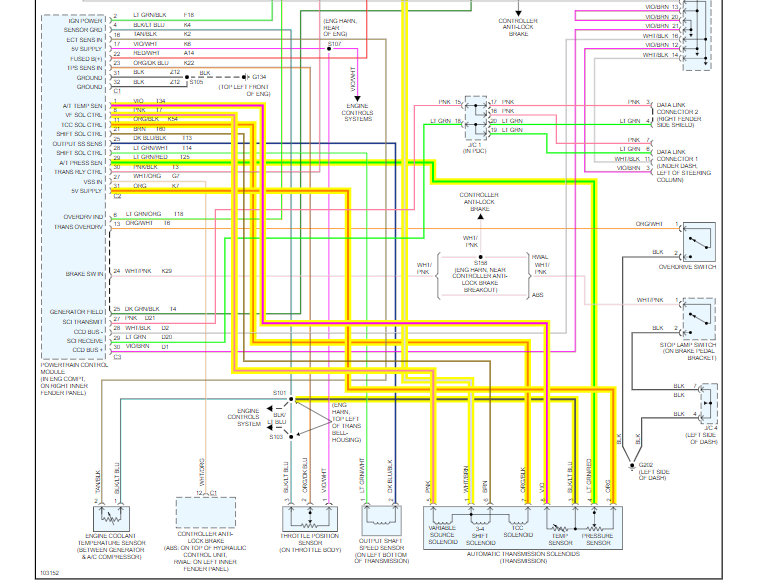

Okay, The 743 is for the torque converter clutch solenoid circuit.
It could be the solenoid, wiring, valve body or a bad torque converter.
The flow chart is attached.
I will get the other code as well.

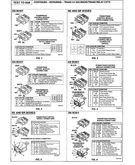

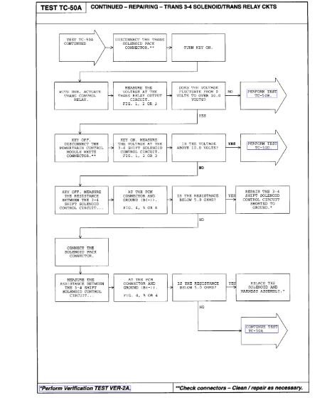

Okay, the 753 is for the shift solenoids.
The one thing they both have in common is the wiring harness. You need to check that harness very carefully for any damage.

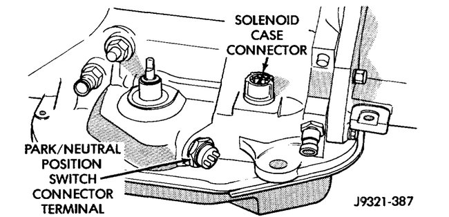

Okay, I’ll do that. Is this on the outside of the transmission?
Some of it and the rest is inside. You need to access the valve body by dropping the pan.

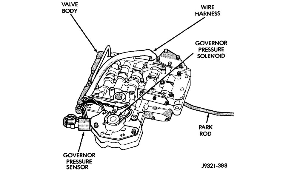

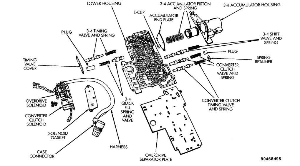

Okay, and can you show me a picture of what the torque converter clutch solenoid looks like for my car? I think I know but want to know for sure.
I attached a picture of the location for the solenoid.

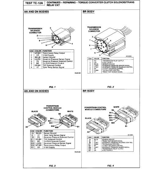

Did you verify power to the solenoids?

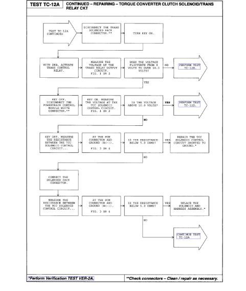

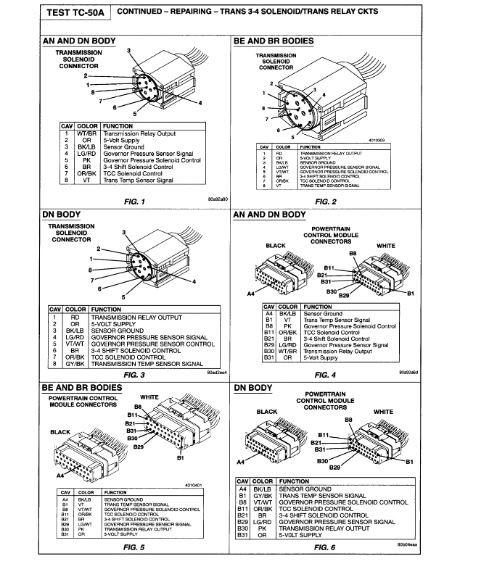

You need a voltmeter and need to test for power to one terminal on the solenoid with the key on.
You said you checked the harness. what and how did you check it?
Dec 18, 2020 at 10:36 AM (Merged)
STARLORD1976
  • 173 POSTS
I just checked it for damage and make sure it was connected.
Okay, you need to test for voltages at the solenoids as shown in the diagrams.

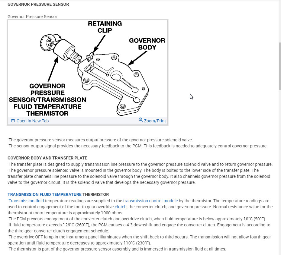

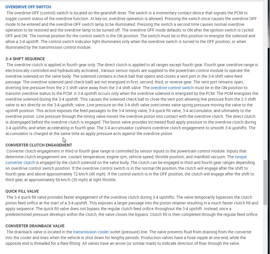

Can you send me real pictures of all the solenoids and how many should there be? Thanks
I attached pictures for you.

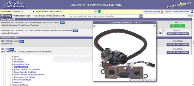

I can’t find online what the shift solenoid a looks like or can’t find one for sale can you help?
I attached a picture for you from the part at rock auto.

Okay, going way back, I suggested you check voltage to the solenoids as part of the test.
Did you test the voltages from all the charts I sent you?
STARLORD1976
  • 173 POSTS
No, I just thought if I put all new solenoids in it would work.
No, as I stated before, you need to verify voltage to the solenoids first. The code indicates a power issue.
You need to check the actual voltage to the solenoids.
