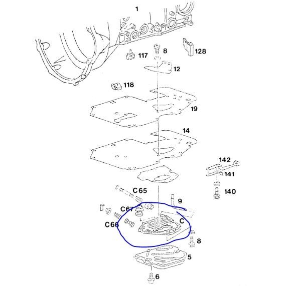

I am having an issue with the transmission not shifting correctly. The transmission will shift into 2nd gear at 20 mph, 3rd gear will shift at 40 mph and no sooner, and it will not shift into 4th gear until I hit 75 mph. If I let up on the throttle down to 65 mph it will shift back down to 3rd gear. It will not shitf back into 4th until I go back up to 75 mph. I have checked all vacuum and put a new modulator valve on the transmission. This did not help. Same result. The transmission always starts off in 1st gear. I have read they should start in 2nd gear but this one does not. Transmission is a 722-315

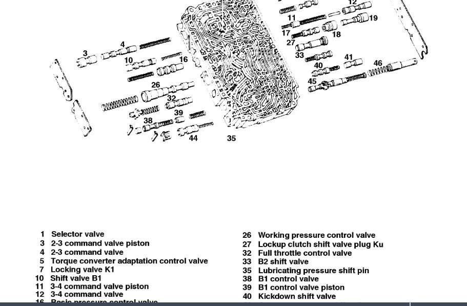

Good afternoon,
Is the 4 matic transmission? It was an option in that year.
I would start by changing the fluid and filter. It sounds like a valve body issue where the valves are not moving smoothly.
Make sure you use the correct fluid as it makes a huge difference in how it shifts.
I attached a picture of the valve body for you as well.

Okay, this sounds like a valve body issue.
One thing, does the modulator valve have a vacuum hose on it? If it does, measure the vacuum. It need to be around 18-20 inches. That vacuum would come from a vacuum pump.

Okay, good, then we are back to the valve body itself.

Do they rebuild the valve bodies? Would you know if a rebuild kit is available for this?
Thursday, July 16th, 2020 AT 3:38 AM
A tech with knowledge can rebuild one. There is not much to them.
I do not have a parts manual to see if it is available separately.
Check around trnamission shops and see if anyone is familiar with this transmission.
