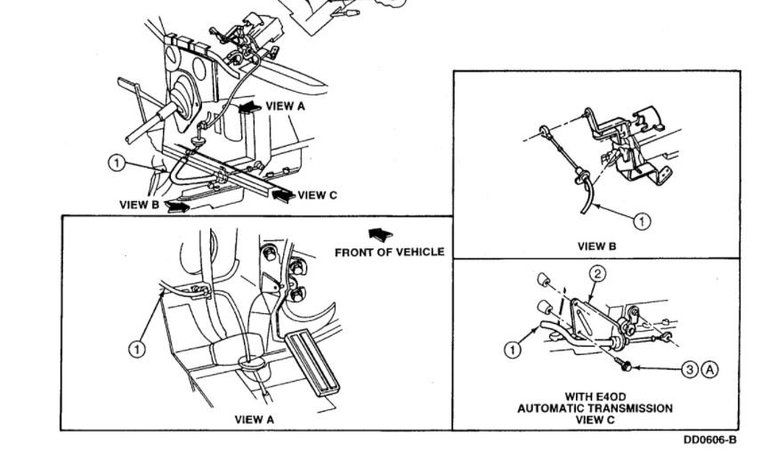

My shifter on column broke. I disconnected the linkage underneath to shift into drive so I could move it. I moved it back and forth easily the I went towards first gear and now it won’t go back. I’m assuming it’s stuck in first and now I can’t start it either. In a serious bind and need to get it moved please help.

Good afternoon,
This sounds like the cable itself is bad and is seized internally. This most likely is the reason the shifter broke.
I attached the cable and shifter procedure for you to view.
REMOVAL
1. From under instrument panel, disconnect shift cable from steering column.
2. Remove cable plastic terminal from gear shift lever pivot ball by prying with a screwdriver between cable plastic terminal and gearshift lever.
3. From engine compartment, pry cable grommet from dash panel.
4. Remove the plastic slide adjuster from manual lever pivot ball, prying with a screwdriver between the slide adjuster and manual control lever.
5. Remove transmission shift cable from transmission shift cable bracket by carefully lifting on the locking tab while pulling up on the fitting.
6. From engine compartment, pull cable through the instrument panel opening.
INSTALLATION
1. From instrument panel, feed plastic terminal end of cable through opening in dash panel to engine compartment.
2. Press cable grommet on transmission shift cable into dash panel.
3. From engine compartment, install transmission shift cable into transmission shift cable bracket and make sure locking ears are properly located and seated into bracket.
4. Remove the control cable retainer and replace with a new control cable retainer.
5. Place transmission shift cable on manual lever pivot ball and press into place.
6. Push on the locking tab and make sure it is fully seated and locked into place.
7. From the passenger compartment, install cable to steering column bracket. Make sure it is fully seated.
8. Snap cable plastic terminal to shift control selector lever pivot ball on steering column.
9. Adjust transmission shift cable.

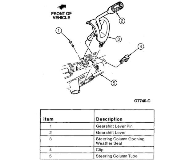

Shifter
REMOVAL
1. Remove steering column release lever by unscrewing from the steering column.
2. Turn ignition switch lock cylinder to RUN position. Using a 1/8-inch drift, depress ignition switch lock cylinder retaining pin through access hole and remove ignition switch lock cylinder.
3. Remove retaining screws of the instrument cluster mask and remove instrument cluster mask.
4. Remove four retaining screws from lower steering column shroud. Remove upper and lower steering column shrouds.
5. Using a small screwdriver, pry steering column opening weather seal from pedestal on ignition switch lock cylinder. Slide instrument cluster mask toward handle of shift control selector lever and housing to expose shift lever pin.
6. Disconnect Transmission Control Switch (TCS).
7. Using a small drift, tap shift lever pin from bottom for removal. Discard shift lever pin. Remove gearshift lever.

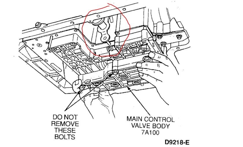

I understand all of that but the transmission should still shift at the transmission if you take the linkage off , shouldn’t it?
Jan 19, 2021 at 11:49 AM
CAJUN00

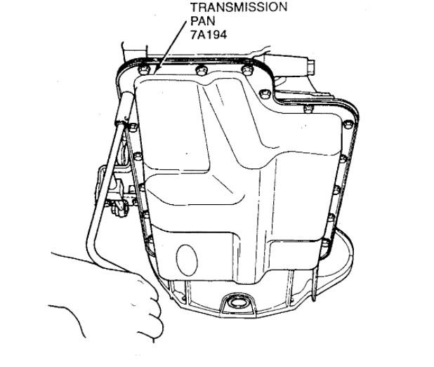

I disconnected the linkage at the transmission. I manually shifted it a few times easily. The last one seems like I went too far and now it won’t go back to park or anything. It’s like it’s stuck in 3rd or past.
Jan 19, 2021 at 11:51 AM
  • CAR REPAIR CONTRIBUTOR

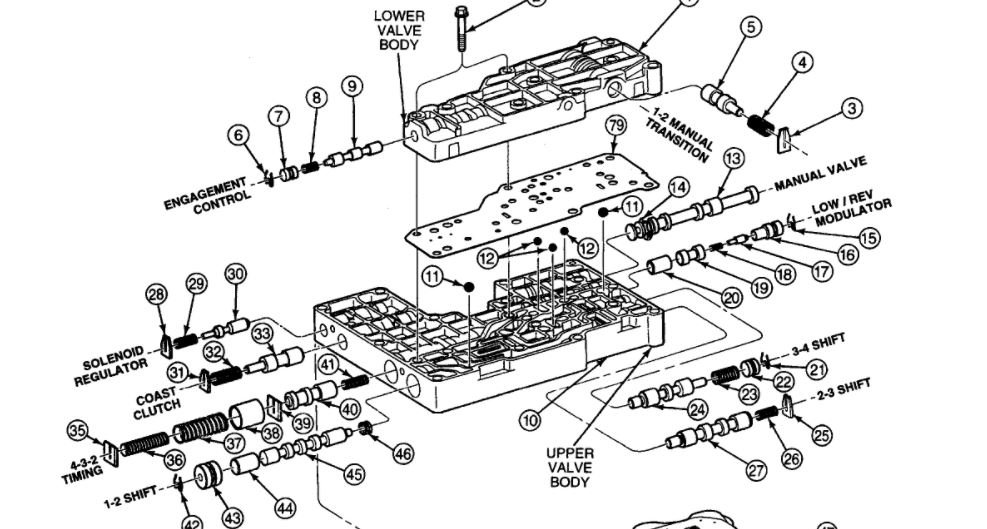

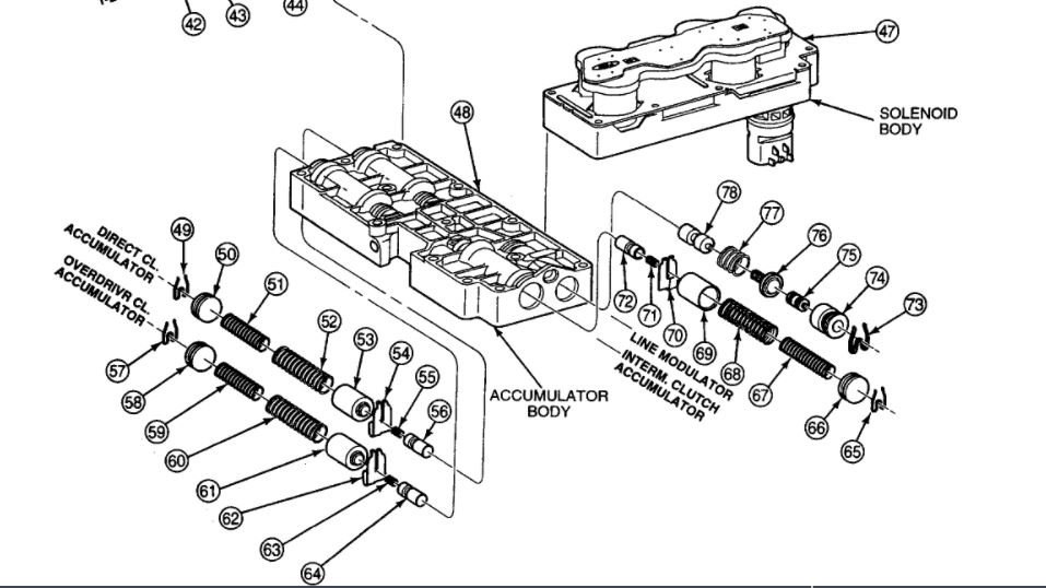

You did not specify you disconnected it at the transmission. You said underneath which I thought was under the dash.
As far as the linkage at the trans being stuck, that is the valve body in the transmission.
I attached pictures of the valve body for you.
Jan 19, 2021 at 12:03 PM
CAJUN00
Sorry for the bad communication. So what do I do? I shifted it manually a few times and it was fine then it got locked in place?
Jan 19, 2021 at 12:06 PM
If you cannot move it, then you will need to drop the pan and inspect the linkage and see why it will not move.
REMOVAL
1. Raise the vehicle on a hoist and position suitable safety stands under vehicle.
2. Place a drain pan under the transmission pan. Remove rear and side transmission pan bolts using a 10 mm socket.

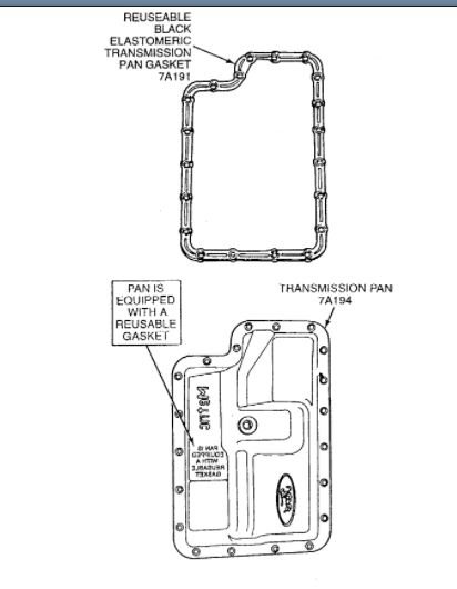

3. Loosen the front pan bolts using a 10 mm socket. Lower the rear of the transmission pan from the case and allow fluid to drain.
4. Remove front pan bolts using a 10 mm socket. Remove transmission pan.
5. Remove, but do not discard, reusable elastomeric transmission pan gasket.
CAUTION: Cork gaskets and elastomeric gaskets are not interchangeable. If you remove a cork gasket, replace it with a cork gasket. If you remove an elastomeric gasket, clean, inspect and reuse unless gasket is damaged. Be careful not to cut or bend elastomeric gasket.

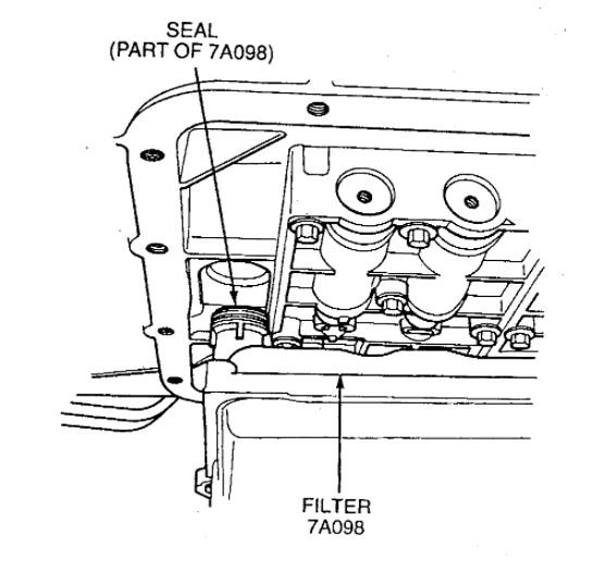

6. Remove filter assembly and seal by carefully pulling and rotating filter as necessary. Discard filter assembly and seal.
NOTE: Seal might remain in bore when filter assembly is removed.
7. If seal remains in bore, carefully remove using a screwdriver.
CAUTION: Use care not to scratch or damage aluminum pump bore.
