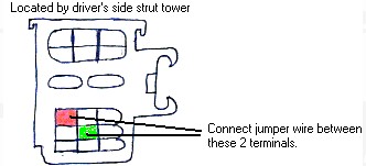

pull the codes and hopefully there will be something there.
use a jumper wire and jump these two contacts in the plug that looks like this
https://www.2carpros.com/forum/automotive_pictures/281878_toy_jumper_1.jpg

What should happen when I hook the jumper wires?
If there is a problem what will happen and what should I do about it? I understand what to do but I don't know what it means. Thanks
Wednesday, July 22nd, 2009 AT 8:27 AM
BUDDYCRAIGG
  • 2,262 POSTS
Use a jumper and jump those two connectors.
then get in the car and turn the key to the ON position.
the check engine light will start to flash.
now, knowing how to count the codes is kinda a trick the first few times you do it.
here is a video of me pulling codes.
It's on a different car, but the way the light flashes the code at you will be the same.
jump ahead to 2:30
http://www.youtube.com/watch?v=sRoSMhEL3Ms
