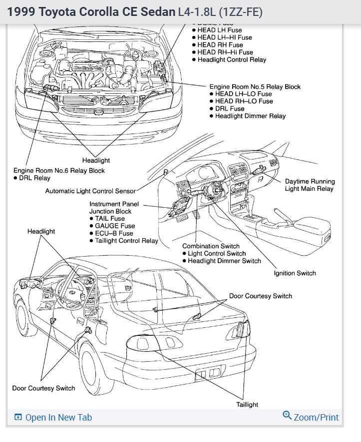

Ok there is also a relay behind the glove box for the daytime running lights have you checked that one? If not then please do. The light green and black wire going to it should only have power when the key is in the on possition. Let me know what you find and we will go from there.

Its was the tail light control relay but to be sure here is a guide to help test it and the location of the relay below.
