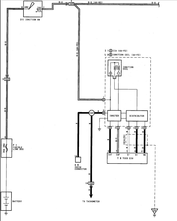

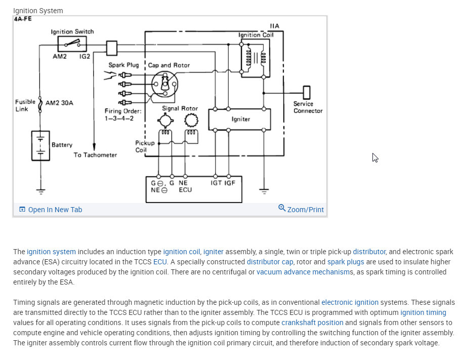

SQUEEGE
1990 corolla with no spark. good coil good pick-up coil, power to the igniter with ignition on. could it be a bad fuel injection relay ?
Dec 26, 2020 at 2:20 PM (Merged)
  • CAR REPAIR CONTRIBUTOR
  • 75,992 POSTS
Double check the Ignitor the fuel injector relay has nothing to do with spark then again it doesn't exist.
SQUEEGE
IS THERE A way to ohm the ignitor for resistance. Could this be a grounding problem.
  • 75,992 POSTS
Might also be the Igt and Igf circuits or the computer itself. Test the distributor pick-up coil resistances before you do above.
SQUEEGE
I have no spark. Replaced ignition switch, 2 different ecu's and 2 different distributor assmblies. Ignition coil is also new Every thing ohms out fine. Checked wiring for obvious problems. Car ran good a couple weeks ago but died and now have no spark. I noticed that the "check engine light" is not on during cranking or with the key in the on position. I also was checking the relays and noticed that the Main Engine Relay and the Efi/f/htr relay pulling in when you turn the key on but don't disengage when the key is turned off. This doesn't seem right. This is got we going nuts as I desperately need this car back on the road asap.
Thanks
  • 75,992 POSTS
You must have a shorted or open connection between the distributor and ECU here is a guide and the ignition system wiring diagrams so you can do some testing.
Check out the diagrams (Below). Please let us know what you find.
Cheers
SQUEEGE
Thanks for the guide and diagram I found the black wire not connecting so I ran a new wire and it fired right up ! ya! I love this site
  • 75,992 POSTS
Glad you could get it fixed, that kind of problem can be tough. Please use 2CarPros anytime we are here to help
Cheers
