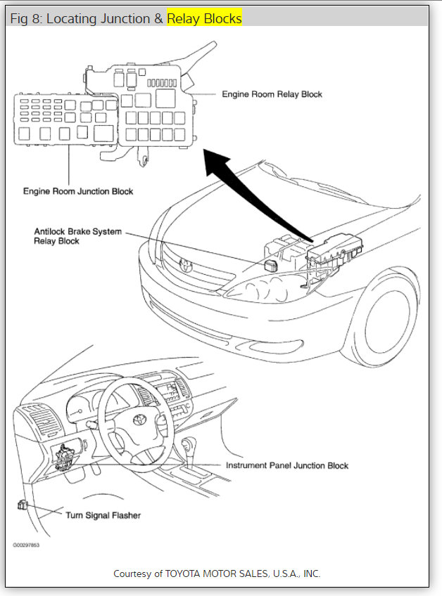

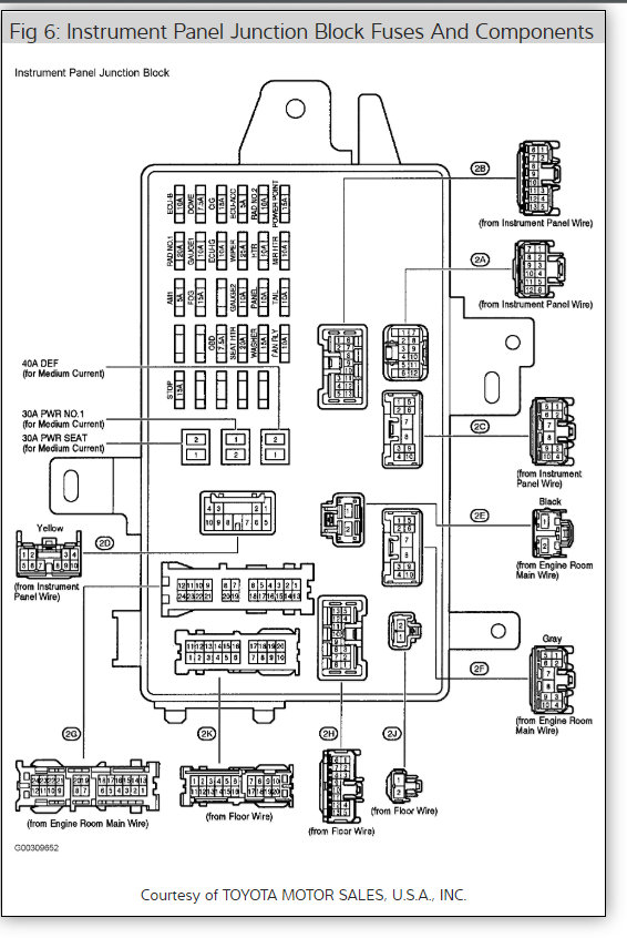

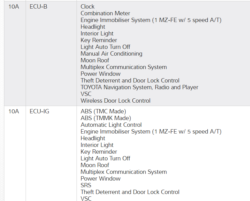

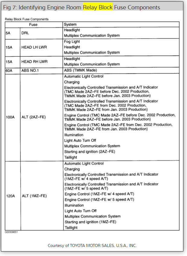

Hi meltoff,

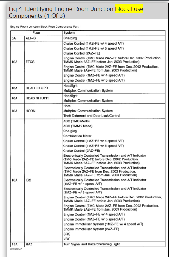

There are three fuses that run the system we need to check but it sounds like the BCM is out but to be sure here is a guide to show you how to check for power and the door lock wiring diagrams so you can see what to test and how the system works along with the fuse locations below.
Here is how you change out the BCM is it tests bad. You will need to have it programmed before it gets installed. Check out the diagrams (Below). Please let us know what you find. We are interested to see what it is.

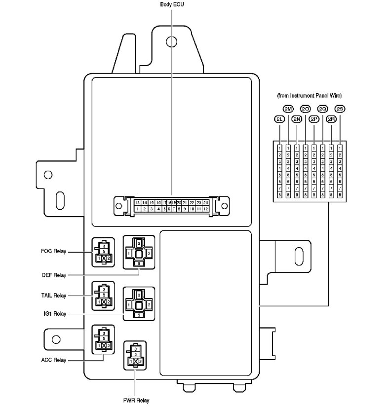

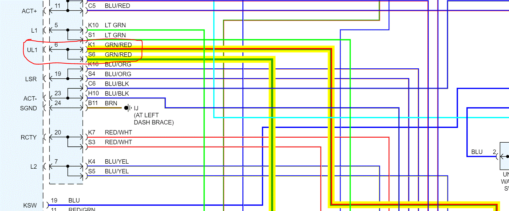

Hi Team, I am looking for some help. I have the car listed above LE model. When I click lock using remote or driver seat master switch all doors get locked but when I click on unlock they don't unlock. I physically need to get into the car from driver side and unlock all the doors and then all the doors will get opened. I don't have much knowledge but I can learn.
Dec 17, 2020 at 12:11 PM (Merged)
  • 110,193 POSTS

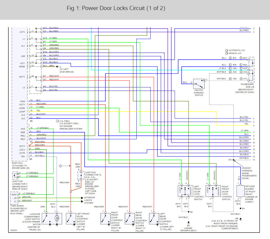

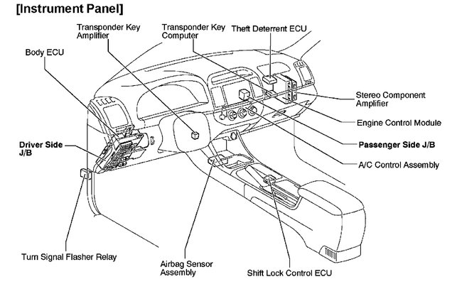

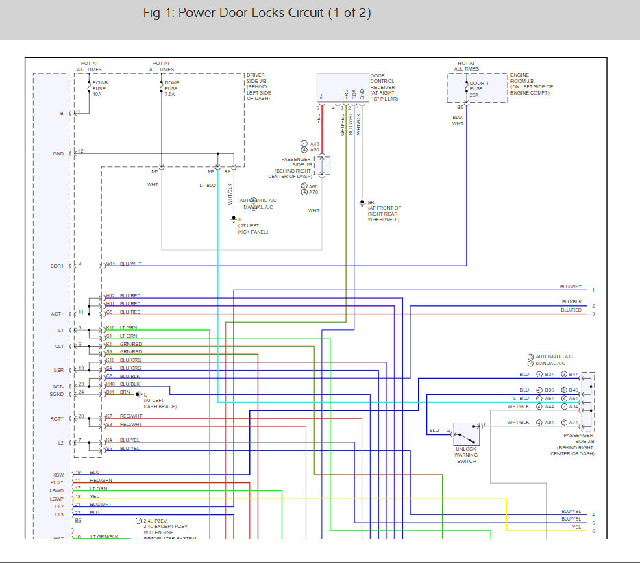

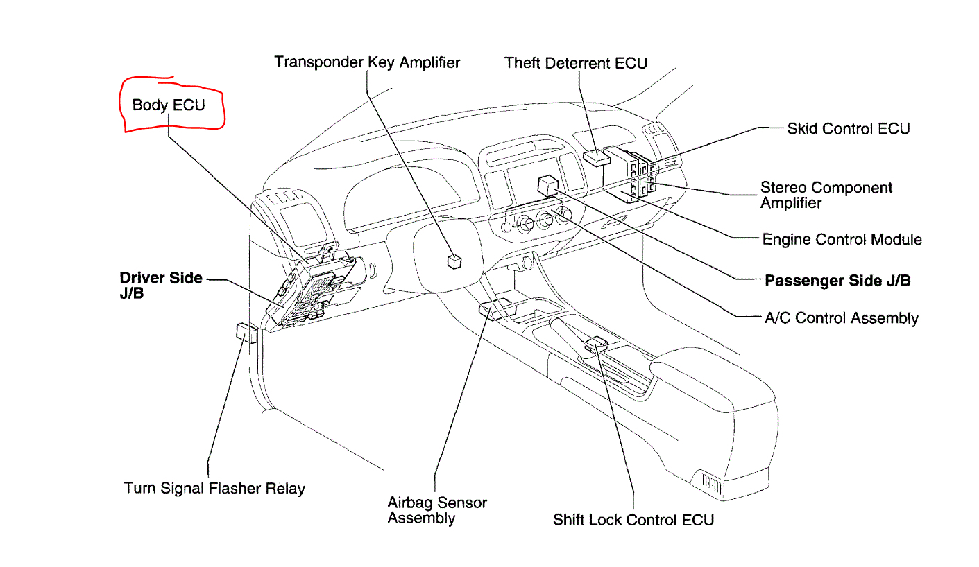

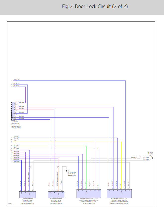

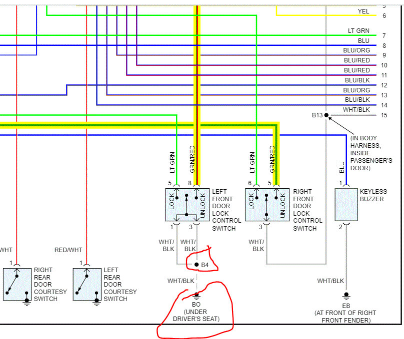

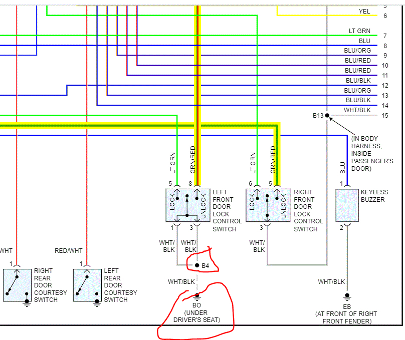

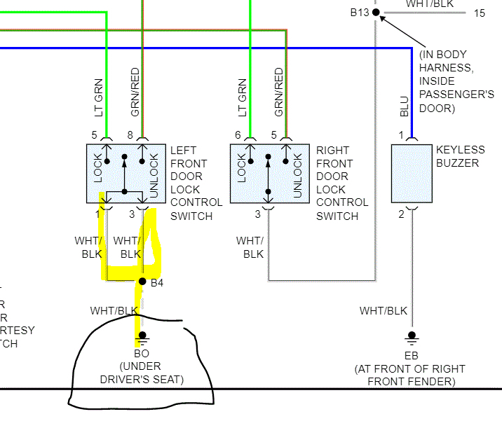

This is likely an issue with the wiring at the body control module. I will try to explain how it works. When you press lock, power flows one direction causing the actuators to react in a specific direction. When you press unlock, power flows in a different direction causing the opposite reaction by the actuator.

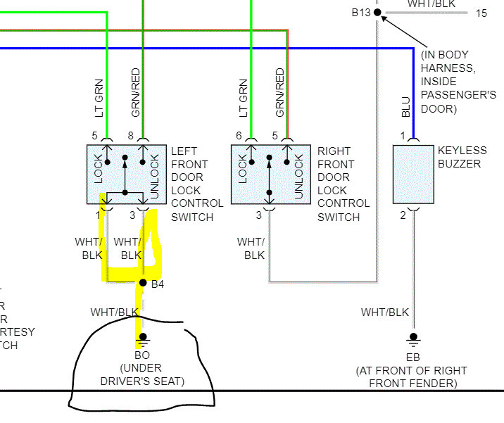

Now, if you look at the attached pics, I highlighted the wires that are responsible for unlocking the doors. They go from the switches to the body control module (pic 1). What needs to be done is to first check the connection at the BCM and make sure it is not loose or corroded where the plug attaches to it.
Next, see if there is power being sent to the switch via the wires highlighted. If there is power, then the ground, which has a splice in it, needs checked. Note that the ground is for both lock and unlock, but two wires go to one ground. They are spliced together. There is a chance that the unlock ground has failed but the lock ground is still good. (pic 2)
I know this sounds confusing, but let me know if you have questions or need help.

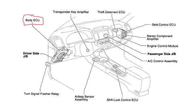

You asked me to check connection... can you guide where is the connection? I referred to manual but couldn’t find it.

How to validate the unlock ground is not working?

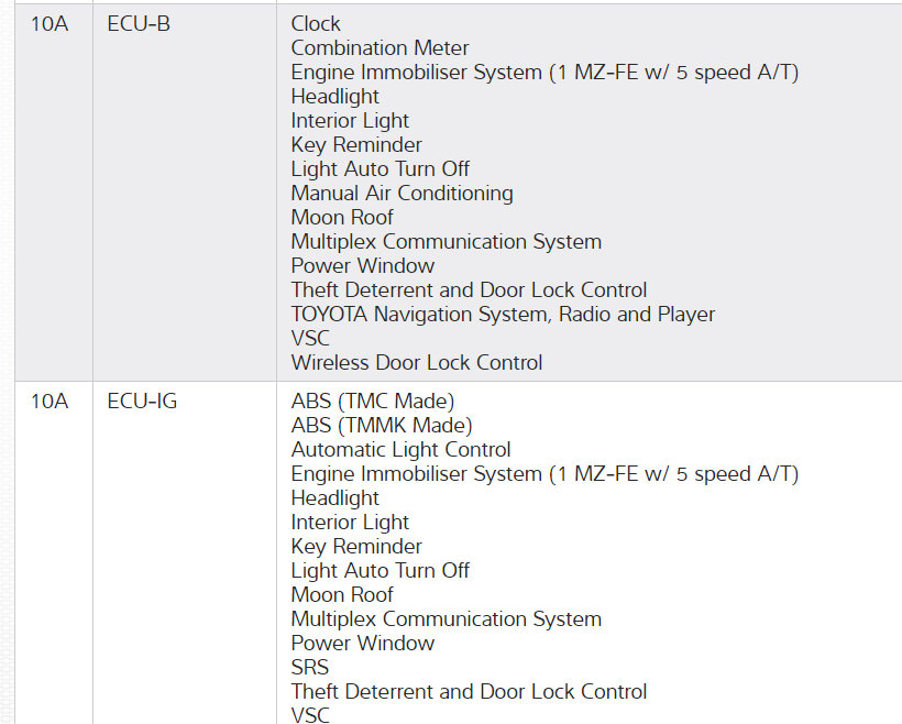

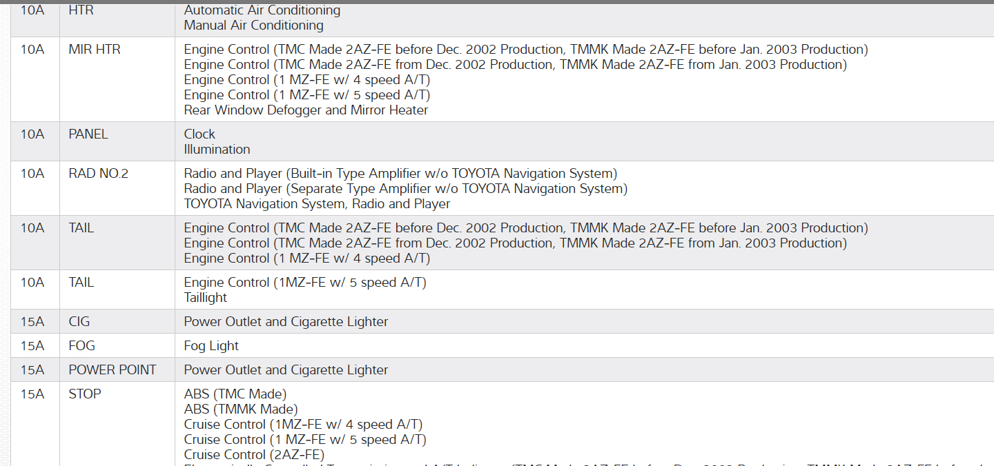

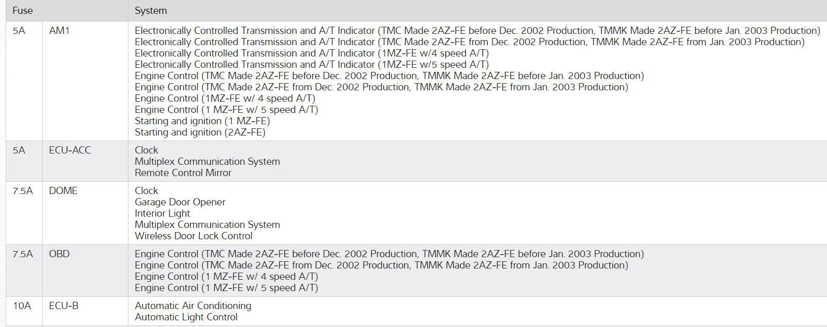

FYI, I checked all the fuses related to car automatic unlock and all looking good. I used test light to validate fuse.

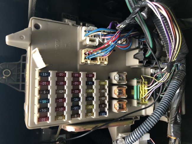

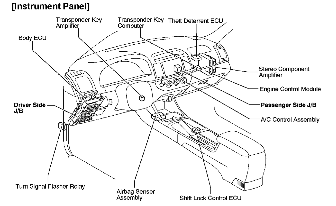

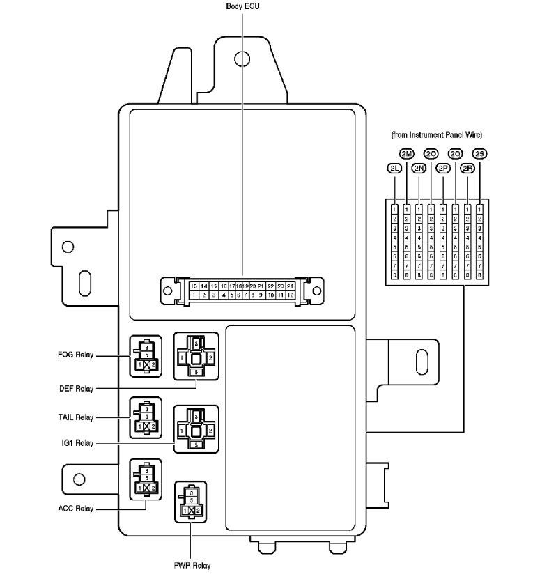

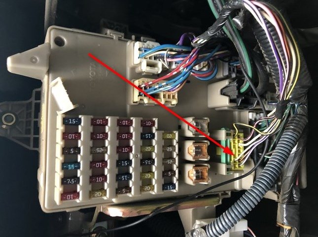

The body control module is located under the dash to the left of the steering column. Take a look at pic 1. Remember, before disconnecting or reconnecting the BCM, you should have the battery disconnected.
As far as testing for ground, simply place your multi meter on the ohms setting. With the battery disconnected, check to see if there is continuity between the black and white wires on the switch and a known good body ground point.
Please feel free to let me know if you have other questions.

I removed dash... I have multi-meter.. can you tell me how I need test?

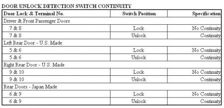

KHLOW2008
  • 41,814 POSTS

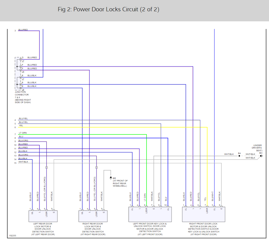

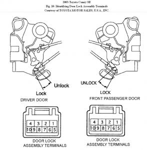

Hi Norton72, Symptoms indicates the door lock motor ( actuator ) is malfunctioning and it could be the wirings or the motor itself. Here are the test you can carry out. POWER DOOR LOCK MOTOR 1.Remove door panel for access to door lock motor assembly. Disconnect 10-pin electrical harness connector from door lock assembly. 2.Using jumper wires, apply battery voltage and ground to specified terminals on door lock assembly and check that door lock motor moves door lock link to UNLOCK position. Reverse jumper wires so polarity is reversed and check that door lock motor moves door lock link to LOCK position. See Fig. 10 . Replace door lock assembly if operation is not as specified.
https://images.2carpros.com/forum/automotive_pictures/192750_DoorLock03CamryFig10_1.jpg
https://images.2carpros.com/forum/automotive_pictures/192750_DoorLock03CamryFig10a_1.jpg

HAR
  • 11 POSTS
Connection attached.

You are simply checking to see if there is continuity to ground via the white wires with a black tracer. Note that the white wires with the black tracers goes between the switch and a body ground. See attached pic.

KHLOW2008
  • 41,814 POSTS
All door lock motors are in parallel so if any stops working, it would not affect others.

I removed the battery connection. I tested red probe in switch and black to the body of the car but I didn't see any reading in the multi-meter. Do I need to remove the driver seat and check the other end of the wire?

If you are checking the white/black wire to ground, yes. If there is no continuity to ground, then the ground source needs checked.

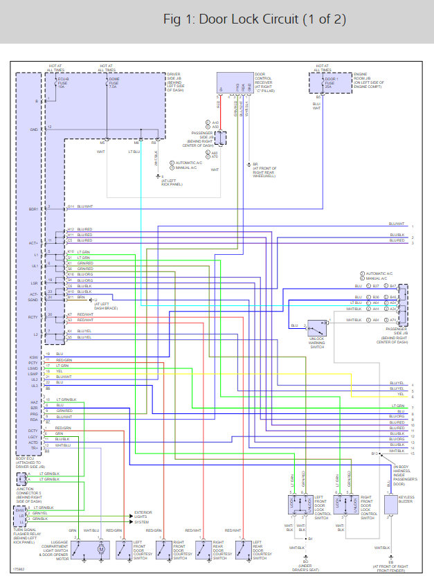

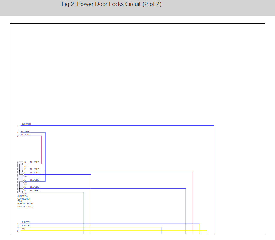

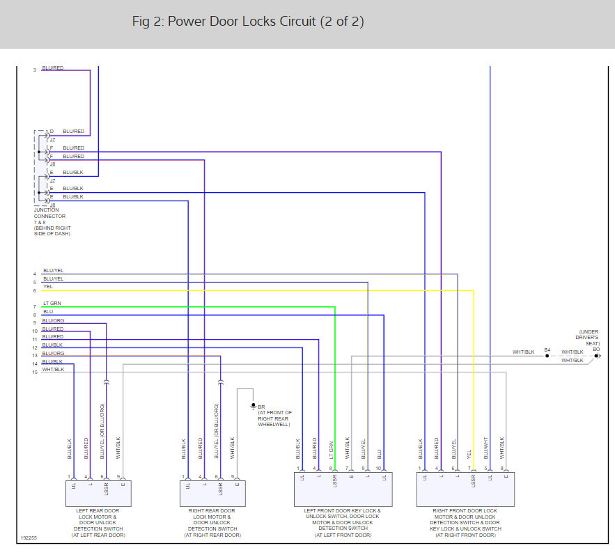

The BCM runs the door locks and I have seen problems with the BCM in these cars. But to be sure here is a guide to see where you are losing power at.
Here are the door lock wiring diagrams see when signal is lost.

Can you please refer me to which white wire I need to check from the picture I have attached in past?

Thanks for the diagrams I tested and found the BCM to be bad I got a used one for 150.00 and everything works great thanks for the help.

The ground is at the switch. It isn't in the pic you attached.

The pic attached was Body ECU. Are you saying the white wire is not in the ECU pic I attached earlier (attached on July 2nd)?

In the post right after you sent the pic, I indicated that and attached a pic of the schematic.

I added an arrow... are you referring me to check this end (first end of the white wire) with the under-seat end (second end of the white wire)?

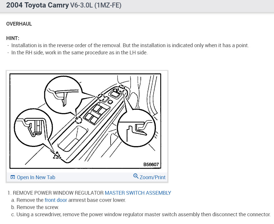

This sounds like the master door lock switch module is going out. I would try a used one to save money. here is how it is changed out in the diagrams below.

If that is white with a black tracer going from the door to ground under the seat, yes.
Let me know what you find.

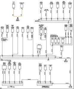

Hello !! well last question: do you have installed an aftermarket alarm, stock or none.? How About an keyless entry system? Well.. could be something as simple as a faulty 'lock switch" that actuates randomly with a vibration.. start removing the main lock switch from the connector and drive your car as usual and "see" if the problem persist if so, check the wiring that goes to the lock relay. Here the schematic of the lock system:
https://images.2carpros.com/forum/automotive_pictures/576_camry_lock_sys_1.jpg
Good Luck! BTW Tahnks for your donation !!

I am unable to read the schematic because it is not clear. Can you repost in a clearer format? Thanks.
Dec 17, 2020 at 12:12 PM (Merged)
FISHERMAN
  • 937 POSTS
[quote:b7c9ab4030="ahrgee"]I am unable to read the schematic because it is not clear. Can you repost in a clearer format? Thanks.[/quote:b7c9ab4030]
Hello !!
Well we have a limited weight on the pictures, Even using the whole screen wont read good...
sorry about that !
but, have you try the switch or check the sensitivity of the remote?
Let us Know!
