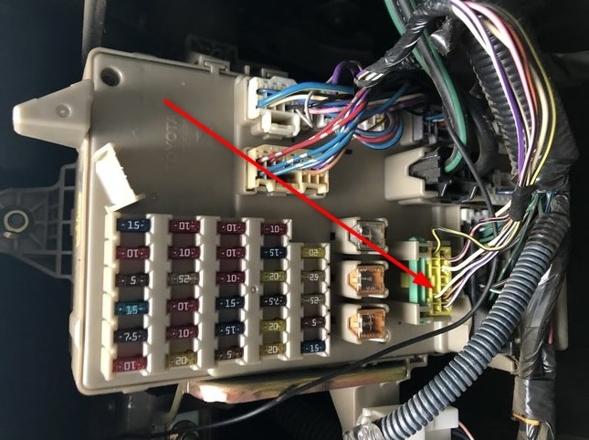

If all of the door actuators went out at the same time, I would replace the BCM. Please let us know how it goes.
Jun 25, 2023 at 11:46 AM
VISHWA
Thank you so much for responding Ken. I appreciate your help here. Except driver side door, all other passengers' doors (including right side front door) are not getting unlocked either with fob or main side switch from driver door. Can you please point me where I can buy BCM for Camry 2011 and do I need to take help of mechanic or is it DIY? After getting a new one, do we need to program it? I heard BCM is very costly. again, thanks a ton for helping me here.
Jun 25, 2023 at 4:26 PM
  • 54,494 POSTS
They are not too bad money wise, just search eBay or google to find a preprogrammed unit and you should be all set. It is a DIY project for sure.
Jun 26, 2023 at 12:00 PM

CHRISTOPHER ELLIS
I had the same problem as that described by the OP. 2011 Toyota Camry has three doors that failed to unlock when auto unlocking but all four locked when auto locking. The probability of three doors simultaneously having the same problem ruled out the actuators. I tested all the fuses. The responses here were a rare resource and aided me in thinking about the BCM, which before this I had no clue what this was. One mysterious difference for my Camry compared to some other models is that perhaps the BCM and the Interior Fuse Box on the driver's side has an integrated BCM? That box was replaced and the problem was fixed. Thank you to all who contributed.
