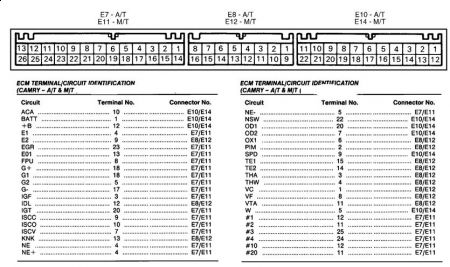

The connectors are definately for your vehicle ... it's for M/T calif as well ... I said i thought the ECM was not working correctly .. try swapping with the other you have !! and do the test's again ?

Hi Dave: The other computer didn't show anything on #3 or #20 pin either. I hate to spend $400.00 on a new computer but I guess that's the only option in order to really know for sure if the old computers are bad. Have you had any experience with factory reconditioned computers?

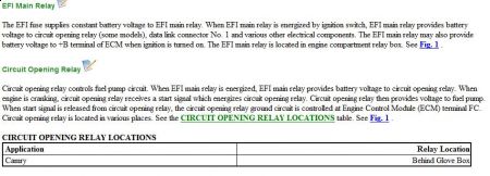

Dave: Got a question. If my fuel pump isn't coming on when I crank the engine will that keep the computer from sending a signal to the igniter and coil to fire to the plugs?

https://www.2carpros.com/forum/automotive_pictures/266999_cam_15.jpg
