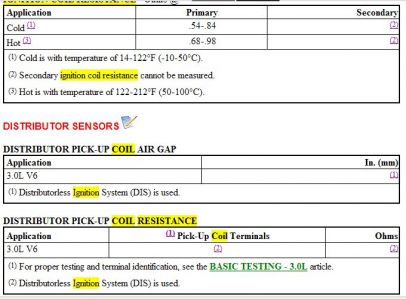

Hi Dave & James : I've been busy building my grandsons a playhouse and haven't been doing much on the Camry but it's time to get back to trying to find out why it won't start. I bought a new coil and put it in and then I checked it for resistance across the + and - poles ( the primary circuit) and it showed no resistance. The secondary circuit showed 13.2 olms resistance. What resistance reading should it have? Will it work with zero resistance across the primary circuit?

Mike, this should help.
https://www.2carpros.com/forum/automotive_pictures/248092_95_toyota_camry_1.jpg

Thanks James : the resistance was 8.0. So the coils good.

Do you mean-.80 or 8.0?
Monday, April 13th, 2009 AT 5:36 PM
MBENCO
  • 184 POSTS
Yes it's.80 sorry about that.
