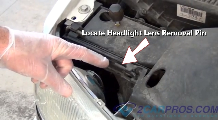

Locate the release pin or screws which mounts the headlight lens. Pull forward and upward on the pin to release, or remove mounting screws or clips.
locate headlight release

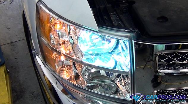

Match the old bulb to the new unit confirming the electrical connector configuration along with the mounting plate of the bulb. Clean the headlight lens free from debris to help maintain the seal of the bulb to the lens, this will help keep moisture out. There is an alignment notch or tab that must be recognized when reinstalling the new bulb. If the bulb is installed incorrectly the light beam will be off (high, low, left or right). Reconnect the electrical connector ensuing an audible click which confirms the connection of the connector while sealing the bulb from moisture. Reassemble the lens or any other obstructions to complete the job. Turn the headlight on to check your work, observe the newly replaced headlight bulb to ensure proper operation.
