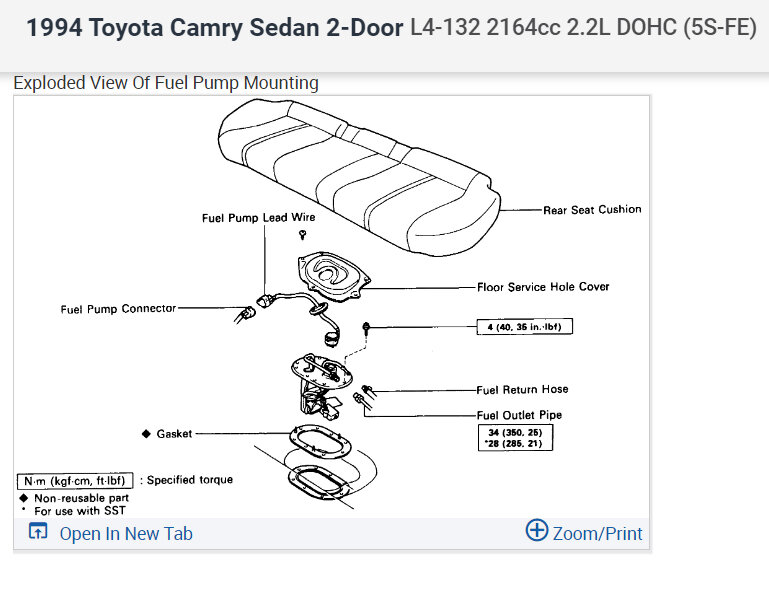

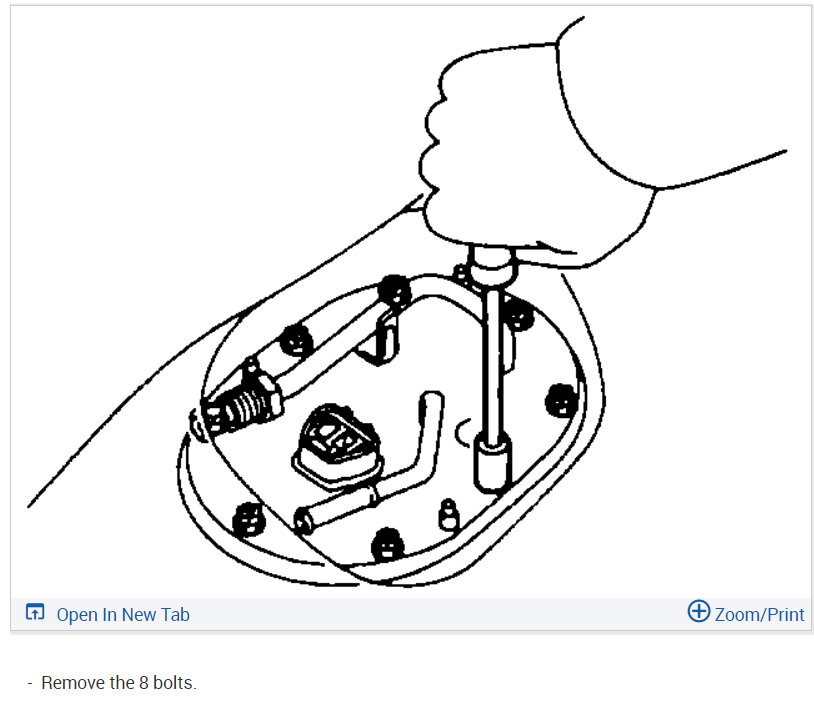

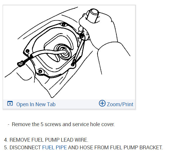

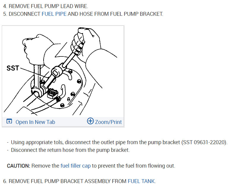

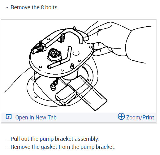

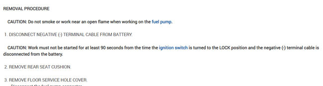

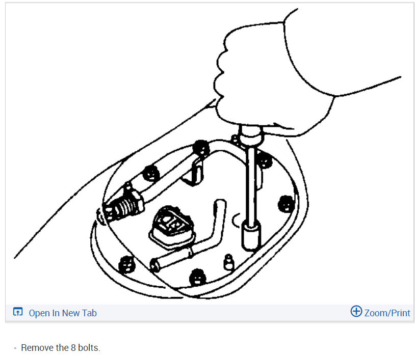

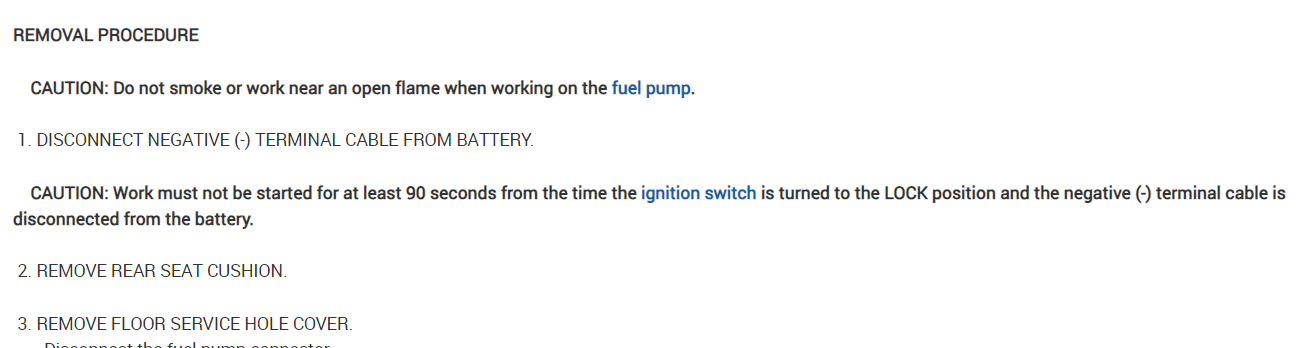

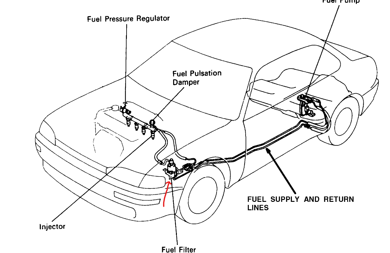

This is typical when the fuel pump is starting to go out, here is how to change it out and I would swap out the fuel filter as well. Check out the images (below). Please let us know what happens.
