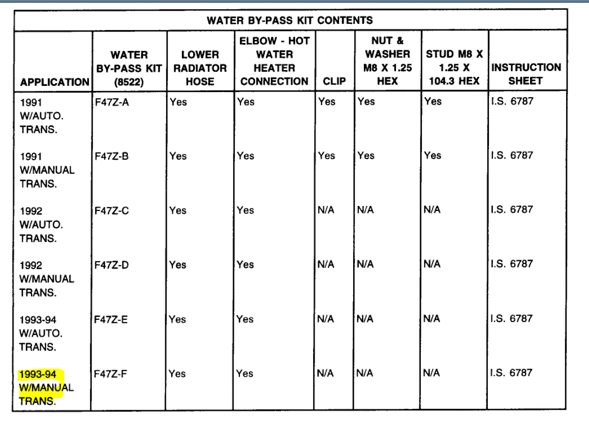

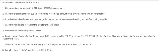

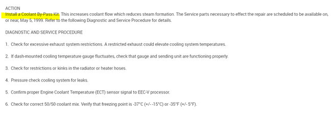

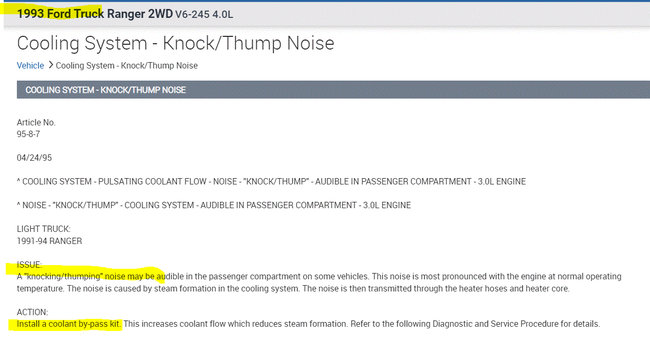

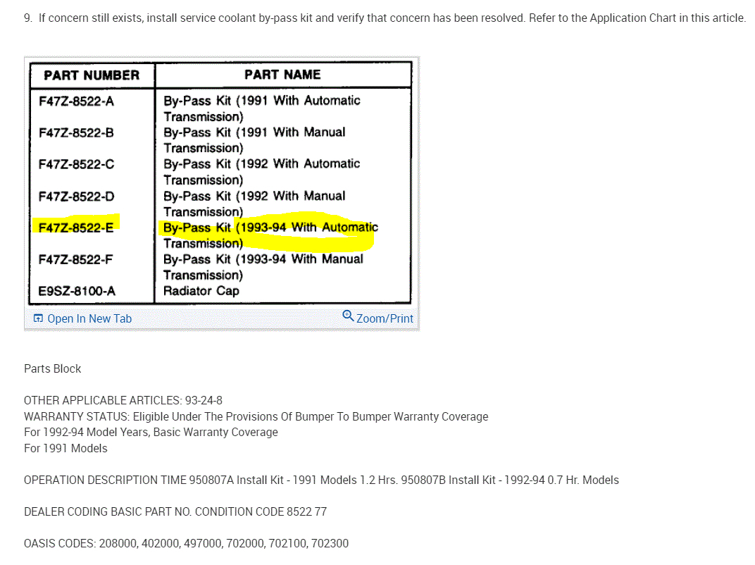

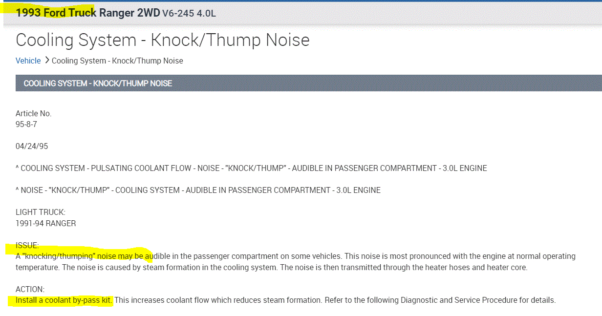

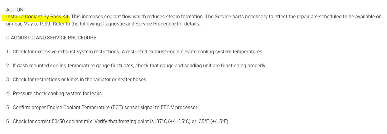

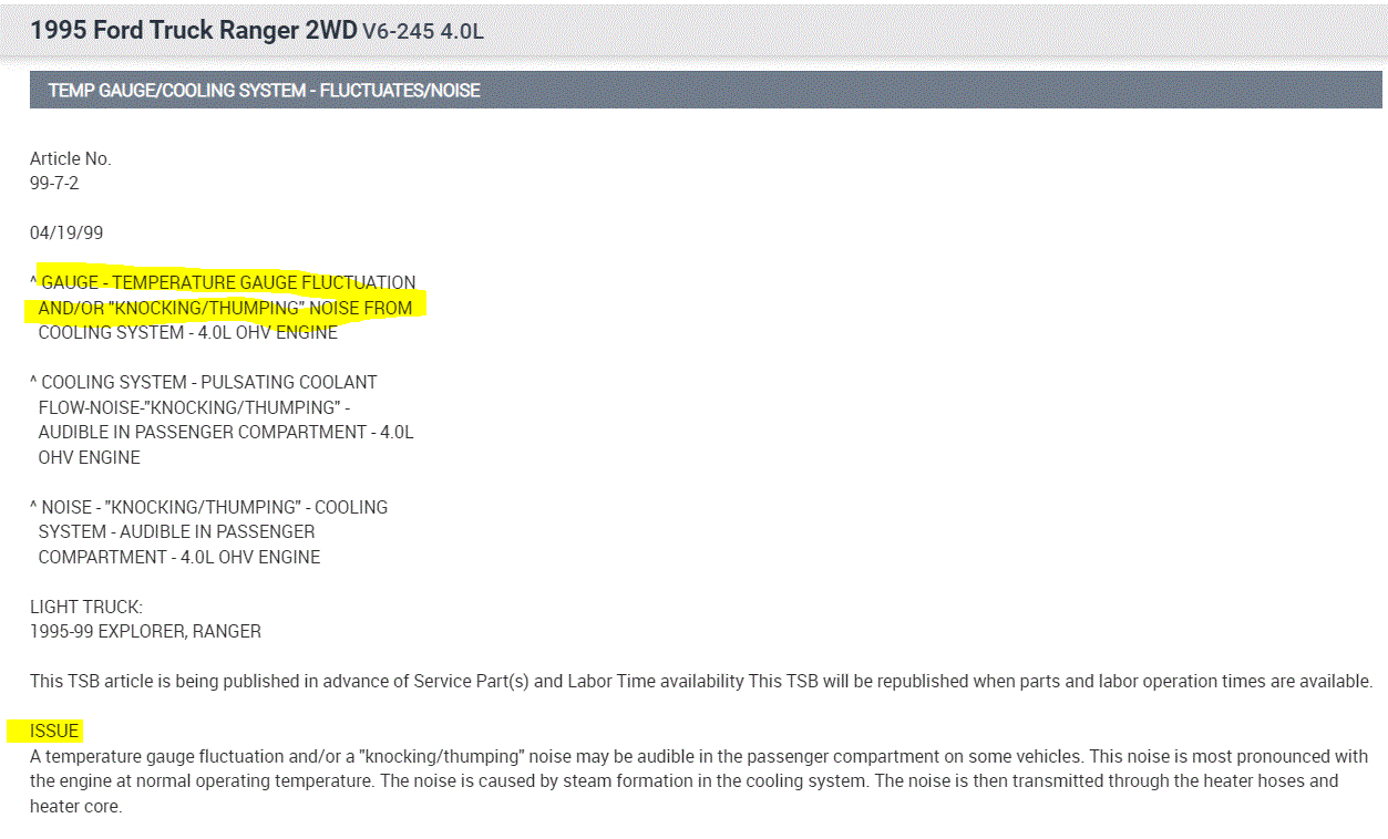

That helped. I think I found the issue. I was able to dig up an old technical service bulletin related to a temperature gauge/noise. I attached it below. It appears there was a coolant bypass kit that needed to be installed to prevent steam from forming, restricting coolant flow, and then making a noise.
Take a look below at the TSB and let me know your thoughts.

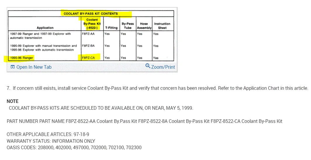

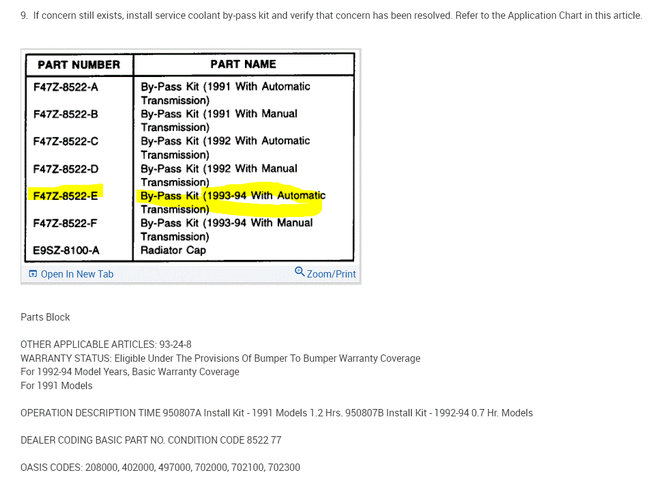

No problem. It appears Ford had this same issue for several years. It's the same with 1993, just a different part number.

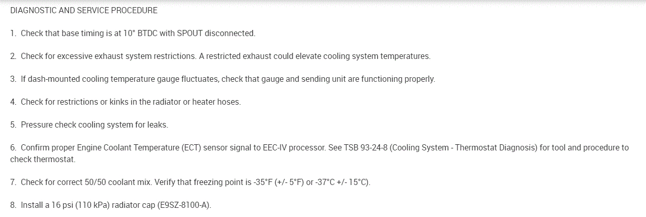

I did notice that it indicates trying a 16 PSI radiator cap first. If that doesn't eliminate the issue, then the kit is needed.
I attached the TSB for a 1993 below and highlighted the part number. The problem is trying to find one after all these years.
Also, make sure the coolant is mixed 50/50. IF there is too much water, it can cause this to happen as well.
Now for the part, here is what I remember (it's been a while). The kit consisted of a lower radiator hose with a molded-in tee and a section of heater hose that goes up to a new fitting that screws into the thermostat housing where the temperature sending unit is mounted. The temp sending unit is relocated to another part of this new tee in the hose.
I tried for a long time to find a pic for you with no success. Here is the thing. According to the TSB it is caused by steam and we know that it shouldn't even exist. So, make sure the system is flushed, the coolant is a 50/50 mix, get a thermostat that opens at 180 F rather than the OEM 195 F, and make sure you have a good 16 psi rad cap. Hopefully, that will take care of the issue. If it doesn't, we need to figure out a way to fabricate the "kit".
