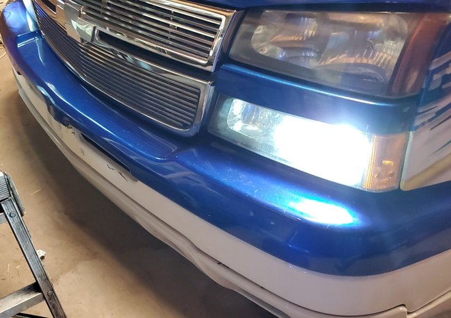

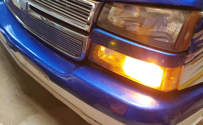

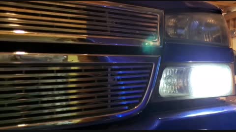

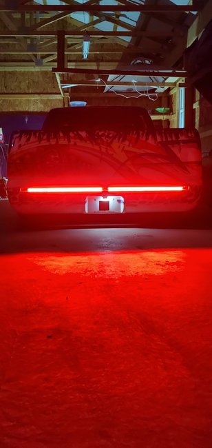

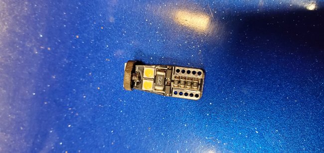

Not sure how this is different than what I have. Please remember this is a custom truck and it has a newer front end on it. It's been converted to a cat eye Silverado HD (2005 ish. I included a couple pic's of what I have so you can try to get an idea of what I'm doing. Yellow is turn signal, white is parking light. Picture of rear is taillights. Led bulb is the current corner bulbs I'm using. For some reason I can't get the videos to upload as a video.

Does that bulb have a built-in resister? It looks like it may. If not, the only other thing I can think of is to switch them with ones like I sent you. There is a place online that may help with this. It's called HIDnation. Have you ever checked their site?

It does not have a built-in resistor. I have seen their website before and I also checked it when you sent me the link. It doesn't appear that the bulb they show is anything special, if anything maybe a little dated (I have ran similar before). I may just call it quits and either leave them out and see if it passes inspection, maybe try something else, or just go back to factory.
