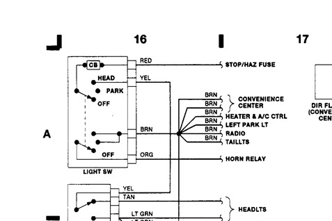

heres where im at i turned the switch on got power at park lamp fuse but no power at tail lights tailingts blink and the brak light works but no pwer for just lights let em kno what you think thanks

Check for voltage on that wire at the headlamp switch, with the switch activated, if there is voltage, you have a wiring circuit problem. If no voltage, could be the lite switch, itself, or voltage to the lite switch.

I checked the red an orange have power goin to the switch an yellow has power wen it's flipped on my lights have been coming on with a delay for like a week until now when the parking lights an taillight don't work soo do you think its the switch jus don't wanna spend 20 bucks an still no have lights

The voltage I got at the yellow wire was 14.3 soo time to start tracing wires let me kno thanks for your help

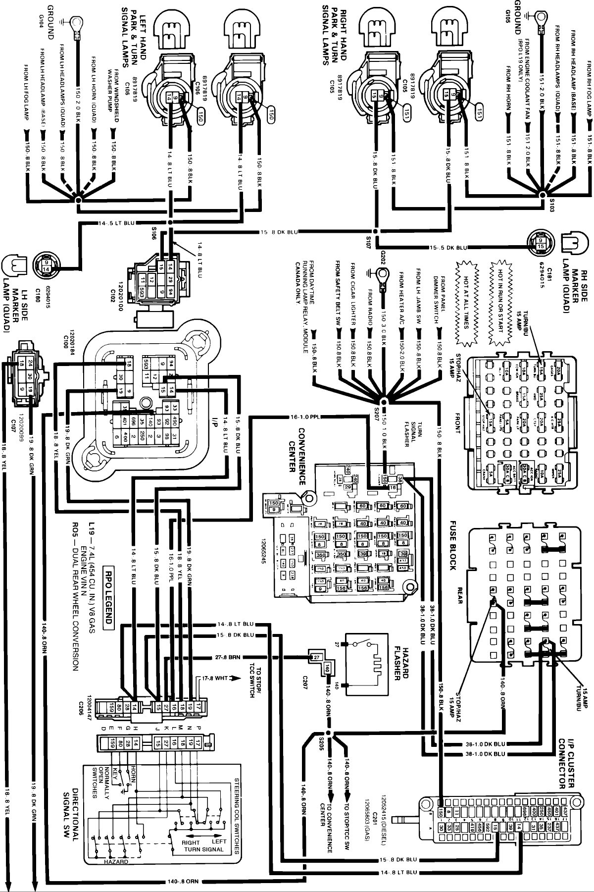

My tail lights dont work parking lights dont work and my dash lights dont work headlights work and my interrior lights work brake lights and signals all work all the fuses looked good but th fuse labeled PANEL LPS is dead and with no power going to it please let me know where to go from here thanks
I checked the head light switch theres power on red an orange wire then when the switch is fliped on the yellow wire has power when the switc is theres power at parking lamp fuss but i got no power at tail lighs could it be a relay please let me know

I have a quick question the brown wire that goes to my tail lights has no power at my head light switch when its turned on so does that mean its gotta be dead between there and the fuse box and if so how could i fix it let me know thanks a lot

start checking the brown wire on frame to the tailights if you get poer then none then it's shorted wire and needs repair.

I looked at my wiring again. It appears the voltage from the panel lamps fuse goes to dimmer switch and then fromn there. Forget about the horn relay.

if you have power to the headlight switch but not out the brown wire to tailights then it's probably teh headlight ssitch is bad orthe plug isn't in all the way or the headlight switch isn't gorunded correctly for tailights to work or if its' been recently changed it may be the wrong one.

I was wondering is there any parking lamp relays that could have blown I kno there's 2 relays above the fusebox and 2 inside the fuse box do any of them control the parking lights thanks in advance for your help

I just figure It might be the switch cause there's power to the headlight switch but no power at the brown tail light wire at the switch

I replaced the headlight switch and all the problems have been fixed thanks for all the help
