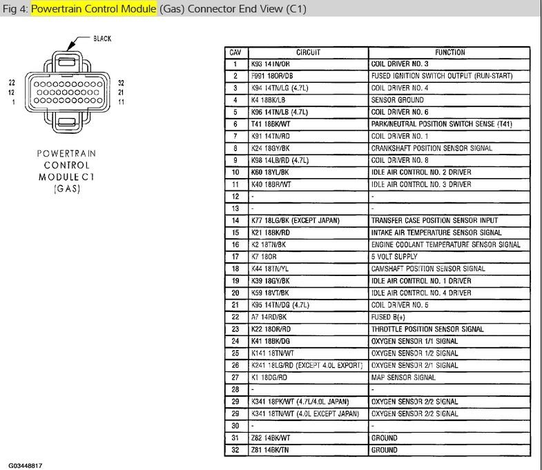

Ok. Can someone grab that pinout/wiring diagram for me please? I can't get into alldata or prodemand at the moment. It's a 2002 Jeep grand Cherokee 4.0L with part time 4x4
Sunday, August 30th, 2020 AT 10:36 AM
94 TRANSAM
  • 680 POSTS
Here ya go.
