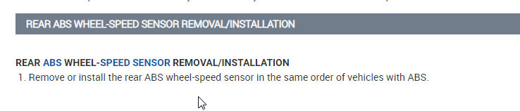

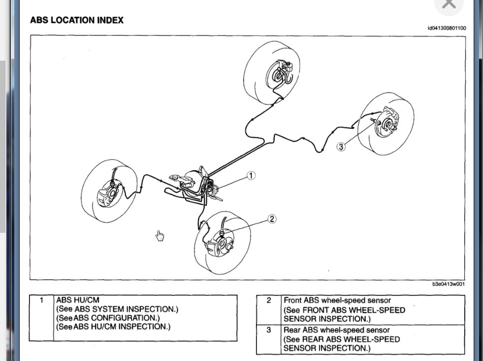

Below you will find the process from the manual on how to replace the rear sensors. Let me know what questions you have. Thanks
