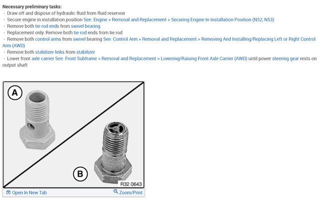

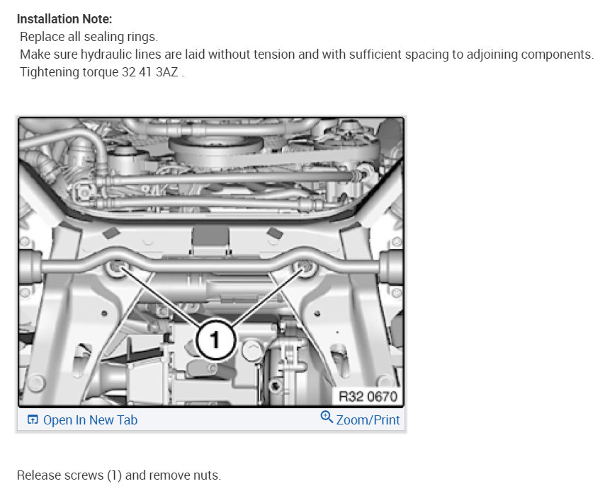

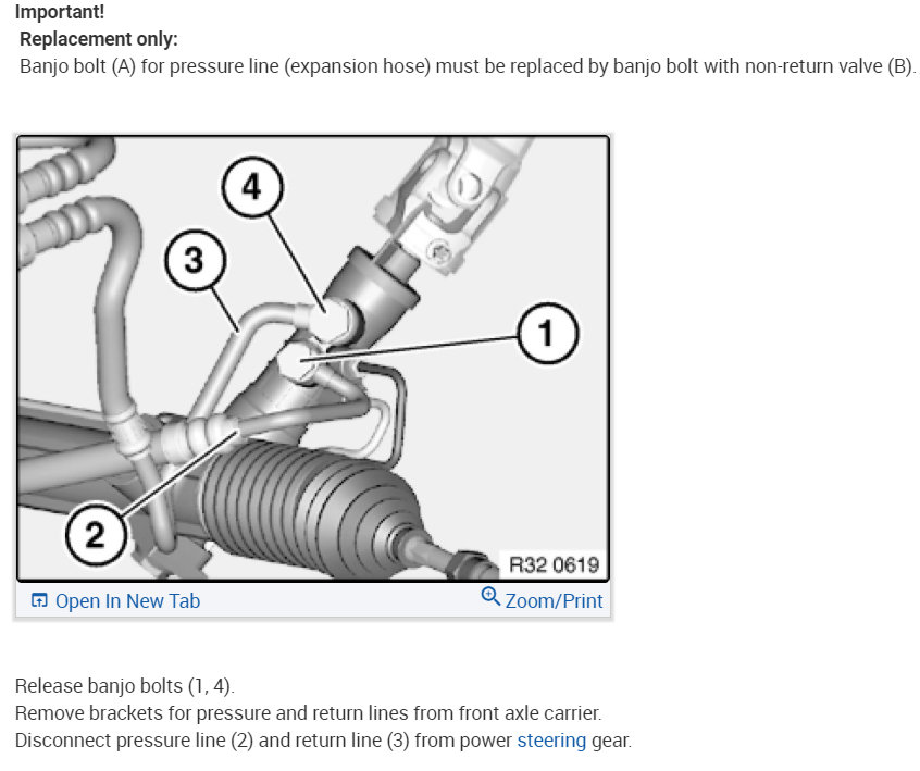

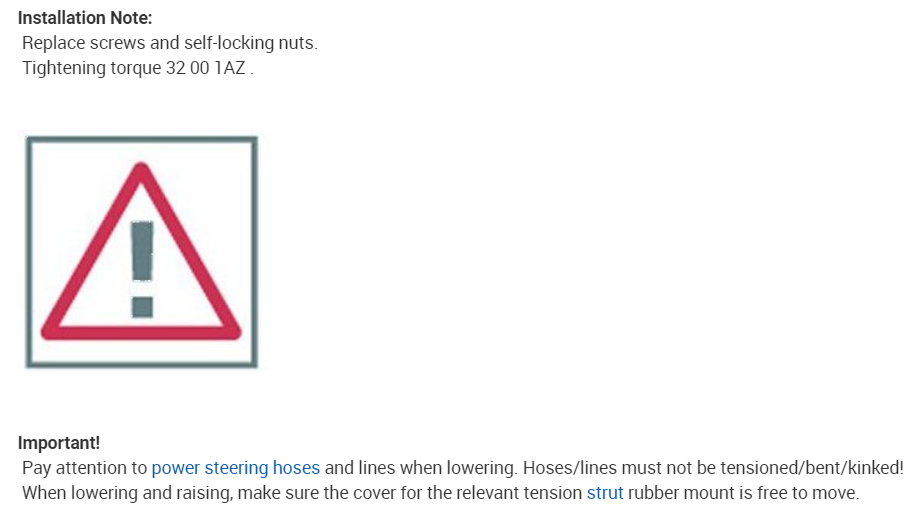

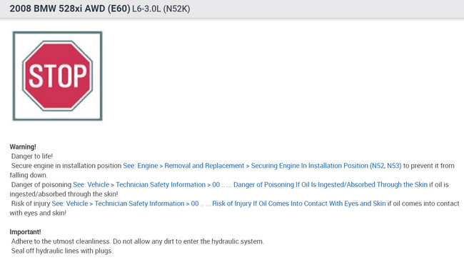

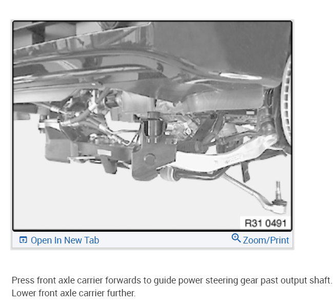

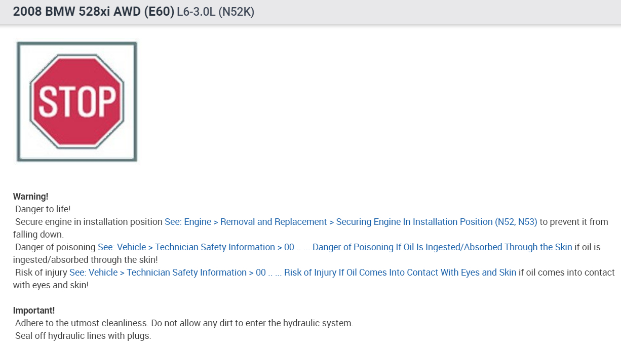

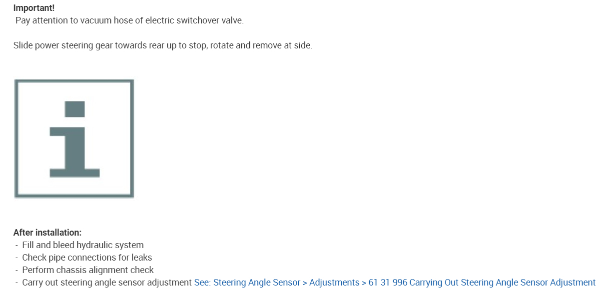

If the alignment does not fix it it sounds like the rack and pinion is going out. Here is information (below) on how to replace it, cost and labor time.
Parts Information OEM Part Price
Steering Gear
4 - Steering Gear 32106780124 $2646.65
Complete Assembly With Transfer Of Parts B 6.2 hrs
Does Not Include: Wheel Alignment.

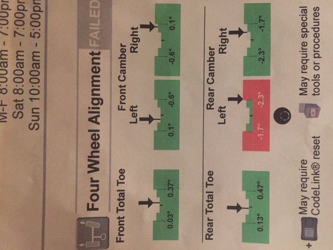

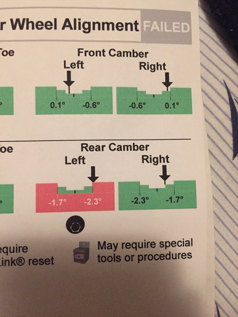

I went and got a wheel alignment and they said that the left rear camber needs to be adjusted but I have to go to the dealer to do so.
Monday, November 5th, 2018 AT 8:12 PM
JONNYB1963
  • 263 POSTS
So the front alignment was okay then? Just curious, what does it say about Caster? That part was cut off on the picture you attached.
If the caster turns out to be okay, then I would be inclined to agree with Ken in that you have something binding in the front end that is preventing the wheel returning to center by itself.

Here is the full picture:
-1
Tuesday, November 6th, 2018 AT 7:42 PM
STEVE W.
  • 15,671 POSTS
For poor return to center the caster would need to be way off. The wrong camber in the rear that picture shows would not cause it. However that reading suggests either worn bushings in the rear suspension or something was slightly bent.
